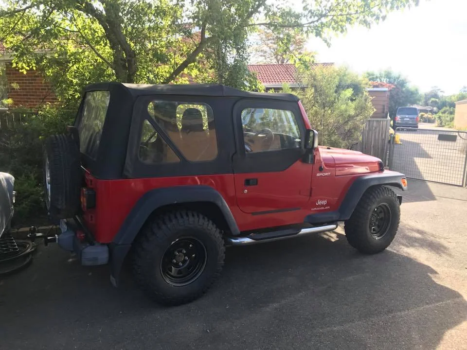

Took the Jeep over the pits for its inspection so I can transfer the ownership over.
Passed with flying colours.
Ordered some new wheels, They're coming from the US and the supplier only had 4 in stock. The manufacturer didn't have any stock, so I have to wait until they do a batch. I'm not expecting to see them until late this year or even early next year.
Changed the bumper bar over and got rid of the ugly chrome bar, sidesteps still pending.
I've been busy extending my garage so I can have a bit more room in there. Once it's done and I'm setup again I'll make up some caps to weld in to the ends of the bar.

After getting messed around with trying to get Chinese wheels out of the US, I managed to get some Taiwanese built wheels in the same spec.
The Jeep was in need of some new tyres, needing some work for 33s I bought some 31s to get me through for now.
Cooling system overhaul is next on the cards. It's running on the hot side of things and coming into summer I'd like to fix that ASAP.
