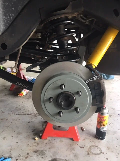

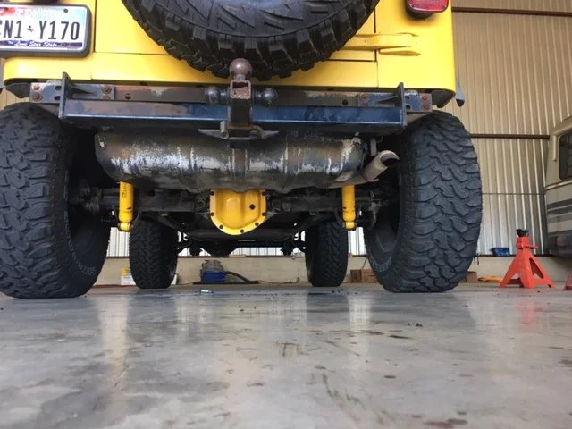

Ok got to spend some time pulling wrenches today finished up the rear end
Adj Control Arms uppers and lowers installed uppers trq to 55ftlbs lowers trq to 130 ftlbs
New Parking Brake shoes and hardware installed
Pinion Angle set
New Rotors installed
new disc brake pads installed calipers trq to 11 ftlbs
new sway bar and links installed
new axle seals and bearings complete retainer nuts trq to 45ftlbs
Diff oil changed Royal Purple 74/140
Diff Cover and Bolts Painted diff bolts trq to 30 ftlbs
New Coil Springs and Shocks installed
New Coil Spring Isolator pads installed
new energy suspension bump stops installed

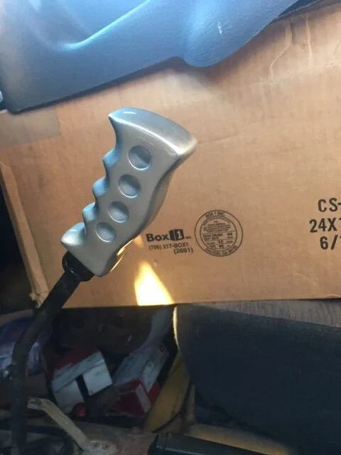

Well its X mas Day and I finally got the TJ back together today, installed the steinjager transfer case cable shifter and the adams front drive shaft pulled out the shop and got a few miles down the road and check engine light came on, engine started stuttering and jerking from 800 to 2000 rpm the code that flashed on was P 1391 looks like I am not finished yet and will be putting a crankshaft position sensor in tomorrow or friday or as soon as the mopar house gets one, Also the throw out bearing started making some noise on the way back to the shop

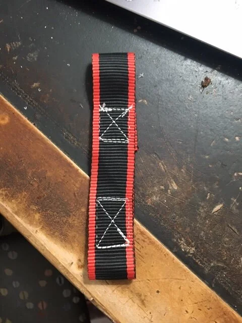

Ok Not much to report did get some new door limiting straps made them from old ratchet strap here is the practice one don't worry the ones I made were solid black but if someone had a red and black jeep the practice would be a nice touch
