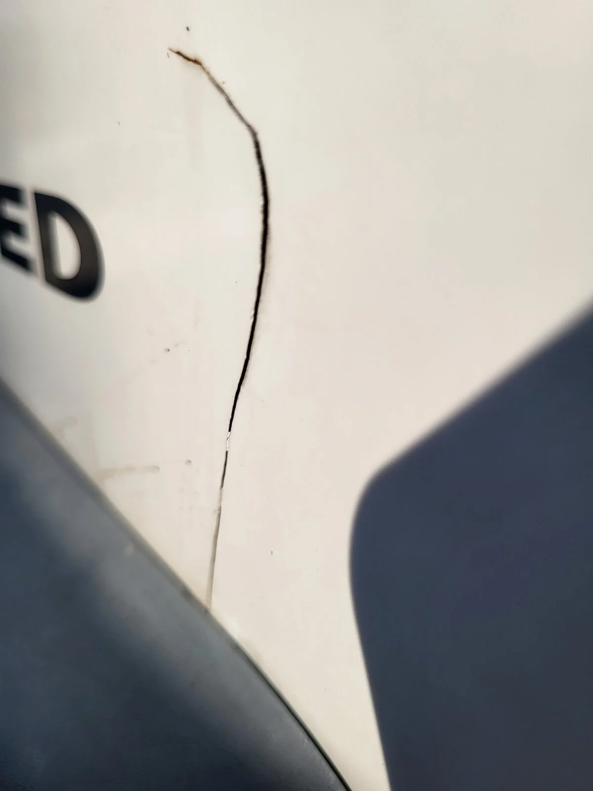

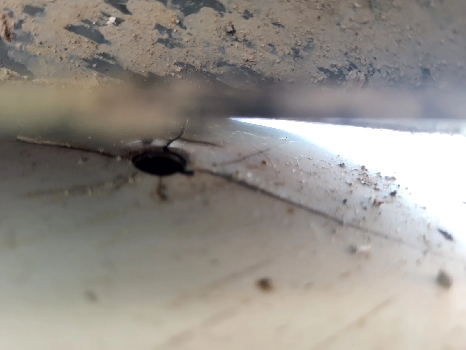

Have you inspected the large crack in the tub? Wonder if that’s bondo from prior rust repair.
I checked it out and the crack is coming up from one of the flare extension mounting holes that is missing a bolt. The paint chip has laid back down, I'm guessing due to temp/humidity swings. I'm going to pull the flares off this weekend and do a more in depth assessment of the damage.

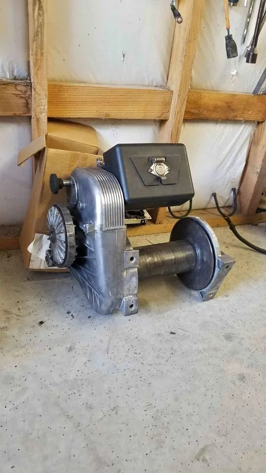

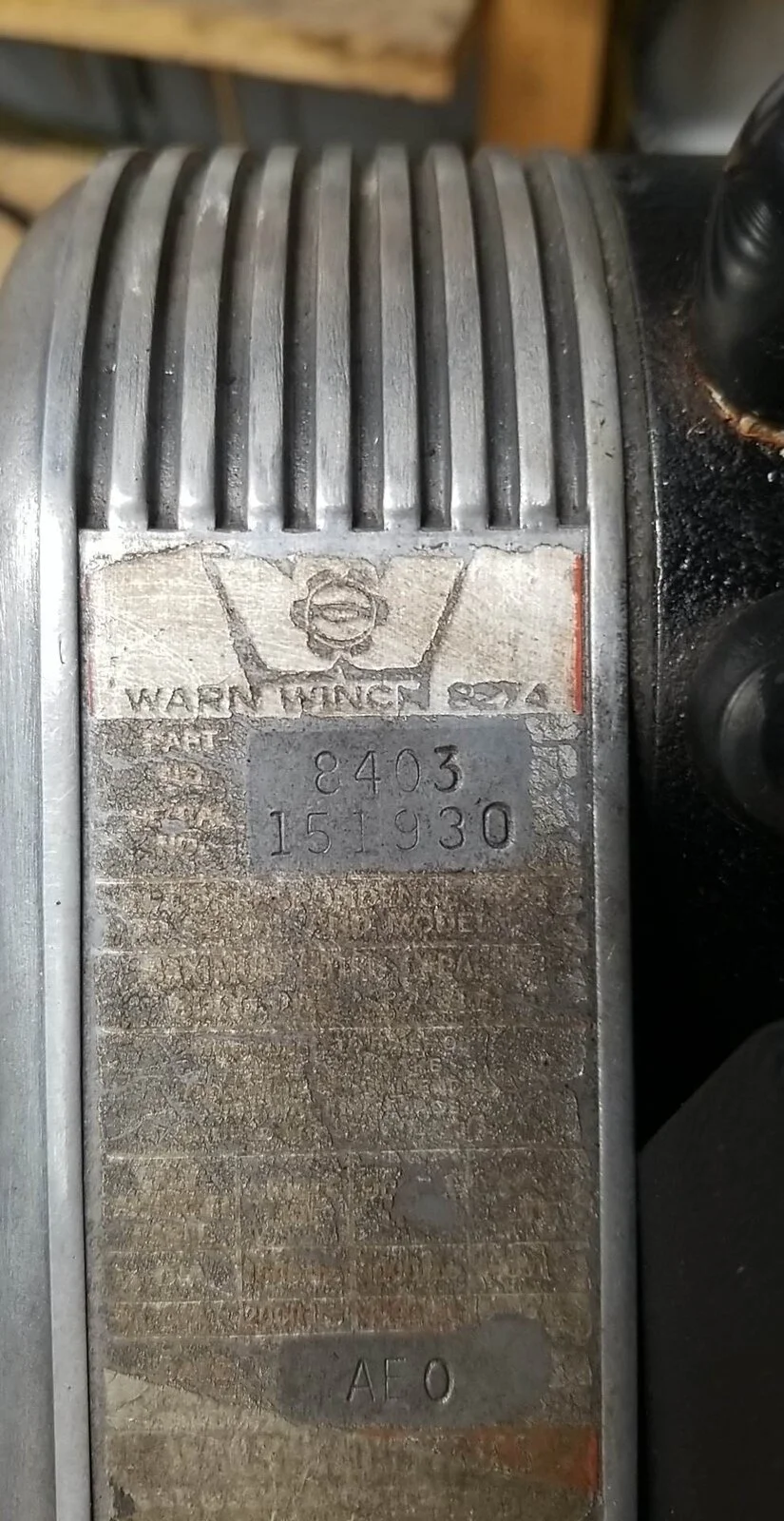

Got a line on a Warn 8274 with no cable and new wiring for $625. Sounds like a go to me? I've always wanted one and the price seems alright for what they fetch anymore.
Reactions: L J and Rickyd
So while I can appreciate that it has been cleaned up here is what I would check for:
Does it have the remote? If it does not it will cost you $130 or so for a retrofit plug and remote.
Does it run? Motors are not cheap if you are not planning for upgrading.
Does the brake work. You test this by holding the inner disc and rotating the outer back and forth. You should have about in inch of rotation and can see the cam pressing the plates together.
Does the clutch knob move freely. You should be able to push and pull it with just a small amount of effort.
I would use those tests to your advantage to negotiate on price. For me I would try to get it for under $500 if you can.

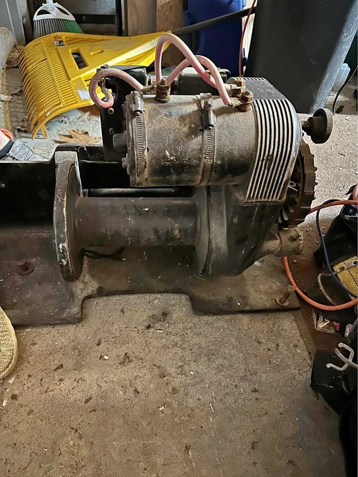

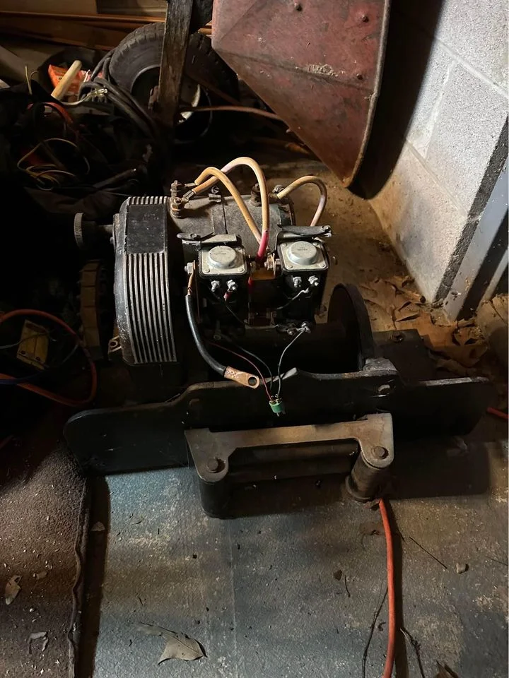

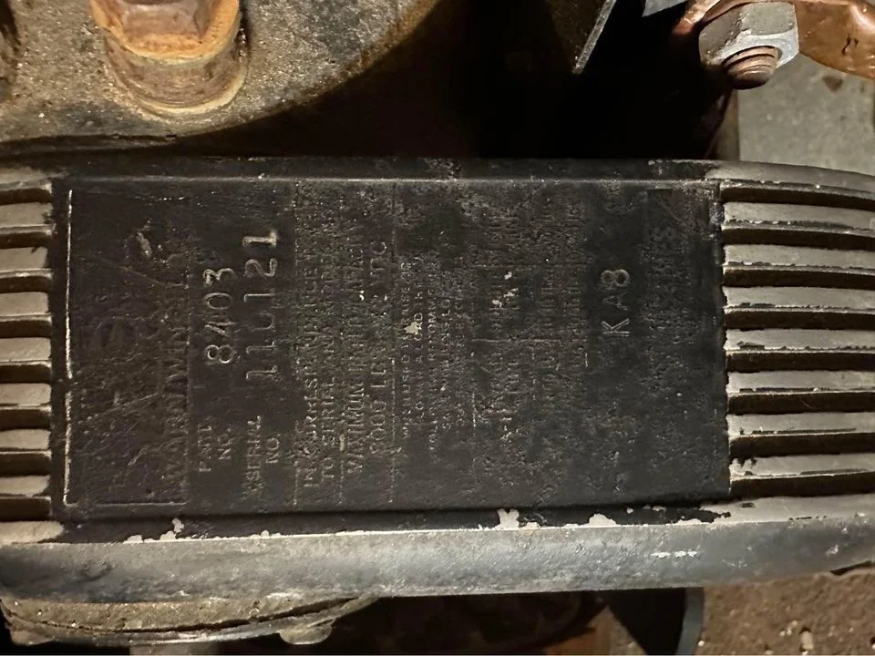

Also have this one that's a little bit of a drive. Needs some work, but asking $400 obo
Has remote and two extra "Cylla noids" :LOL:
Totally dig the winch plate with this one too.
Reactions: Danarch
If upgrades are part of the plan then spending less in the beginning is usually a good thing. That being said if you find an older 8274s with the metal control plug with the remote those pieces are worth some money to the right person doing a period correct restoration.
