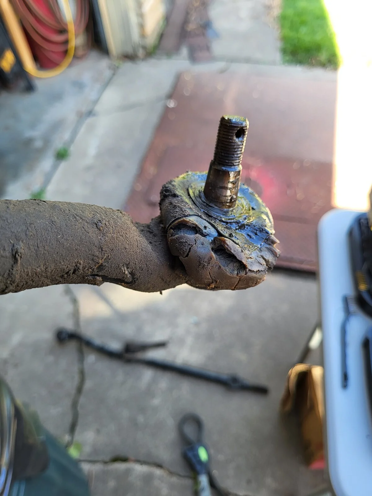

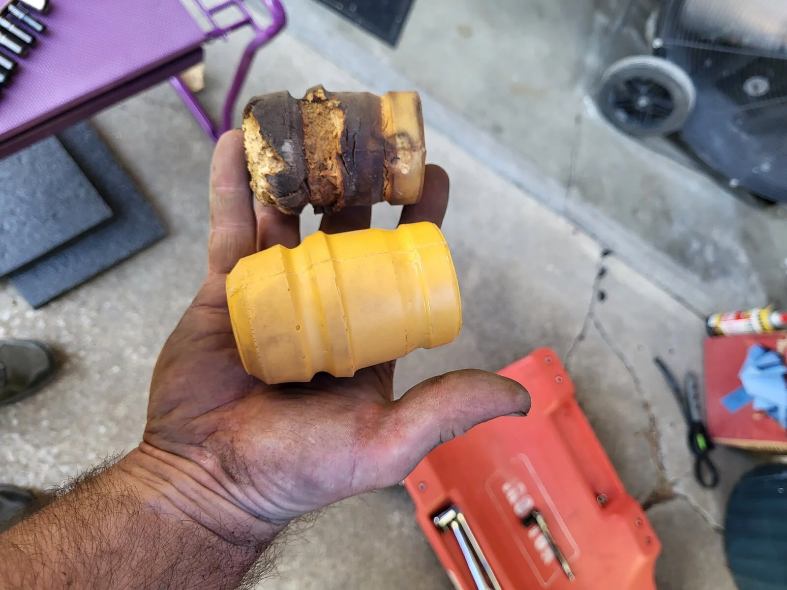

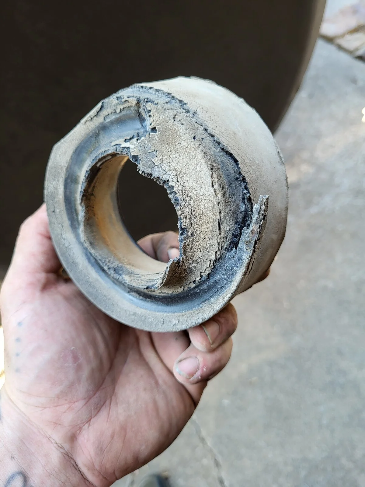

Yesterday was productive. Swapped out the track bar, tie rod and draglink. Then went to the rear and changed out the worn out spring spacers and bump stops.
Track bar was toasted.
As were the spacers and bump stops!

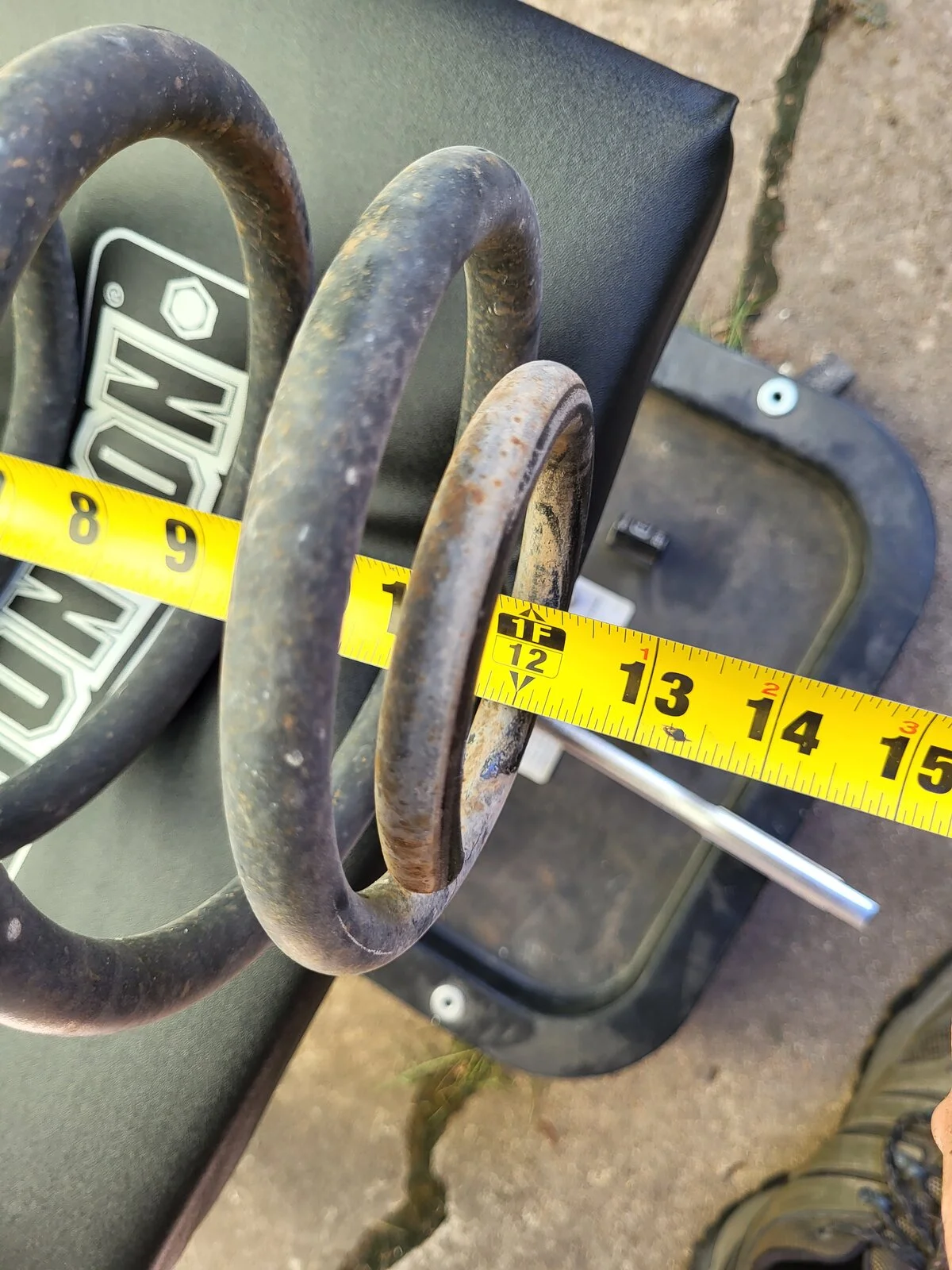

With the rear spring out, I got a solid measurement of free spring height and at 12.25", I'm thinking this is stock height, but maybe a greater spring rate resulting in less compression when installed?

Also, measuring before and after rear the spacer swap, I netted a ~1" increase in rear height. Starting to get a street rod look with that and the fastback! :LOL:

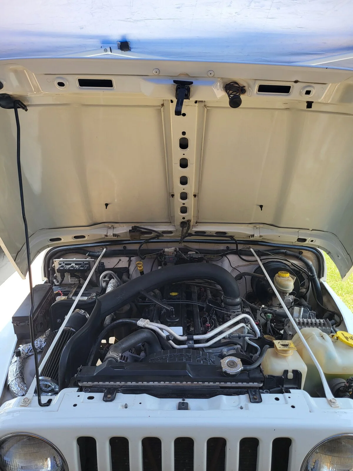

So yesterday I spent some time cleaning the engine bay and setting toe and straightening the steering wheel after the parts swap. The family wanted to go for a test drive, and my dear wife wanted to give it a first drive.

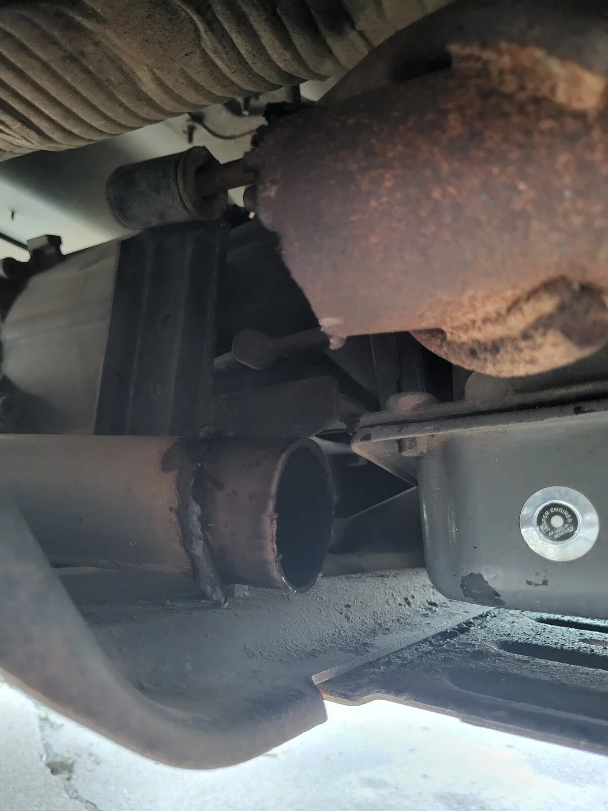

The wife wants to give the highway a go to let it open up! So away we go. Make it about 1/4 mile and hit a bump and -CLUNK- *BVVVRRRR*. No shuddering, no engine light, just lots of noise noise noise! We take the next exit, our exit, and pull into the neighborhood around the corner from us. As I suspected, the rear half of the exhaust fell off and was hanging from the rear hanger and laying in the transfer case skid. Shoddy weld finally gave I guess!
So here's to hoping that's what all that clattering was about!
So I guess we're adding exhaust to the list. I'll tack this back together in the meantime to get us by until I decide what to do with the exhaust system that I haven't been considering at all. Tummy tuck is in the future I think, so I might start preparing for that eventuality.

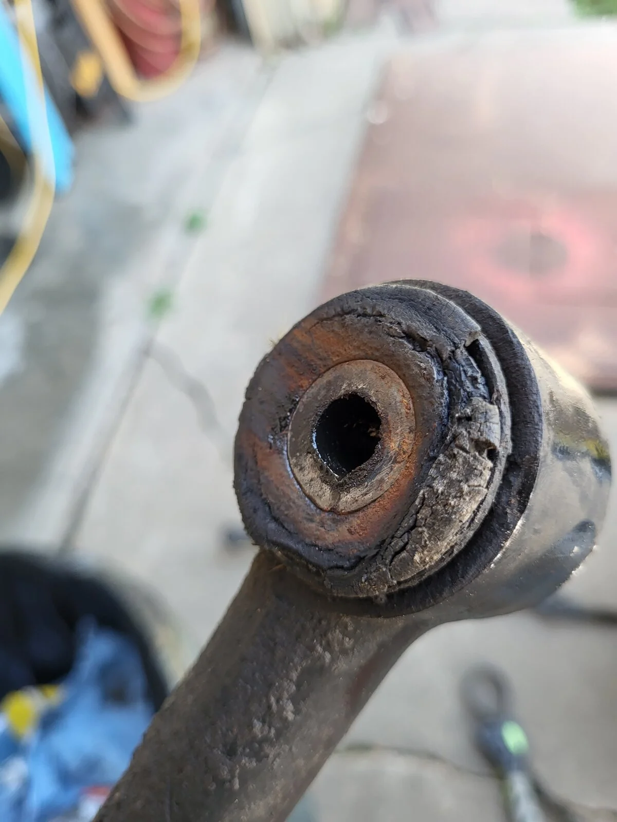

Ordered stock Moog control arms the other day, should be here tomorrow. I had been on the fence trying to decide if I was going to spring for Saavy/Curry arms and figured right now the money is better spent other places like the cooling system, full fluid and filter changes, etc. Just dump a good chunk of available change into general maintenance and PM. So the stock control arms fit the bill since the bushings are shot on the arms it has now.

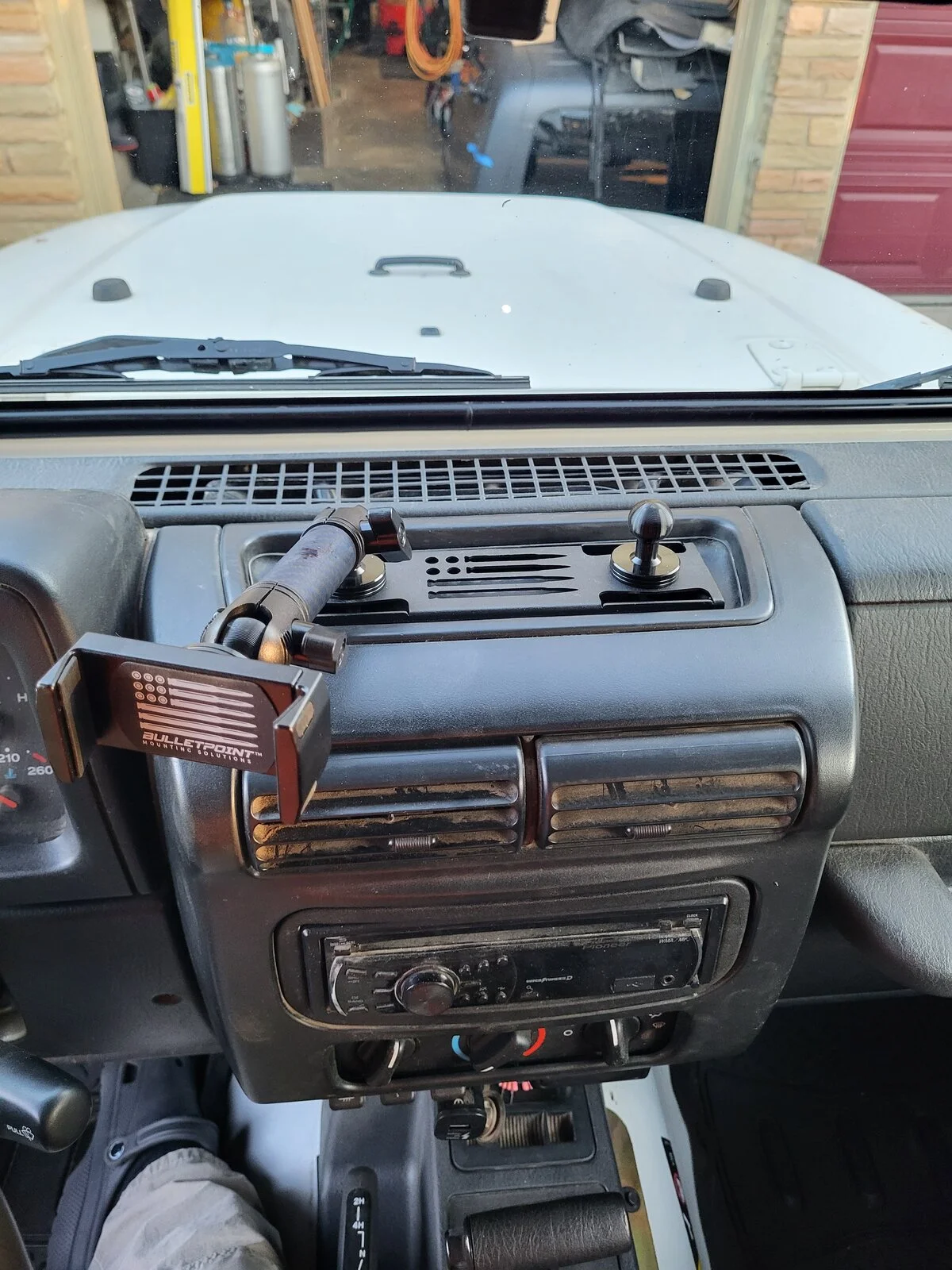

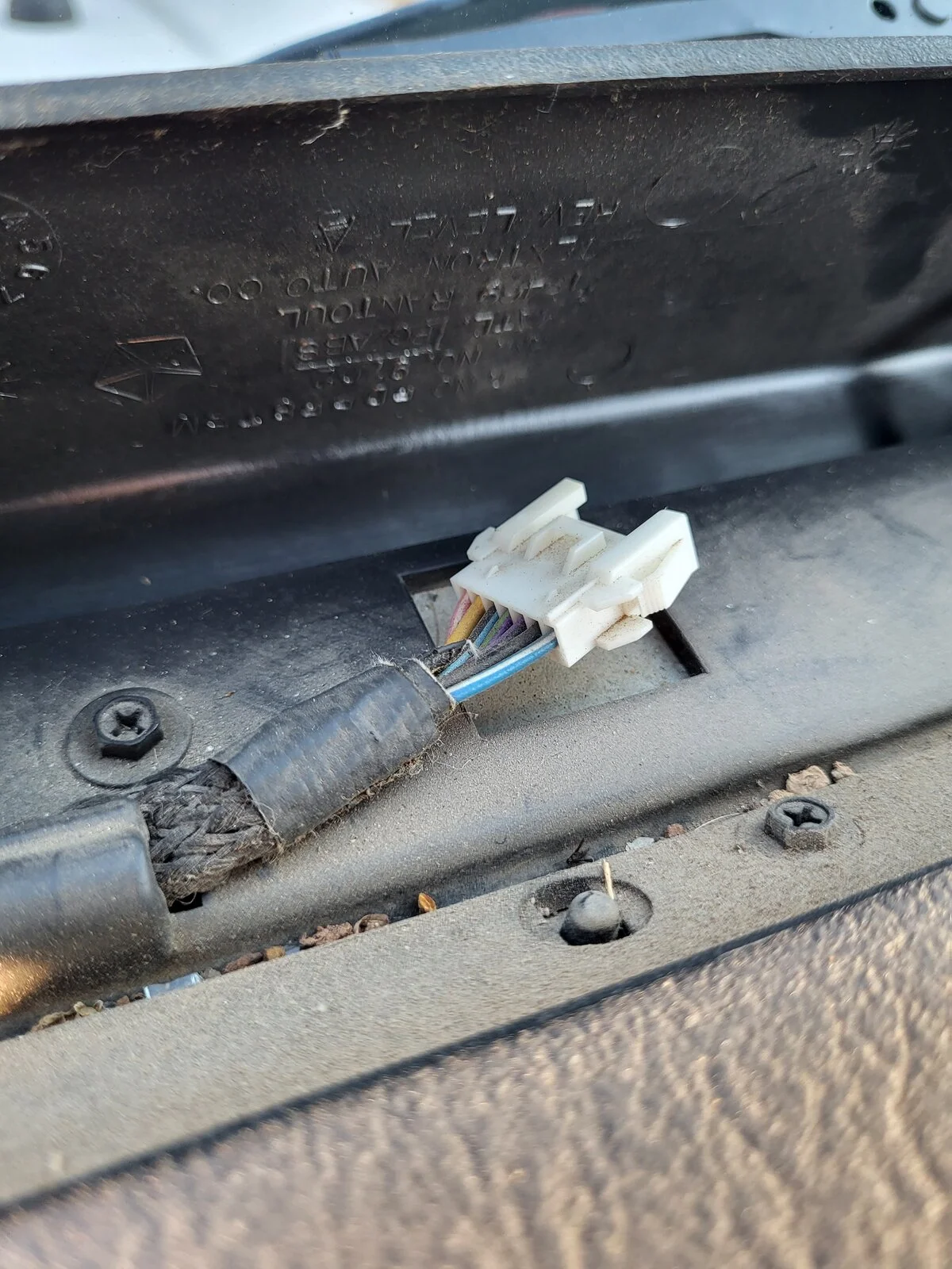

Got this Bulletpoint installed today. Found this harness under the dash. No idea what that's for yet!

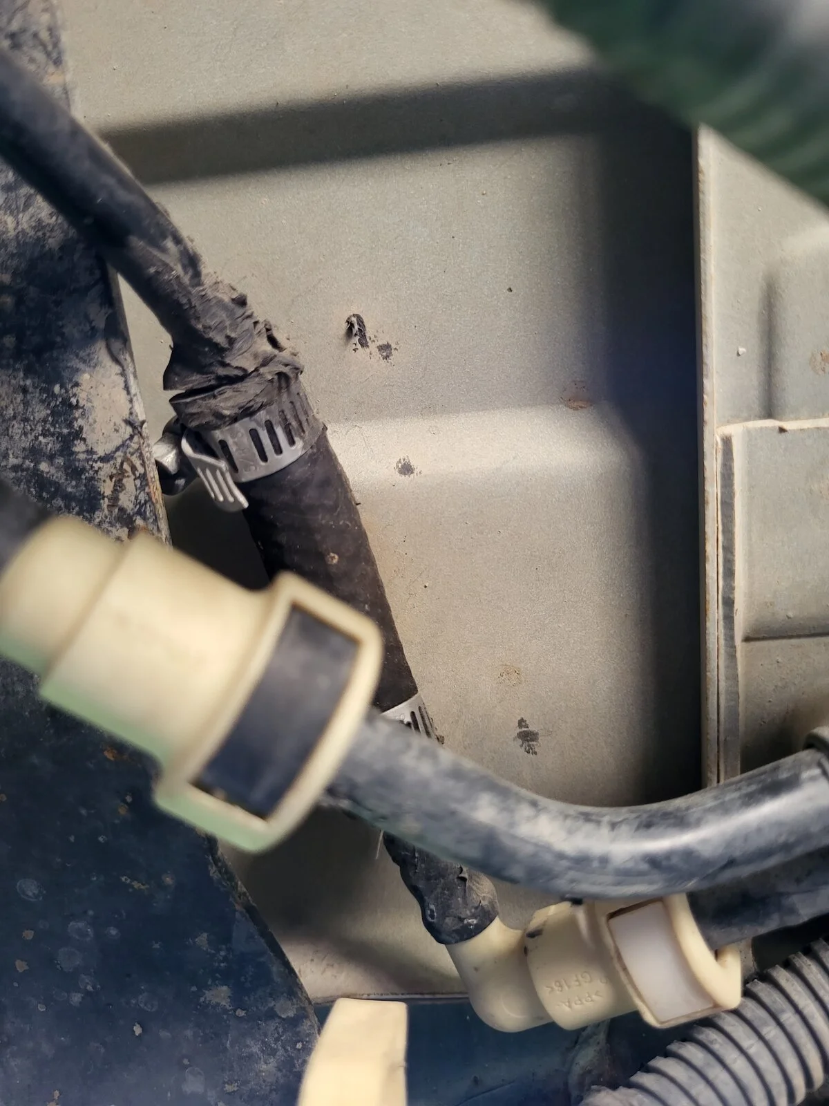

Second is P0442 which showed up last week. I filled the tank yesterday and noticed a heavy gas smell around the tank when I got home. Looked and saw fresh gas around the fill neck at the tank and settled onto the tank seam. Filler hose from neck to tank is old and a bit crumbly. Ordered a new one today so hopefully that is the fix there, although the evap boot at the can is looking a bit aged as well.

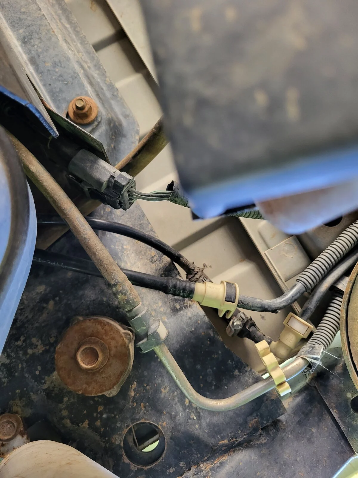

Saw this yesterday while working on the control arms. Doesn't look kosher to me. Not sure which line that is yet.
