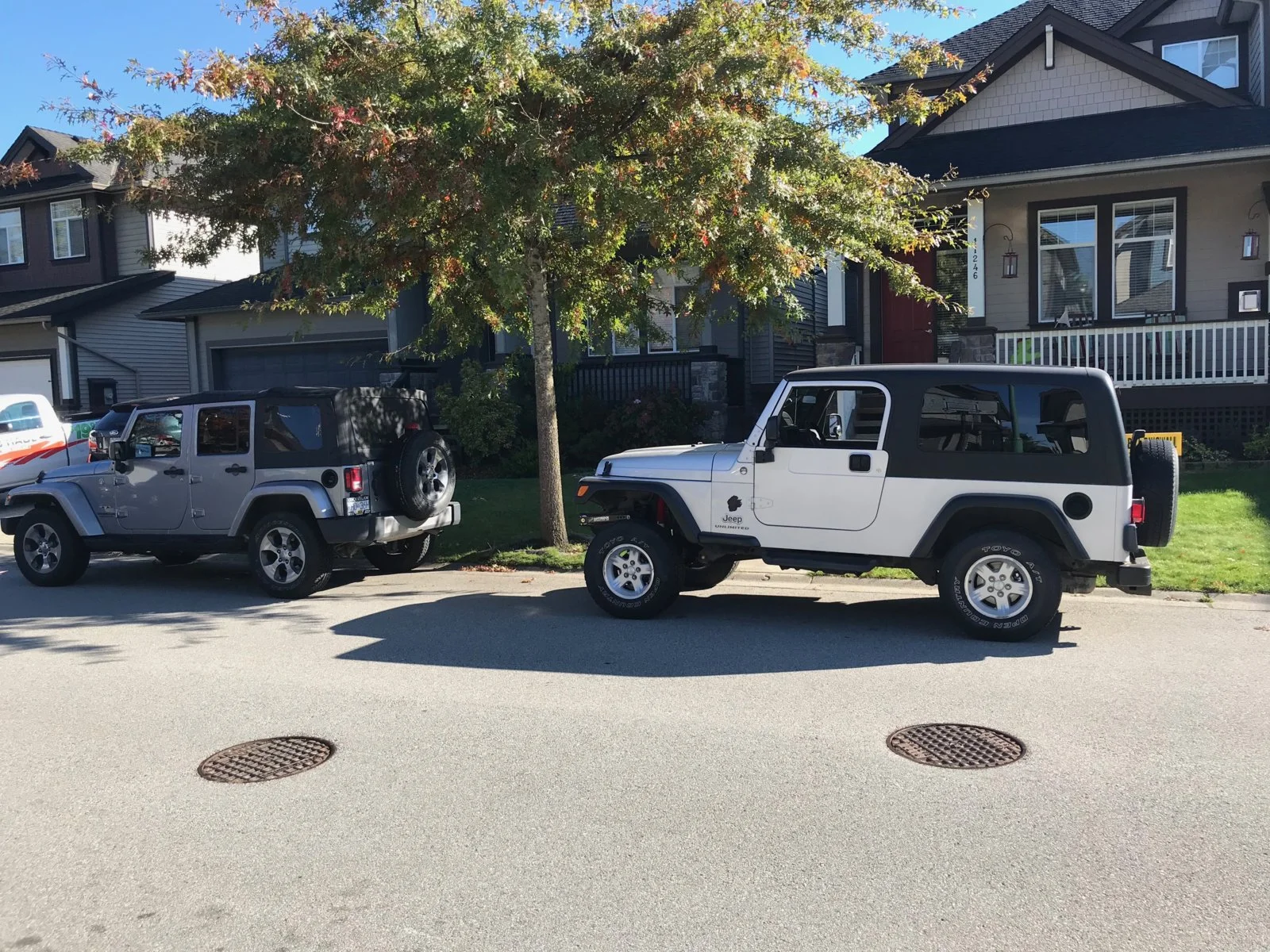

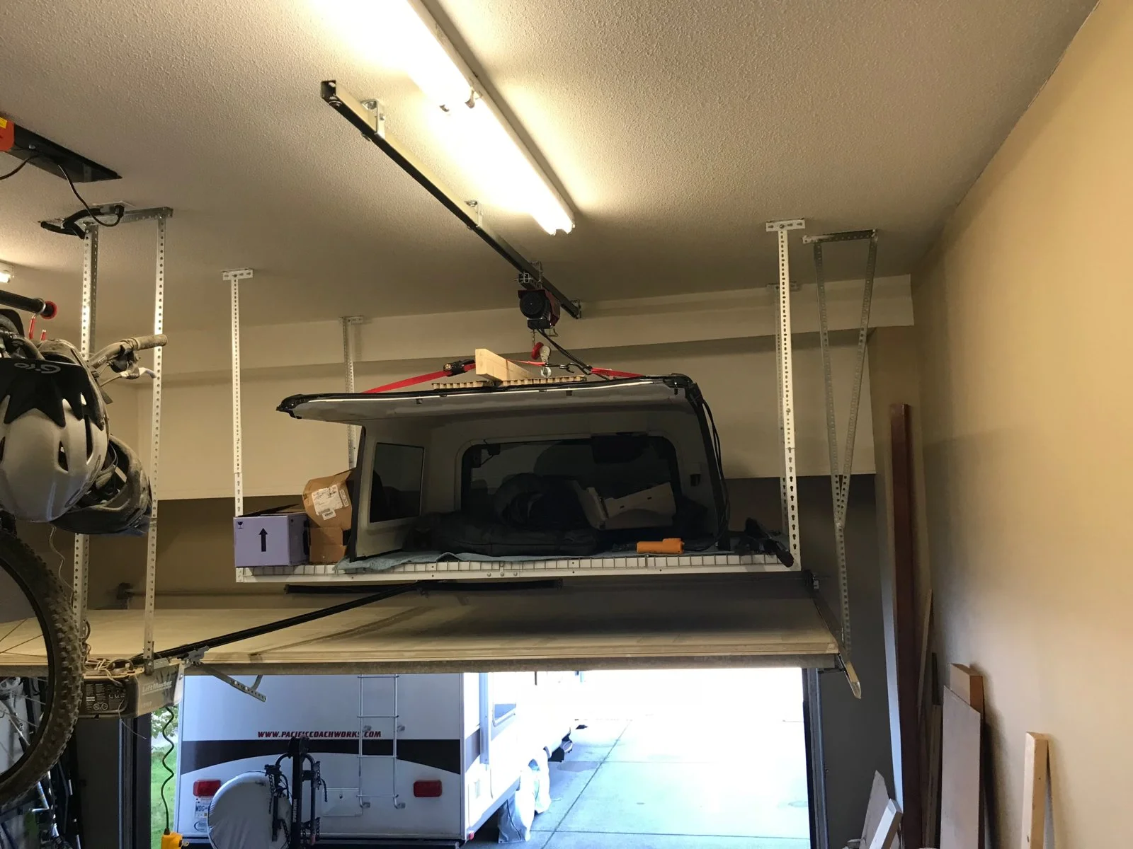

I had to limp the LJ out of the garage so I could put the hardtop back on my JK. Made for a nice side by side picture. I will be getting rid of the JK once my LJ build is complete.
I built a nice little system to swap out my hardtop. I have a HarborFreight hoist mounted on a Unistrut trolley that slides back and forth. I can then lift the top and slide it forward to store on a ceiling mount storage rack. I use a strap to grab the front and found these cool clips that connect to the rear glass hinge to give anchor points.
Neat n tidy setup , aawesome!!!

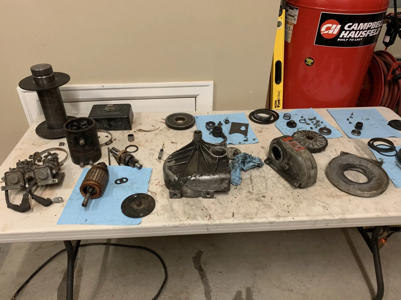

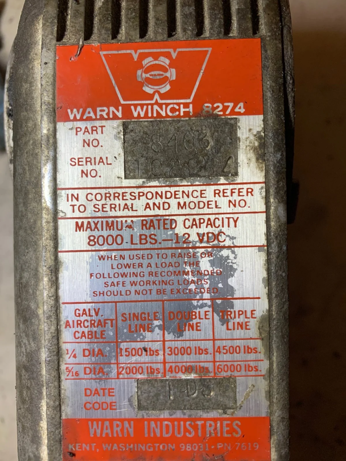

I got my winch all stripped apart and new bearings, brakes and seals on order. I was pretty excited to run the date code and learn it was made in September, 1978! It doesn't have a bit of rust on it and looks great being over 40 years old!
I have no idea how I am going to mount it to my bumper yet but I am determined to find a way!

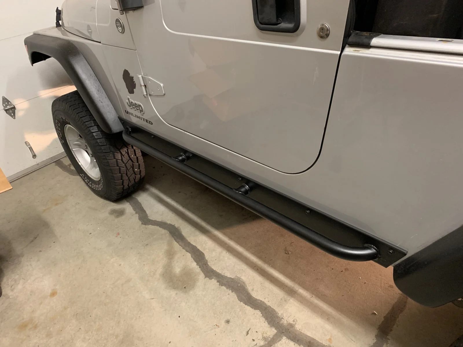

I really want to mount sliders but don’t want to put holes in the rockers. I had PS sliders on my YJ and loved them but I didn’t care about my YJ the way I do my LJ. Ugh! Looks great tho and I may or may not be a little biased when it comes to Silver LJ’s
And yeah, I’m aware of the bolt to the frame modes but ehh.
