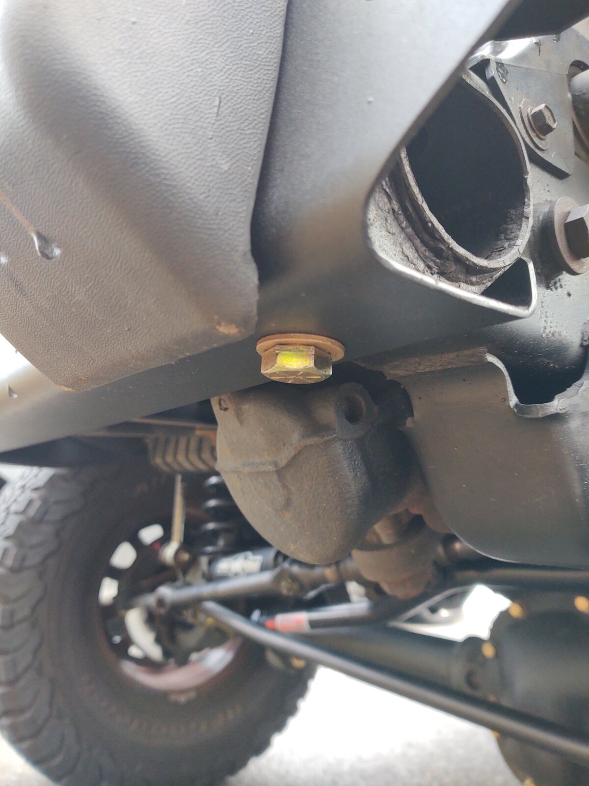

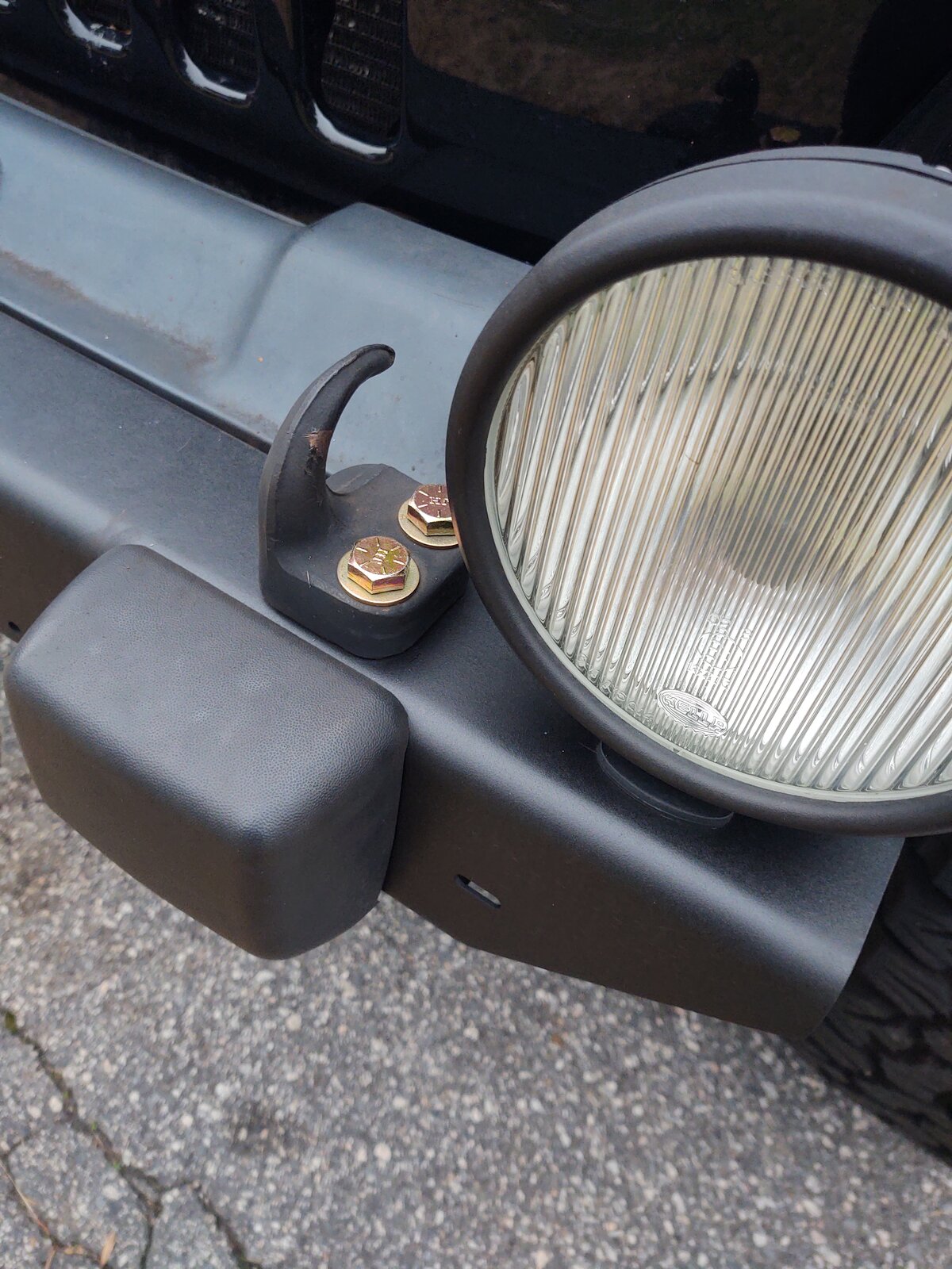

Is it odd that the smallest things bring me joy? Changed out the top tow hook/bumper bolts to grade 8 and added the 2 on the bottom. Apparently the shop didn't put them back in after the accident repairs.

I hate those torx , good call on the upgrade, maybe paint them black?

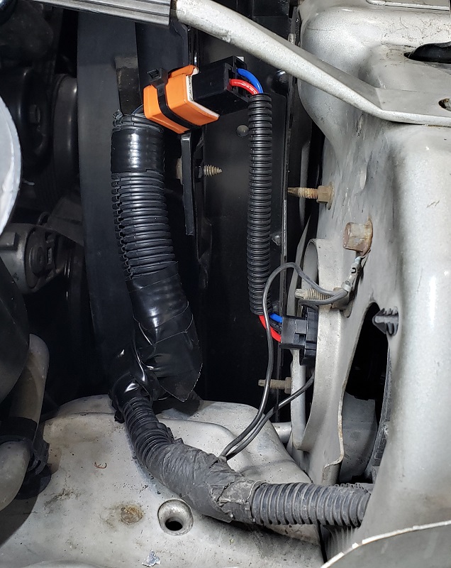

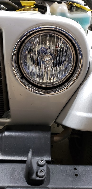

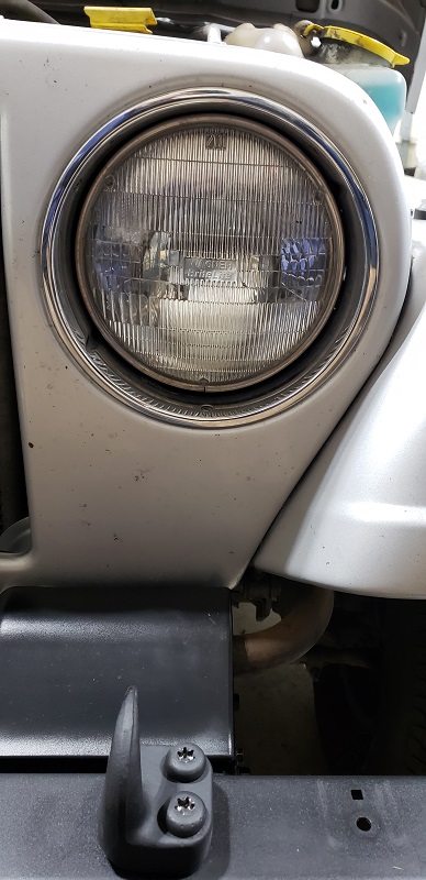

I want to upgrade my headlights but will not be going the LED route yet. Looking at a few of the H4 conversions for now.. I like the look of the Delta quad bars, but the KC and Rampage kits are cheaper.
If you're looking to go this route, just pick up a set of JK lights. They're dirt cheap, or maybe even free. I just added a set a buddy gave me. All that's needed is the H13 to H4 adapter.
https://www.amazon.com/dp/B07H31B43W/?tag=wranglerorg-20
While I was in there, I replaced the stock connectors. In my case, they were shot. Total upgrade cost me $15.
https://www.amazon.com/dp/B07D9FB45P/?tag=wranglerorg-20
Original
JK Headlights
Connector Fix
I just might do that, thanks for the suggestion! I'm all about cheap and effective
