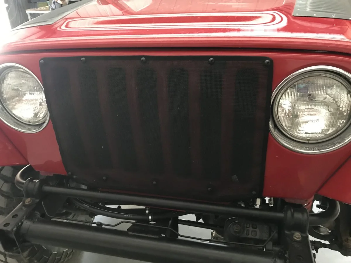

I went through a field last weekend that was above my hood and all I could think about was plugging up my intercooler and radiator. Luckily it wasn't too bad.
