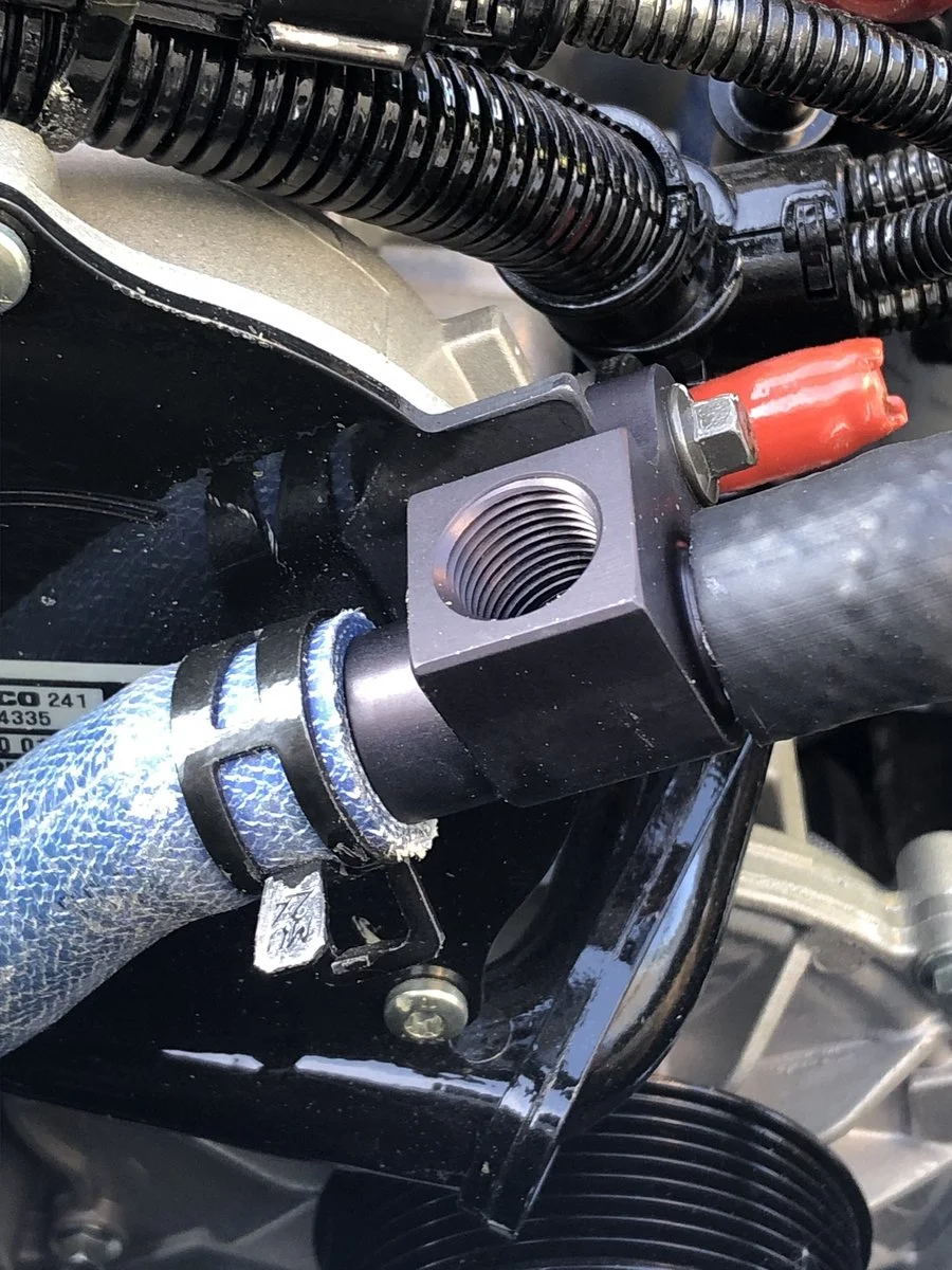

That’s your temp sensor port if your keeping your factory temp gauge

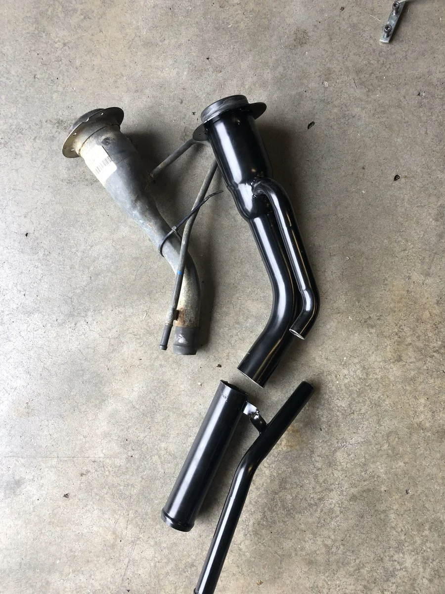

I bought a new filler neck from Rock auto for a 96 dodge 2500 diesel. I figured if I ever used a diesel pump that has the high volume I didn’t want to be restricted by the narrow tube from the TJ. Obviously I had to trim it a little bit same bend in the pipe so it fits nicely
The gas only restriction thing is plastic and breaks easy enough with a chisel and hammer. I posted some pictures of that but good to know that a neck from a 96 will work as well.
All the vent lines should hook back up to the original locations. You still want the tank to breath.. yes the elbow is installed for a return.
