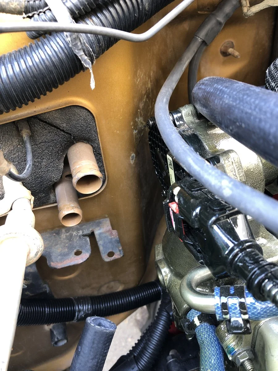

For the coolant hoses to the heater core, which hose goes to the front of the motor by the thermostat housing, top or bottom? On my 2003 the top hose mount is bigger then the lower mount.
Also where did you route the little hose for the brake vacuum line, mine old one is just laying on the firewall and I have no memory of removing it from 7 years ago
I went top of heater core to thermostat housing. And I just shoved that hose on the fitting. It was very hard. I have a TJ manual and it showed routing the opposite of how my 4.0 was routed. My hoses and fittings on the 4.0 were different sizes, so I think the manual was incorrect.
I teed into that molded line in the kit near the grid heater relay. For awhile I simply ran it so part of it looped as close to the firewall as possible and then just took a stab at cutting into it. I'll try to post a better pic tomorrow if I remember.
Put some rubbing alcohol in your hoses and fittings. Will slide into place much easier
See page 4 post 67 has pictures of what your needing I think.
I’ve already spliced the T-fitting into the hose for the vacuum pump. I’m just wondering where does the little tube go. My old one was just hanging on the firewall. Not connected to anything.

Off the top of my head I think that vacuum line goes to the HVAC controls.

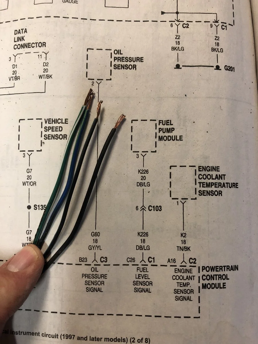

So It’s been about 14 years since the last time I played with aircraft wiring.
I’m trying to wire up the fuel pump in my 03 Jeep. The new pump has two wire. and my harness has four wires. Black blue stripe. All black. Green. Blue with green strip.
So I’m not understanding the schematic here.

I simply had to test mine to find the wires. I checked resistance between all of them and with different levels of fuel in the tank. Yes I forgot about this until after I installed my tank.
I think it's like 270 ohms full and 30ish ohms empty or the opposite. It's late here so I'm a bit forgetful.
Have you installed your tank? I was given some advice by Axis to not only ditch the pump, but also the OEM screens.
