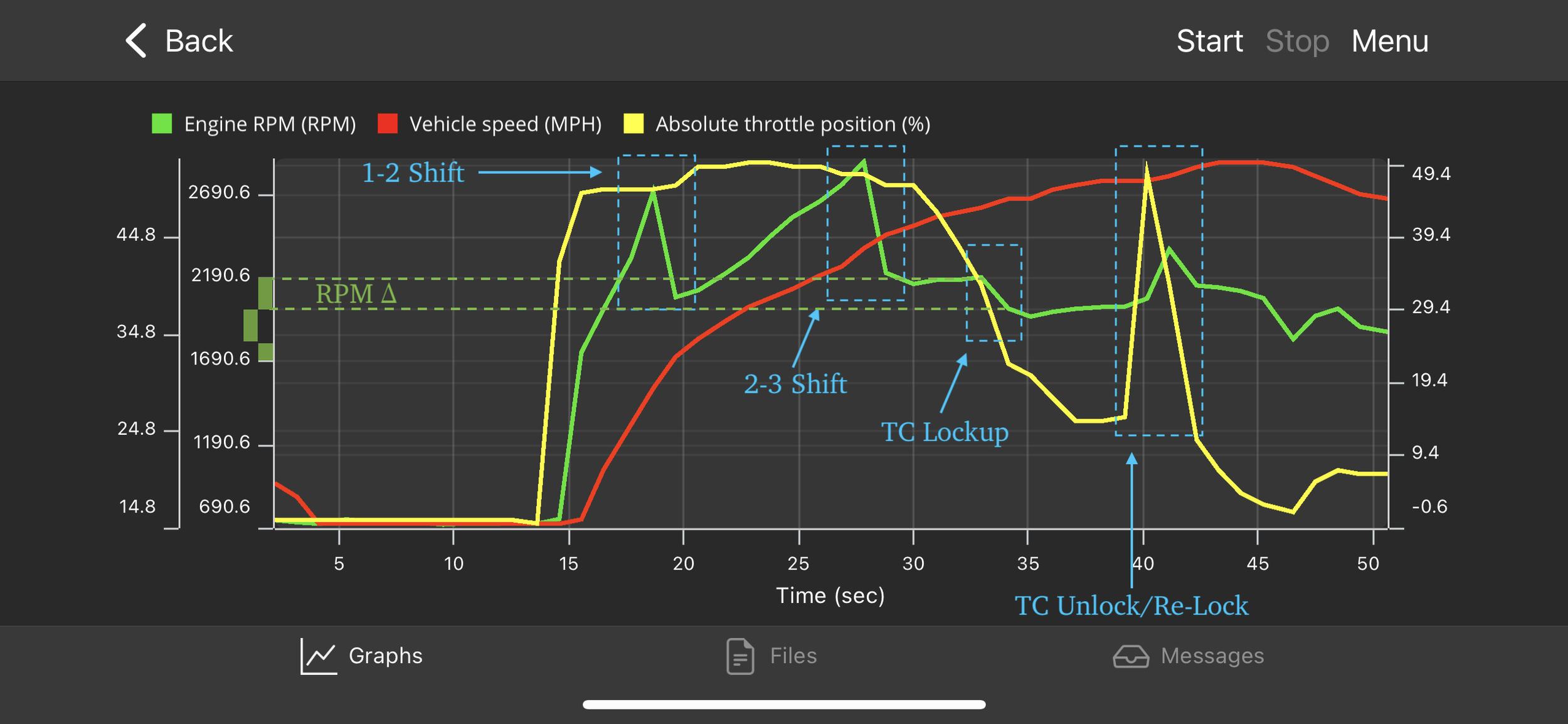

Snaps for technology. The 1-2 (@ 17 seconds) & 2-3 (@ 27 seconds) shifts are obvious. I'm at 50% throttle (yellow line), speed is increasing steadily (red line), and the RPMs (green line) drop in a predictable sawtooth. It is left as an exercise to the reader to determine the transmission ratios and axle ratio from the graph. The astute observer will recognize that I need to regear, and badly.
The TC lockup is evident around the 33 second mark, where I let off the throttle and the RPM drops again. The major divisions on the Y axis are 500RPM, the green blocks show that the RPM ∆ is roughly -200 RPM. Then at the 40 second mark & around 48 mph I jam the throttle and you see the RPMs bump up again. Clearly not a downshift based on the RPM jump, and the vehicle speed didn't change like you'd expect with a downshift either. Then I let back off the throttle and it locks back up. I should've manually put it into 2 at that point to show the difference in an unlock vs a downshift. Maybe I'll do that later today.
For reference, one minor tick on your Jeep tachometer is 250 RPM, so you should see your RPMs drop by about one tick on the tach when it locks up.
