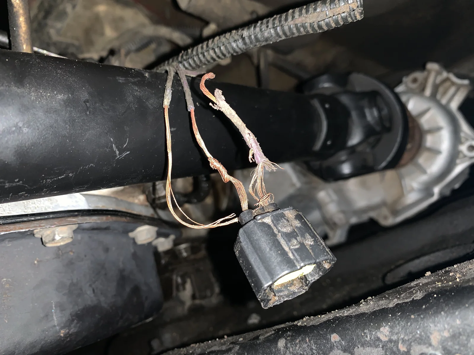

Hey guys so I just swapped out my transmission on my 2002 Jeep Wrangler 4.0L automatic with a used one that came from a reliable source.
Two days after changing it out I got code p0740
I noticed the automatic wire harness was in bad shape and all wires were basically exposed, I tried to separate them individually and did a full repair on the harness but the jeep is still throwing the code. I barely got it passed smog as soon as it passed the light came on. The transmission came from a very reliable local source and shifts smooth. My plan is to change the tranny fluid out this weekend, drop the pan and swap out the solenoid from my old one which Im certain is still functional Im gonna use ATF +4 with mopar filter. Its impossible to find a transmission wire harness though where do I get one? Before I drop the pan I would like to find a new harness to at least mark that off. The TCC wires were touching. Literally all transmission wires were exposed and touching each other before I fixed them. Its never thrown a code before the transmission change. I just had my ecu/pcm repaired before changing out the transmission. Im hoping that the wires touching didnt damage the unit again but I imagine that could be a possibility. Anyone got any ideas? Has this code popped up for you before and what did you do?

I see a lot of Jerry's posts he's the man for sure! He's helped me out with a lot. I just bought a complete wire harness off ebay im gonna see if that fixes the issue. I asked the mechanic if I should get a new torque converter he said no cause it was a used transmission. When I reset the code it doesn't come on unless I drive it a lot I imagine when it gets too hot? The code stays pending then turns on after a long car ride. I got the harness coming though you can see how the wires looked in the pic I imagine the whole harness is shot. gets pretty hot down there. Same with the TCC wires they were bare and touching.
