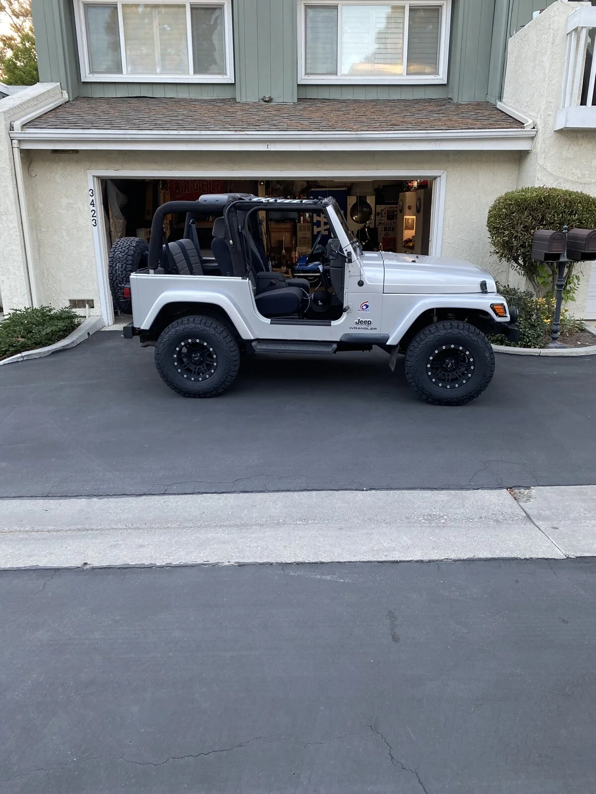

Got the 32’s installed today.
Test drive showed little difference compared to the 30’s that were on it.
BTW, it’s a 2003, 4.0 auto.
A short freeway ride also showed no signs of trouble getting up to speed.
We live in SoCal, so mostly flat except for when we go up the hill to Big Bear, Arrowhead, etc.
The only thing I think I’ll change out is the speedometer gear to get a bit closer to actual speed (compared to GPS data).
I think it looks great and it’s not too tall for my old ass to climb in/out of; and my wife likes it which is great because technically it’s hers…
