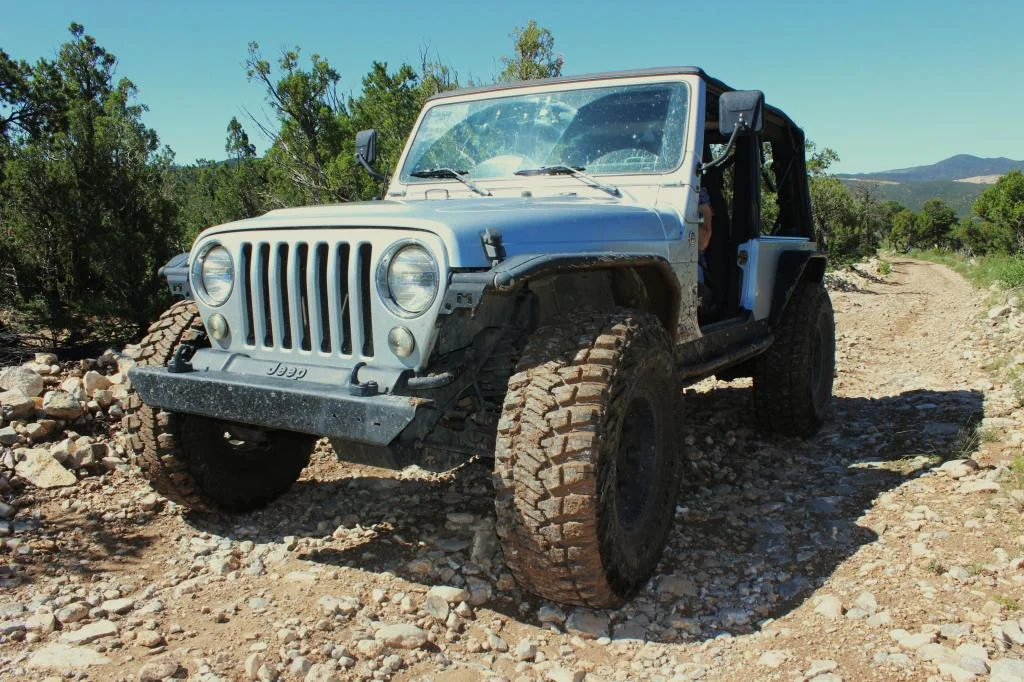

For 33s and under, MC fenders will allow for about an inch less lift for a given tire size. 33s will simply not fit with no lift and still provide stock suspension travel.
