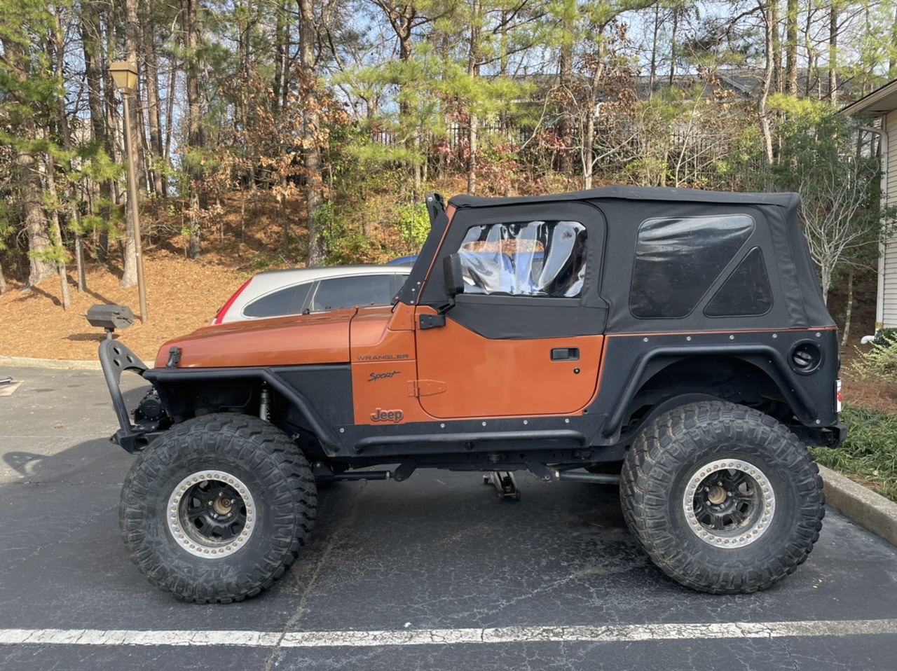

For reference these are new 35” tires on 3” coils and 1.25” body lift. I don’t know that I would go any lower than that for 35” tires unless I was cutting the rear tub wheel well and running true high lines in the front.
For armor I would recommend genright aluminum. The weight savings is pretty significant over steel when you add up 2 fenders, 2 rockers, 2 rear corners and if you decide to go with their bumpers as well(only front is aluminum.) They also do an excellent job of stocking their products so your wait time will be minimal.
If you go 35” I would go no less than 4.88, probably 5.13 if you keep your automatic, which I would if it’s working fine.

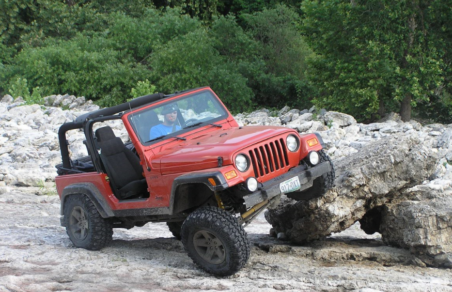

You can do a lot of wheeling on 33's. This was my TJ with a 2" Old Man Emu lift and a 1.25 body lift with 33" tires. I later went bigger but shouldn't have. This was a fantastic setup for both on and off-road.
Yeah...33s can get you in a LOT of trouble, and have a lot of fun. I've gone into the 35 pool headfirst. Got all the fancy suspension and have tried to do it "right". I have a buddy that spends as little as possible on his jeep. 3" quadratech lift , 33's, 4.56 gears, front lunchbox locker and rear limited slip. There has been exactly one obstacle that I could do that he couldn't in all the times we've been wheeling (and that was when I was on 33's too). I'm in Michigan though, so the big builds aren't that necessary. We're going to start travelling this year...I better be able to go farther, LOL
I still haven’t gone anywhere I hadn’t on 33’s, I just don’t hit my CA mounts and rear bumper as much, and I can get through rock piles faster.
