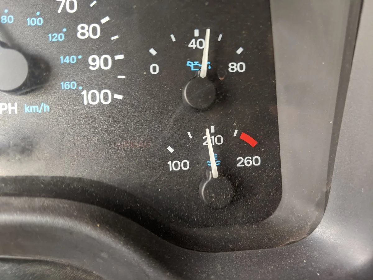

Problem fixed, running normal now:

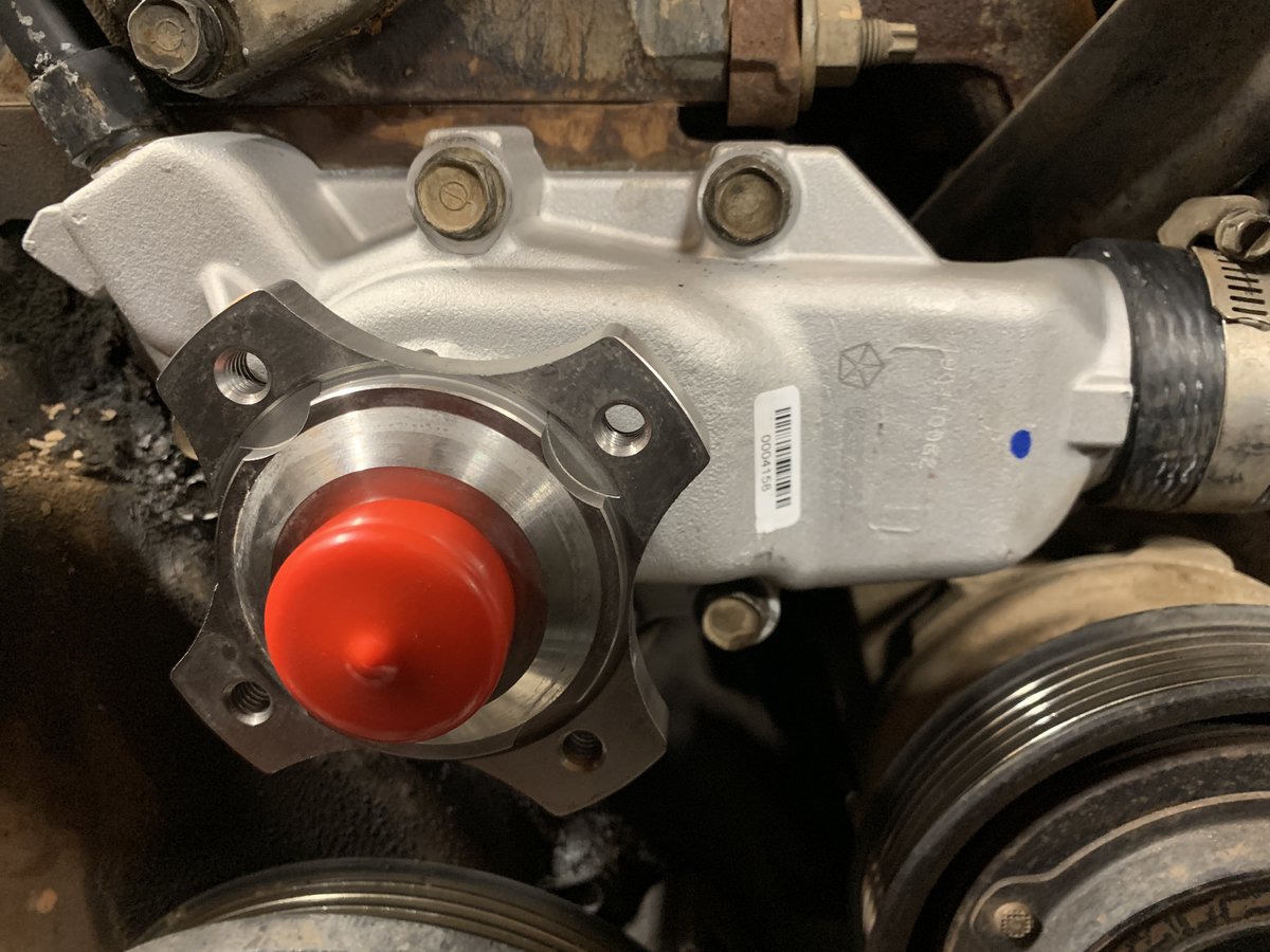

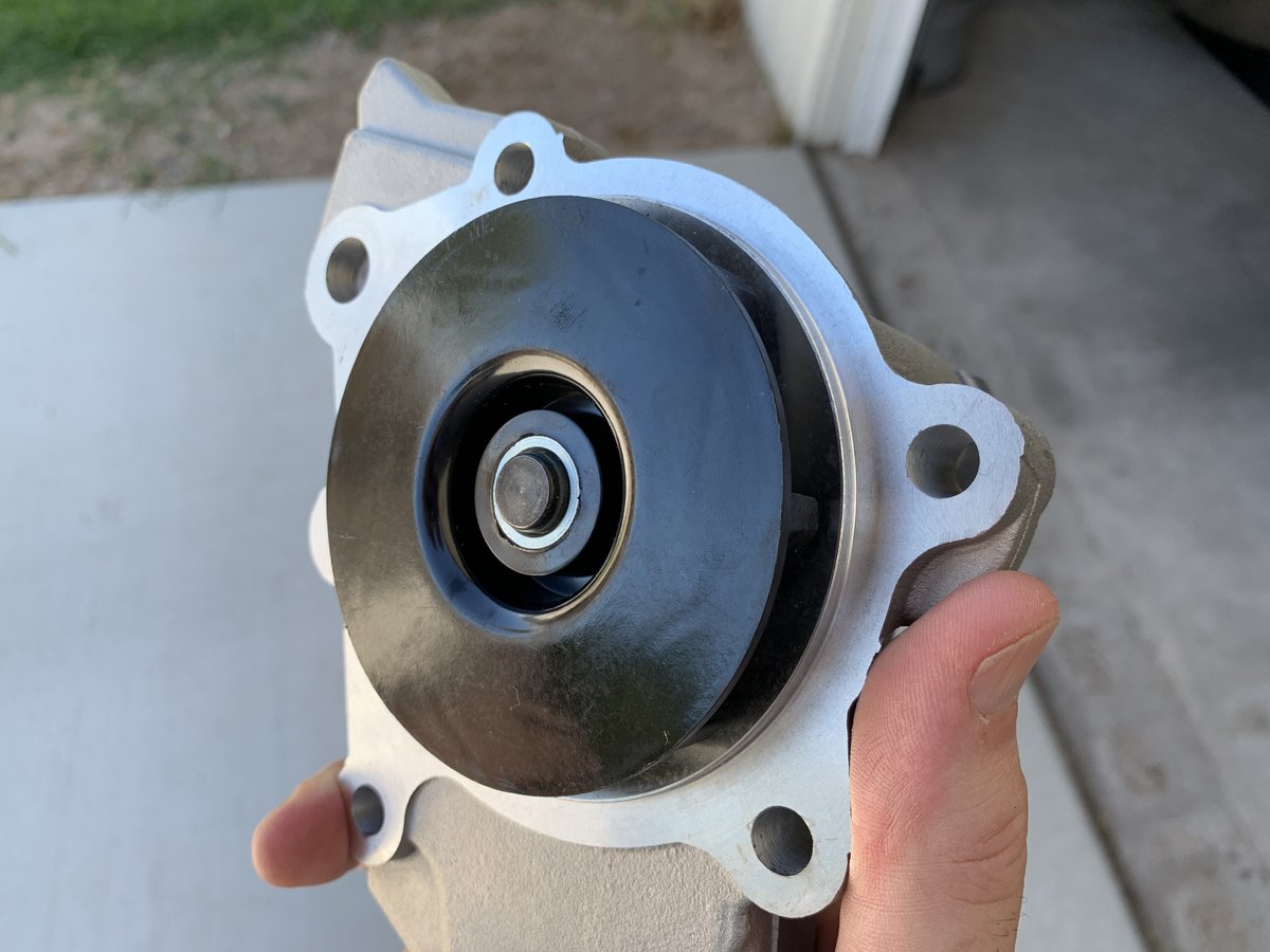

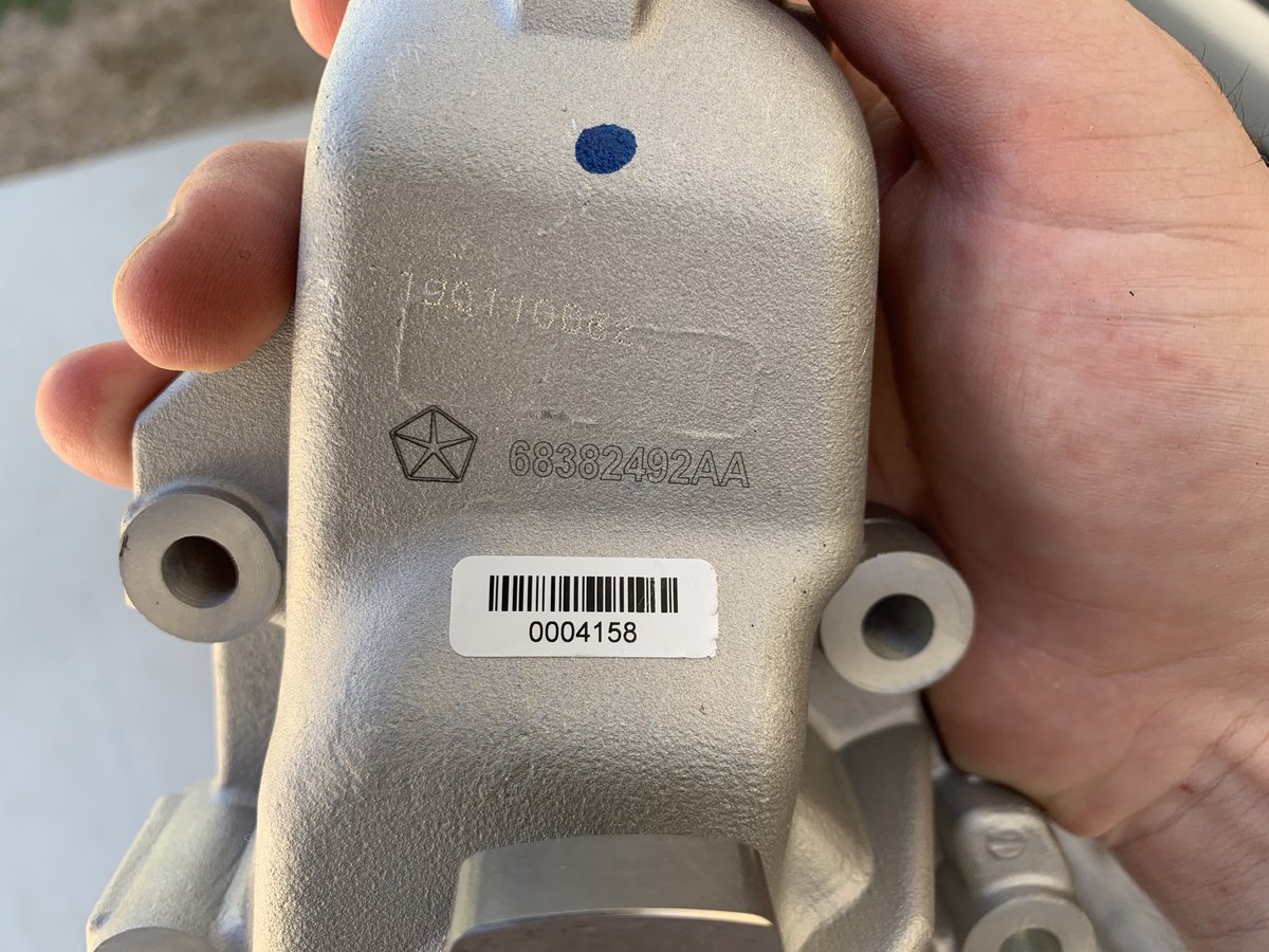

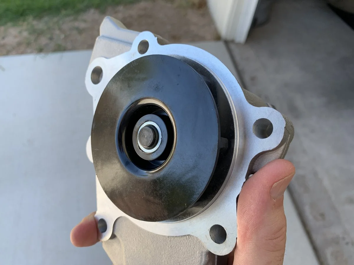

Wow... I mean I was prepared to see some rust, maybe the tips eaten out a little or the impeller detached from the shaft, but a star shaped disk?? LOL. That probably took years to get to that condition. Anyone knows how to tell if this a mopar pump or not? I cannot find any Chrysler stamp on it, just TU03 C-7136.
That does not look like a Mopar pump, unless they've changed their design significantly over the years. Here's mine that I installed in September:
