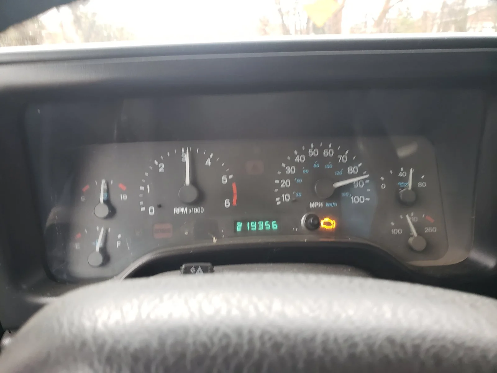

At 55mph it's at 3000rpms. I'd say 70 or above it would be 4 or more. And the locker makes it road walk. We have never built a jeep and just going by what a friend said. I daily drive it to much for these gears. And with my built 4.0 it did great with the other than steep hills and I had to drop it in second myself because it wouldn't down shift.
That doesn't add up. According to Grimmjeeper, Your tires have a rolling radius of 14", which is in the 29-30" tire territory.
32rh/28"/4.56 = 3010rpm @ 55mph
Fix the speedo. 3000 rpm is 68 miles per hour with that set up.

Ignoring the incorrect speedo, what do you think of the gearing? Use your phone as a speedometer.
:aplastao:
Reactions: jjvw
I have been using my phone for the speed. According to my phone this was around 66-67mph. I honestly can't tell a difference in the gears other than the rpms being different. I have yet to take it offroad. Well I guess I can tell it does pull big hills better. I can stay at higher speeds.

I may get slammed for this....
I know grimmjeeper is considered scripture in the 4wd world, but your actual rpm is reality.
If your wife leaves a note she loves you and only you, and you see her walking into a motel with your neighbor, trust your eyes.
On a regear , people are often startled initially by the change.
Blaine is so right....proper gearing is really good for the the entire driveline.
Grimmjeeper matches reality very well if the data you enter is accurate. Most get their tire size wrong.
