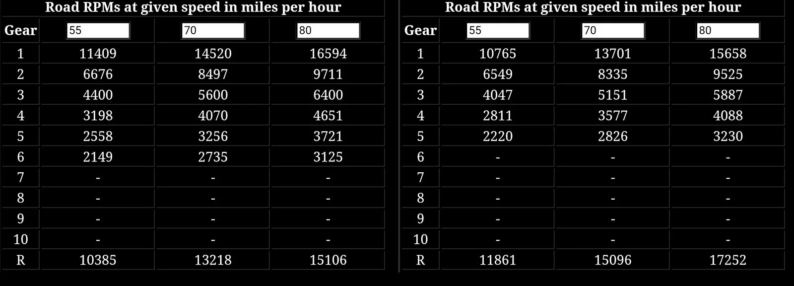

To add more fuel, check out this comparison:
On the left is a bone stock 2006 Rubicon with the NSG370 6-speed manual. The OD ratio in the NSG370 is only 0.84:1 (unlike your 0.79:1). The Rubicon also came with 245/75R16 MTR tires (681 revolutions per mile) and 4.10 axle gearing, as well as the 4:1 transfer case (in place of your 2.72:1 case).
On the right is your proposed 5.13 regear with 35s and AX-15, using 598 revolutions per mile (typical for a 35x12.5R15 MTR) for the tires.
Compare the engine RPMs in the overdrive gear (6th for the left, 5th for the right). They are exceptionally close. So your proposed build would have a final effective gearing very close to something that left the factory. So there is no significant risk of damaging the engine or transmission, nor is it too deep to be drivable.
Also note that 35s and most modifications result in worse aerodynamics, meaning the power demand at a given speed will be higher for a lifted rig on 35s than for a bone stock Rubicon. So you will actually still have less reserve power than the factory Rubicon in overdrive, meaning the deep gearing will be more valuable in your case than it was for the factory Rubicon.
In low range, due to the difference in transfer case ratios, you will still be effectively geared way taller than any Rubicon was.
