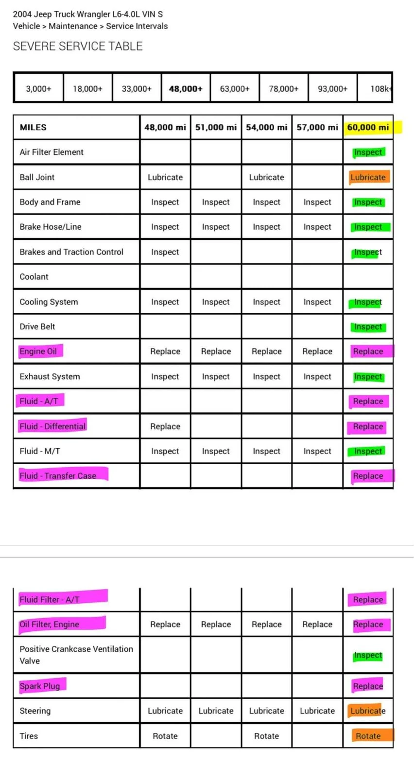

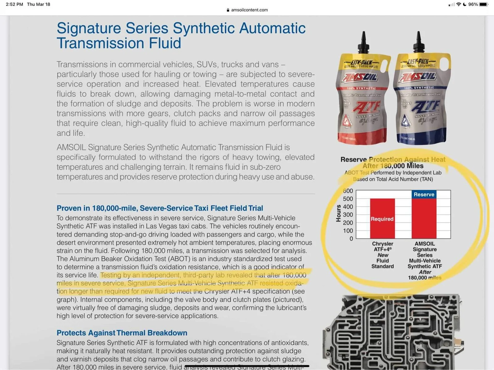

Hey all,
So i am a bit over 60k miles and i am going to do a tune up. So prices range from 300-1k. The 1k quote says they use top of the line fluids not including oil change and transmission filter service.
I go offroading maybe once a month when it is warmer if that makes a diff between types of fluids i should get.
Is it worth the price tag or no? Thanks in advance.
