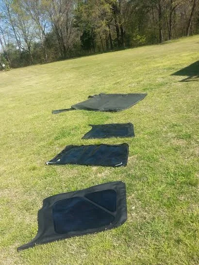

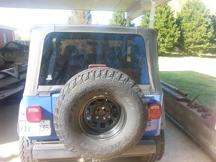

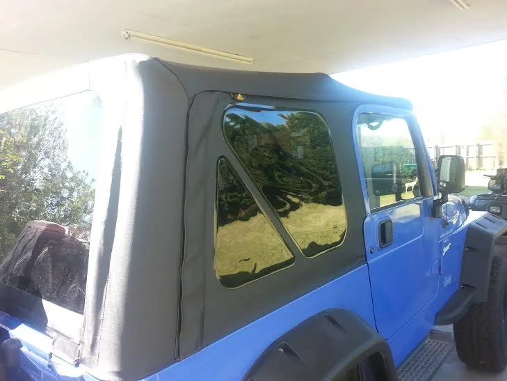

well i had my mind made up to install the bestop replace a top today. the one i ordered was the sailcloth with out door skins. So i followed the directions and watched the installation videos from bestop, and things went perfect. i set the top and windows out in the sun to heat up which makes it easier !!!! The top fit like a glove. its tight and you have to have some hand strength for this job. but once its on, it looks great. there are two places that are a little wrinkled or not so tight, but will not effect the top at all. Plus bestop says after a couple days of being in the sun and cooling off at night will get rid of all the wrinkles. So far i give it a 9. ill give up dates over the next few days . i took a few pictures, so ill try and post them .
Reactions: livewire99
