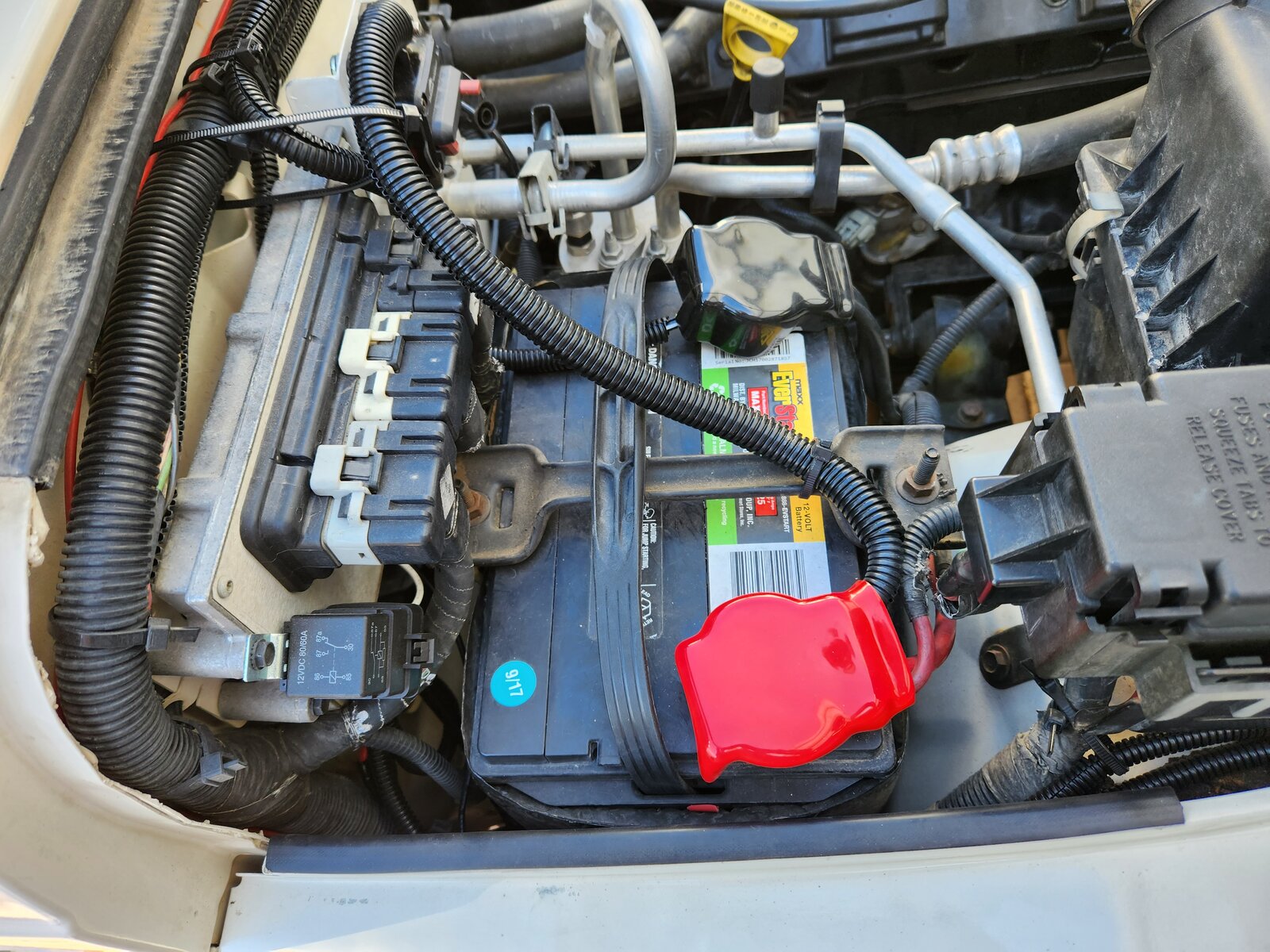

Battery terminal covers, these have wide openings on the back and you can easily slip them onto your existing ends to help with the poor design of the positive terminal being so close to the fender. https://www.amazon.com/dp/B094N2NLQB/?tag=wranglerorg-20

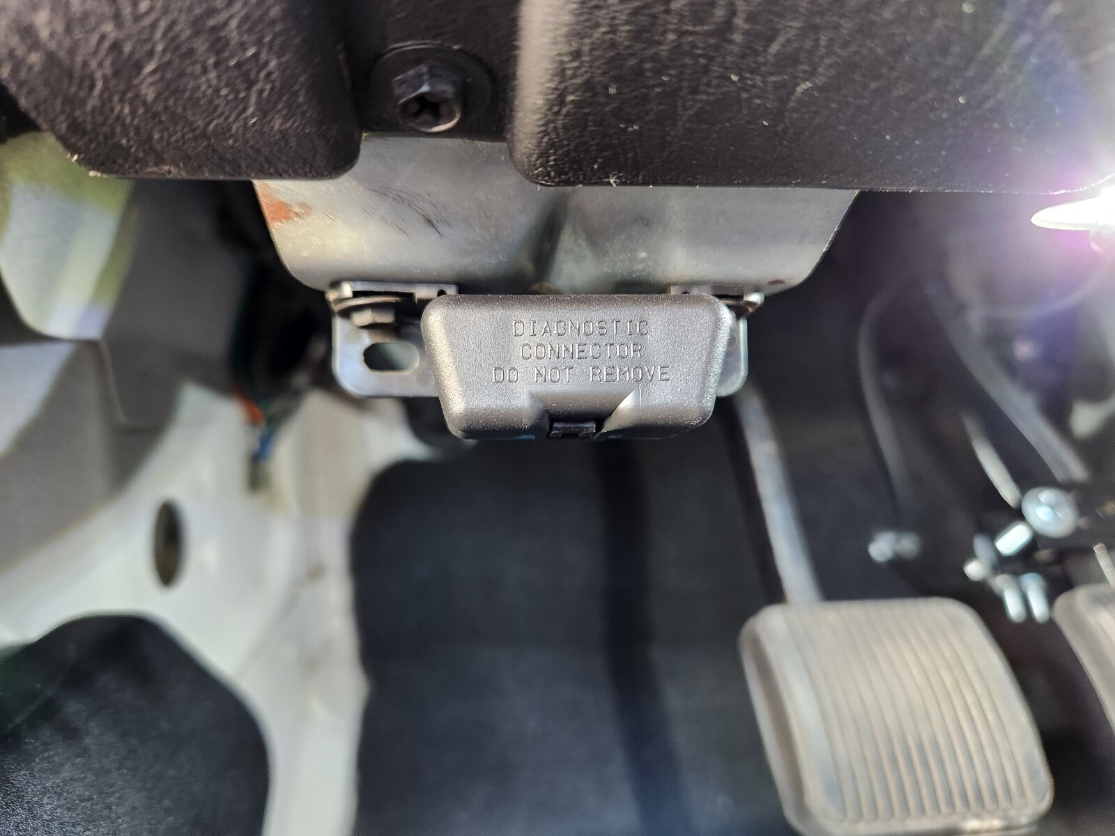

Next is a cover for the OBD port, seen a lot of them get messed up especially with the environment of a Jeep which is often open to the elements. It says it fits GM vehicles but an OBD port is an OBD port and it fits the Jeep perfectly: https://www.amazon.com/dp/B07PGDD6ZN/?tag=wranglerorg-20

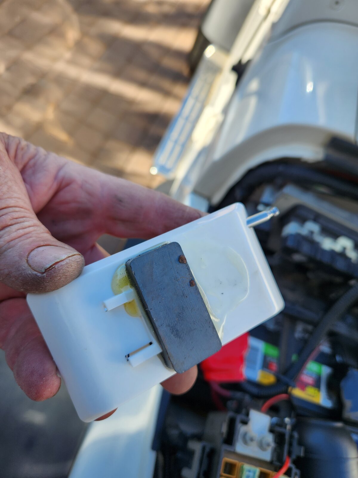

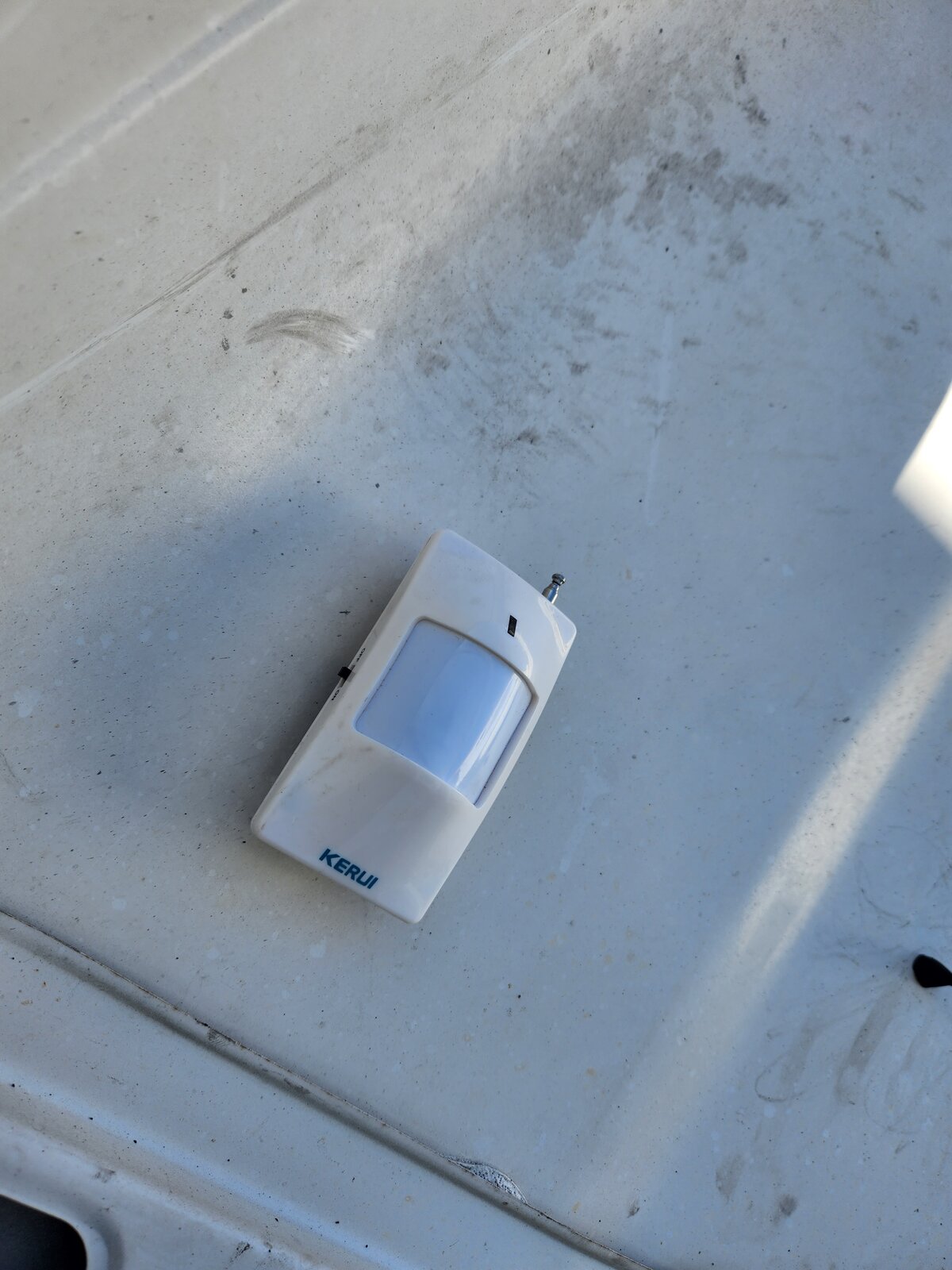

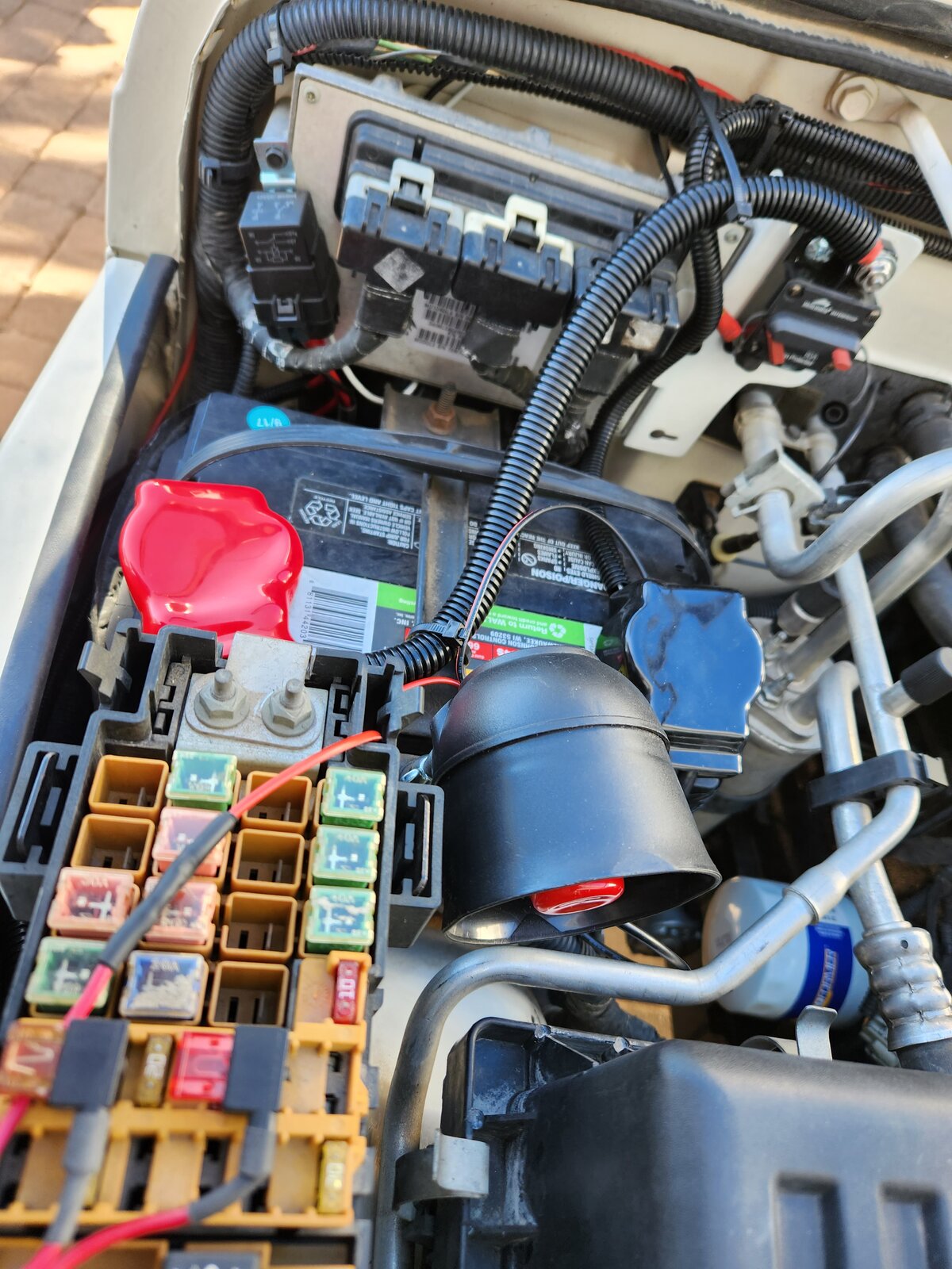

Finally is a cheap alarm system that works great, I bought two plus some extra sensors. I glued magnets onto the motion sensors and can stick them under the hood, tailgate or in the cab. I use these on my motorhome, truck and Jeep. The system works on 12 VDC so you can cut the cord and wire it to the battery (with a fuse of course). I move them around as needed and you can keep a siren under the hood and another in your bedroom if you want, they will both sound off when activated. I do this in Mexico when my vehicle is parked outside. I found out about this system from people who are using them under their vehicles to protect their cats. If you do that you need to tape off the edges of the motion window so they won't activate when someone just walks by the car.
