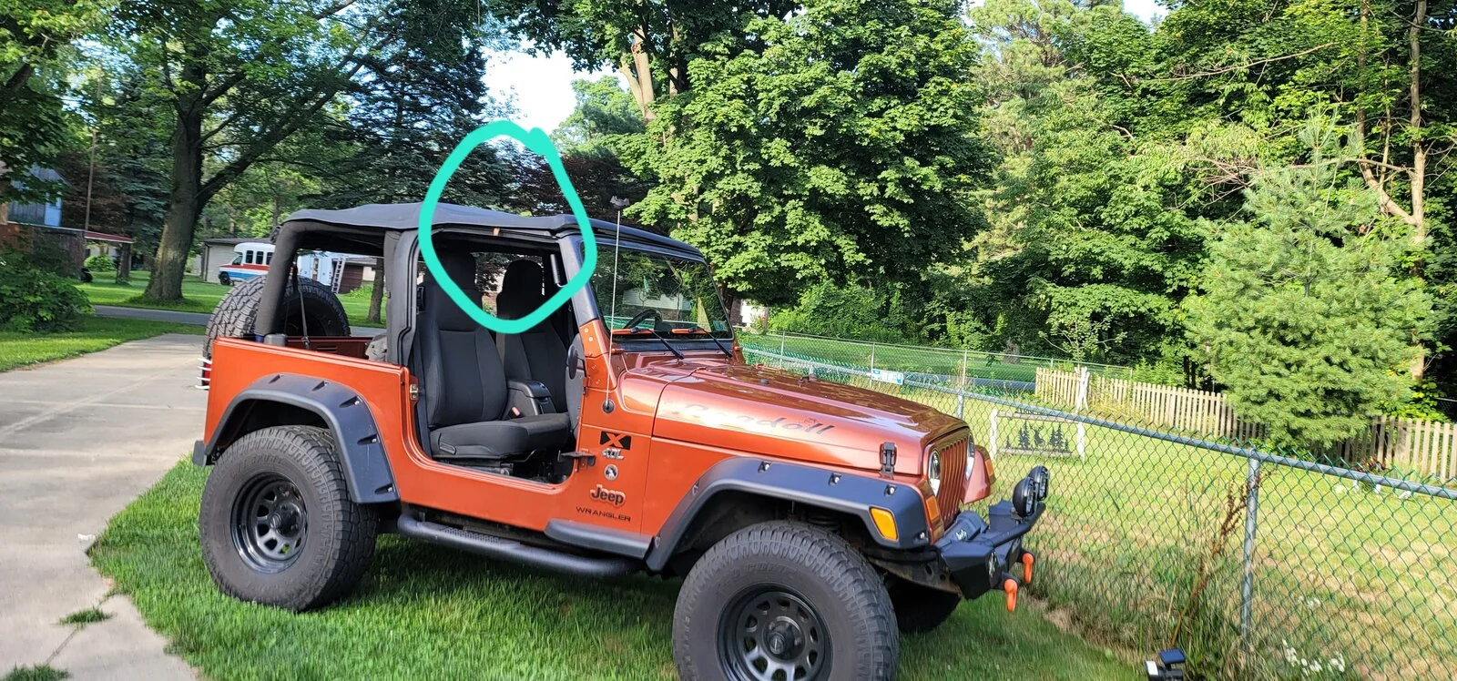

I always had a hard time unhooking the sides of my soft top I made myself little pull tabs (I call Stirrups)
I cut strips of leather and sewed them on. I used a needle/ thread for leather work. I only needed about 6 stitches.
They are attached to the piece of extra material that is there to help unstuck the sides, but mine had been cut when they installed the Adventure Top.
Now, I just pull the tab up and out and they come untucked with no effort at all. It's been 3 or 4 years, still hanging in their.
