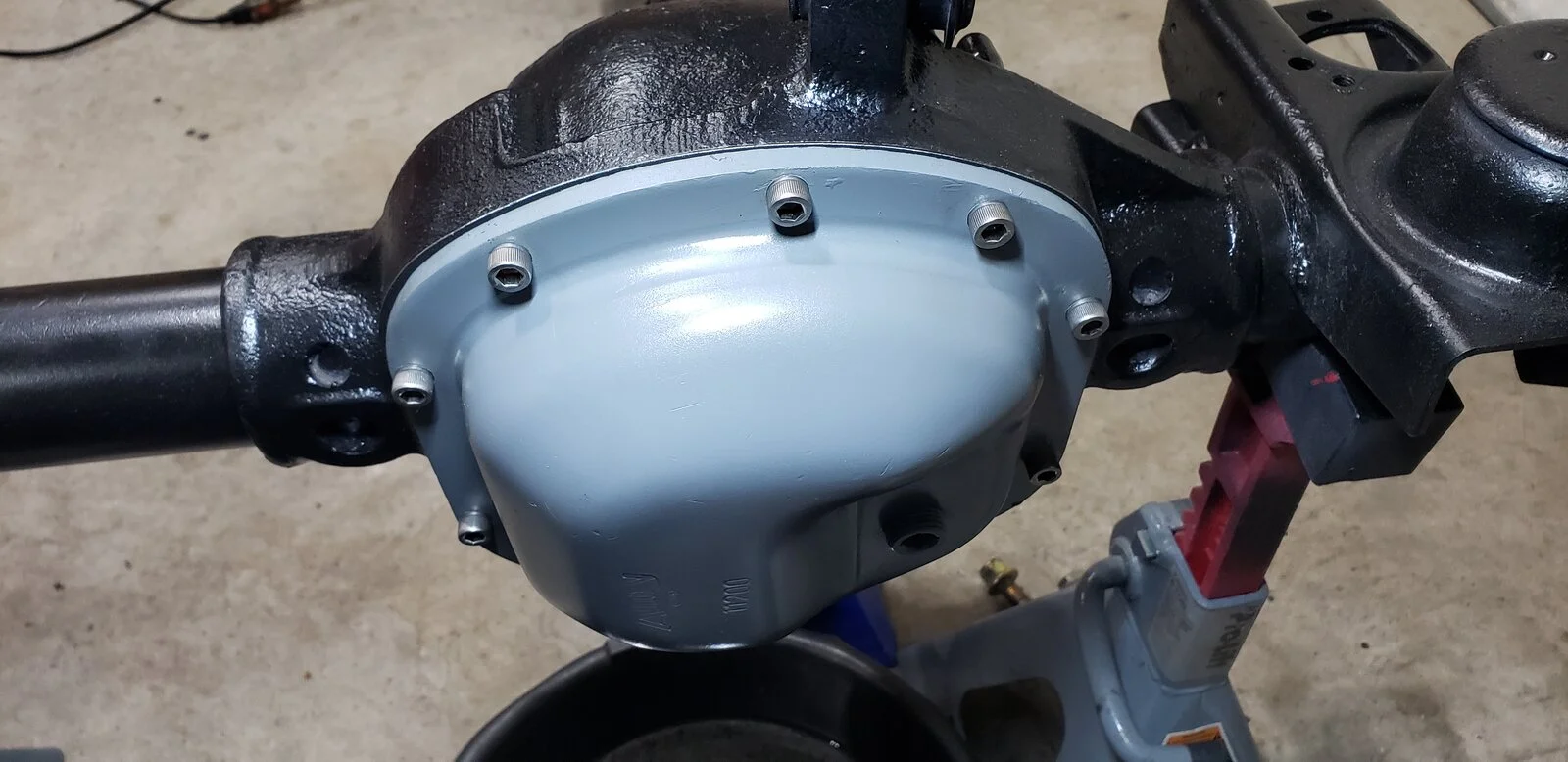

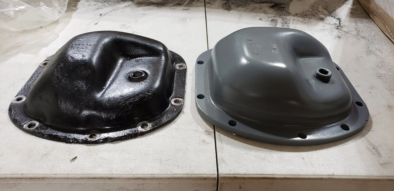

Ending on a plus note. The Alloy Cover is awesome. Got it on Amazon for $23. At this point I'll take a small victory!

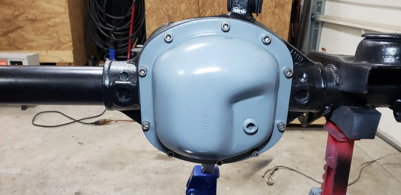

Started digging around on amazon and found this for the 44. Any experience? Doesn't look like it takes up much more room than the stamped steel cover. As pinion angle increases, when does fill plug location become a problem?

That's the one from Alloy USA?
That thing is beefy, no clearance issues with these?
Yes, it's the Alloy cover. It's only nominally taller than the stock cover. However, I couldn't believe just how much beefier it is than the stock one. I wouldn't expect any major clearance issues, but will find out once all the suspension parts are installed and I can cycle it.
Looking at the cover, I wouldn't expect there to be any fill issues. Unless the pinion was at an extreme angle. I do plan on installing a Savvy UA, but I'm keeping the spring lift between 1" - 2".
