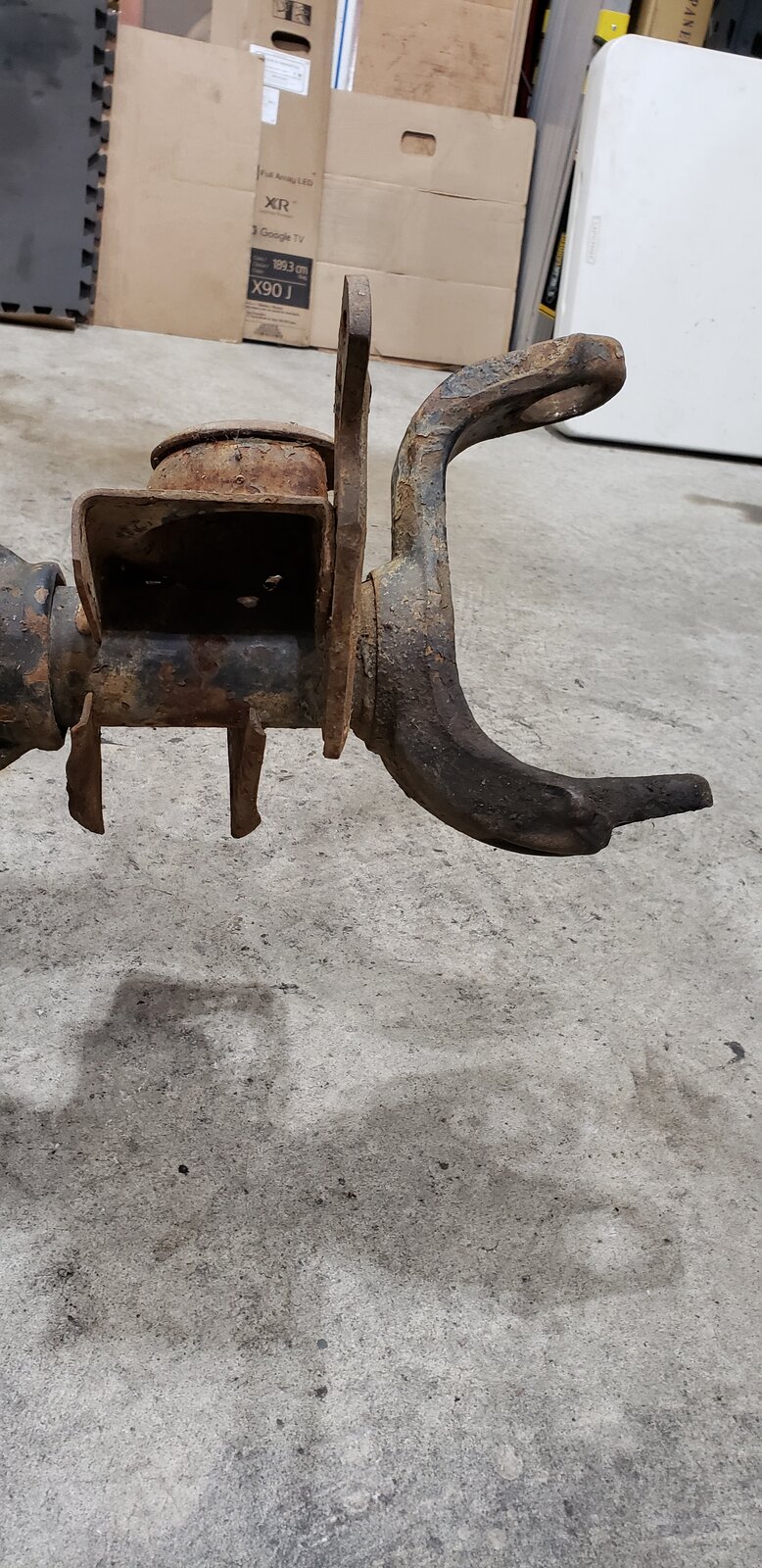

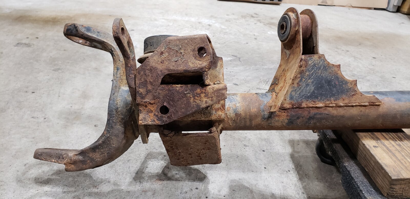

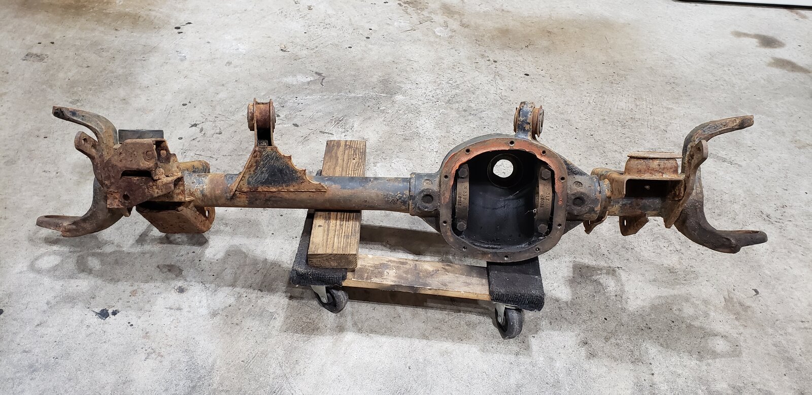

I met up with a friend of mine yesterday and picked up a HP housing. It's clear this one didn't lead an easy life, but the price, free, was right. I verified it is straight and that the bearing caps belong with the housing. The lower control arms will need to be cut off and replaced, and I'll have to reinforce the track bar bracket. That looks like it was torn and then welded. It also looks like the passenger side upper control arm mount was reinforced at some point.
I'll need to verify that there are no issues with the ball joint holes, remove the upper control arm bushings, then dig into the cleanup work. Fortunately the rust isn't bad and, since I'm waiting on an eLocker, I'll have time.

Good find for the right price. How were you able to verify it was straight?

Maybe not perfect, but I did three things (after cleaning out the tubes):
1. Put it up on jack stands and did a visual sighting through the tubes
2. Inserted a length (longer than the hosing) of 1 1/2 pvc pipe in one end and out the other.
3. Used a large framing square on the long side
Pretty easy to do with an empty housing. Look through one end and line up the circles so they are perfectly concentric or centered in each other. You can't do it on a bent housing.
I saw you mentioned that before and that's exactly what I did! (y)

It can't not work. That and get the Iron Rock Offroad lower control arm mounts. I'll send over the cover plate for the front of the stabilizer and track bar mount that ties them together. That will at least reinforce the front side.
If you haven't done lower mounts, I have a very simple and effective way to get them where they go.
The Iron Rock lower mounts have been ordered.
The stabilizer and track bar cover plate would be awesome, thanks!
When it comes time to install the lower mounts, I'll touch base on the simple method to properly locate them on the housing!
