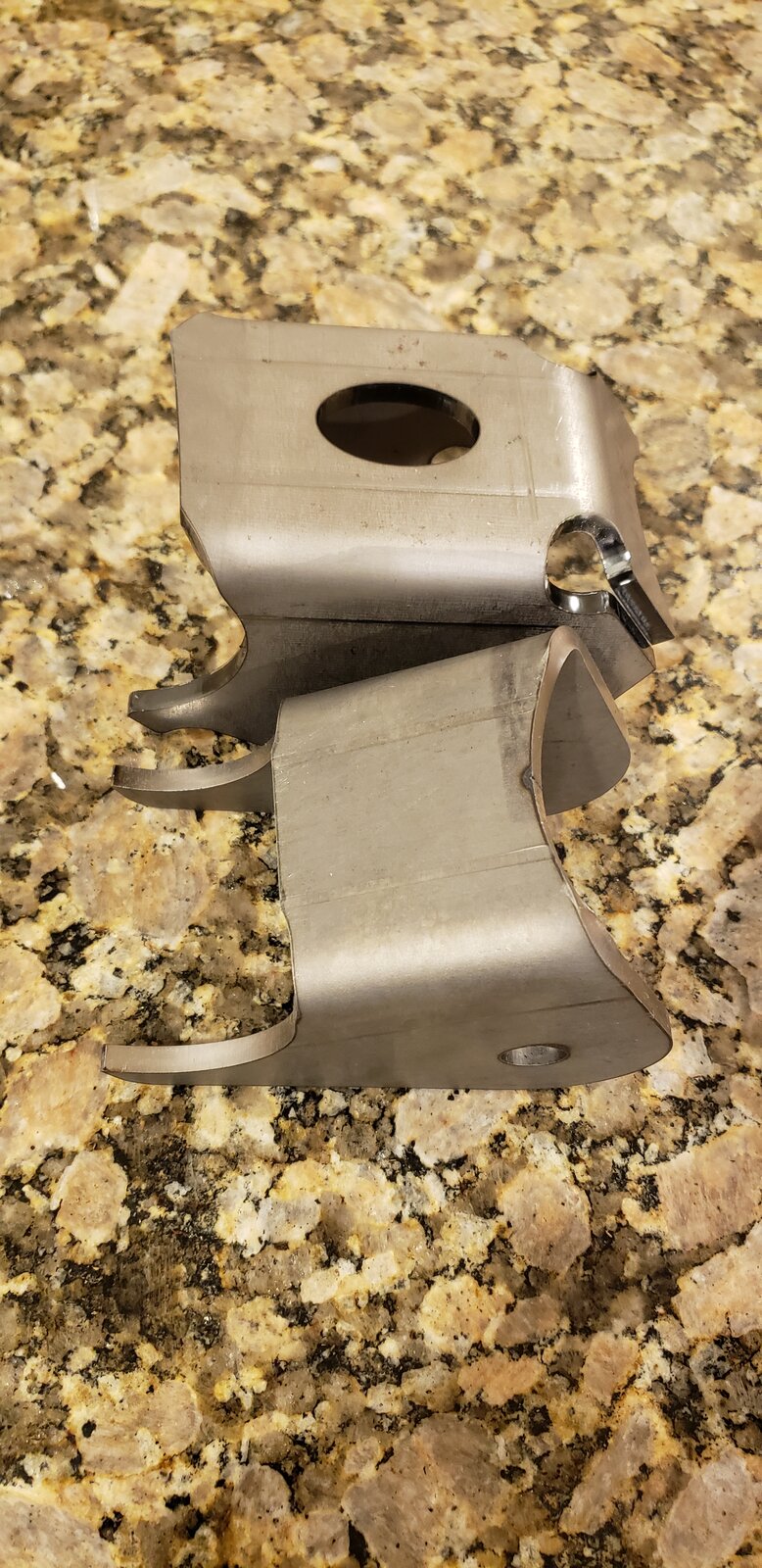

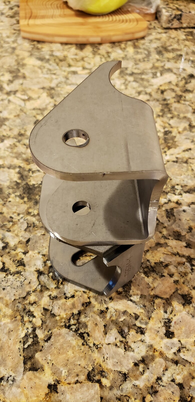

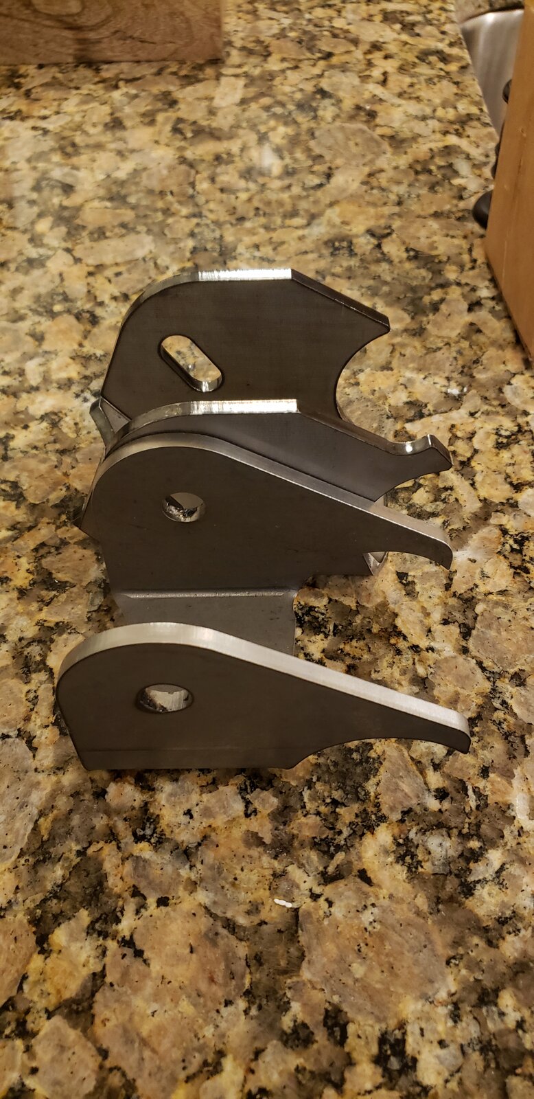

This is a case of you don't know, until you know. Blaine has repeatedly mentioned Iron Rock lower control arm mounts. Here's why. The picture below shows a Artec (top) and Iron Rock (Bottom) mount side by side. The Iron Rock mount follows the same basic angle as the factory mount. The Artec version doesn't. What this means is the Artec mount much larger surface area and angle will get hung up on rocks, while the Iron Rock mount will allow the vehicle to slide across. The rest of the pictures tell the story better than me!
Those new mounts are nice and clean. I guess with Artec bigger with more angles is better.

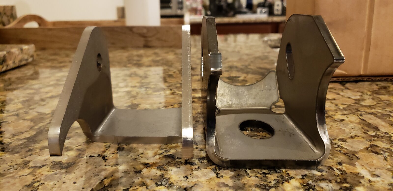

Are the slotted holes for when you don’t get them positioned correctly or when you get warpage from welding?
Like Blaine said, this particular bracket is for use with stock bolts. Besides the hole, the bracket is identical to the non-slotted version.

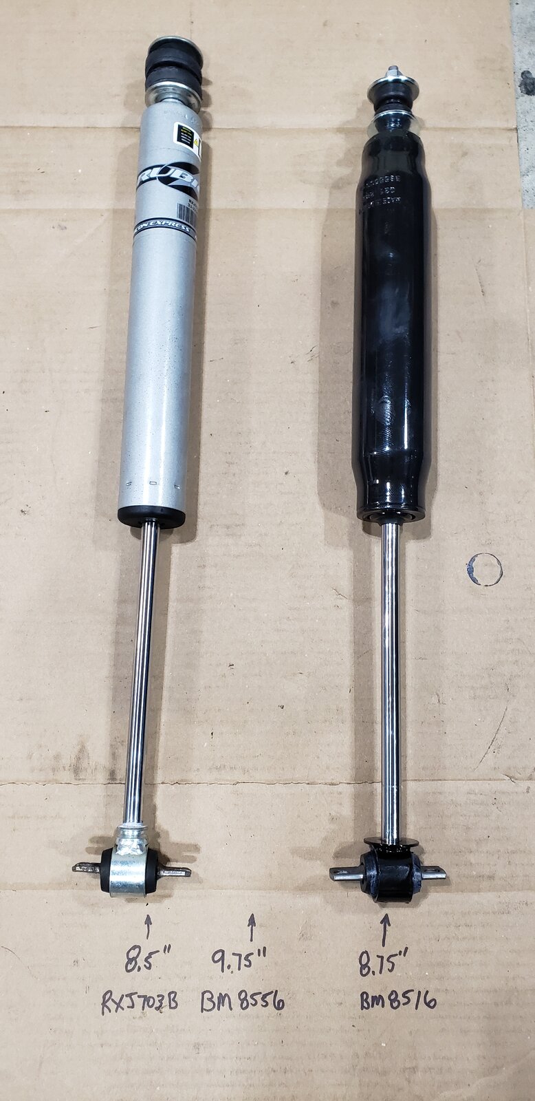

In the process of swapping out the Black Max (BM) B8525 shocks and installing the B8516s, I learned something else. Since I also was pulling the Rubicon Express (RE), i.e. Bilstein, RXJ703B shocks off the LJ I decided to set them side by side for a comparison with BM. While the RE shocks were roughly the same extended length as the BM 8525, the BM shock had an additional 1.75" of travel. This intrigued me, so I also compared the BM 8516 shock to the RE and got an even better surprise. While the BM 8516 was considerably shorter than the RE RXJ703B, it had 1/4" more travel!
So what did I learn here? Basically that the design of the BM shocks does what they claim, i.e. yields more travel than a comparable gas shock. To be clear, I'm not saying it's better, but that what they state is true, given a properly set up vehicle.

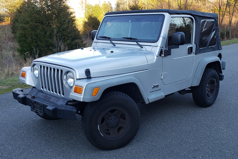

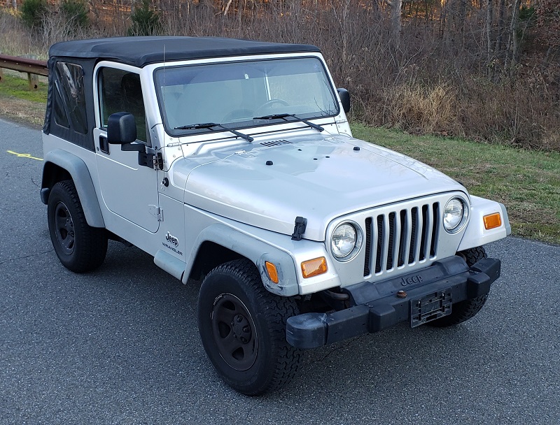

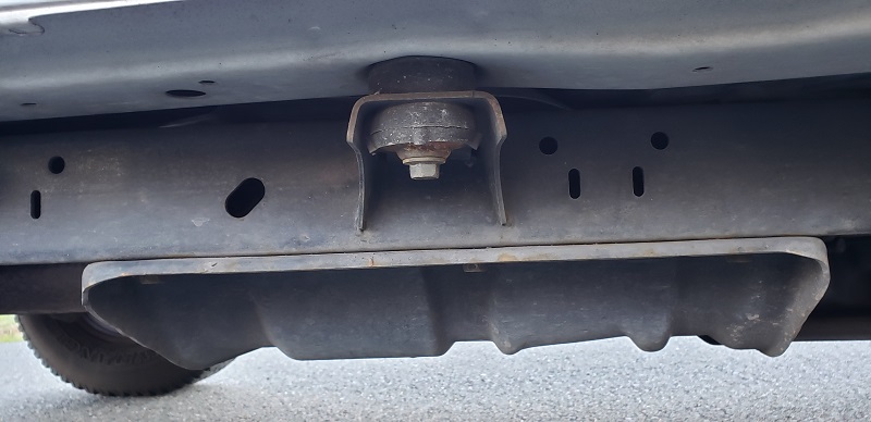

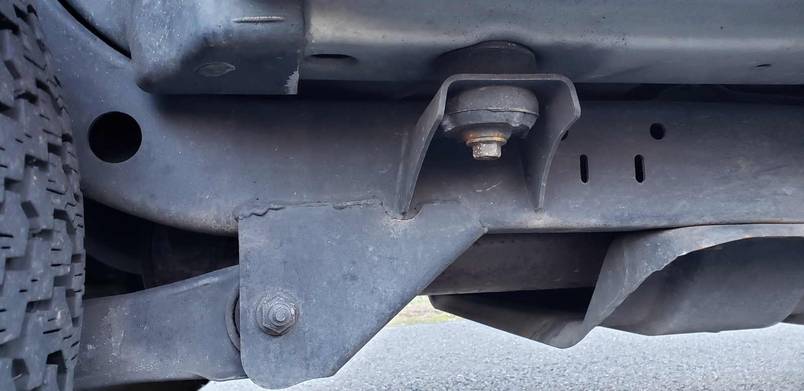

I picked up this bare bones Sport for a very good deal. It has has 180K on it, but is 100% rust free. After bringing it home, here's what I found wrong with it:
- front pinion seal is leaking badly and there's a growl coming from it (Needs a pinion bearing and seal)
- has a P0135 code (The OBDII connector wasn't working when I got it, but I cleaned the plug and was able to read the code)
- rear main seal is leaking (slightly)
- valve cover gasket is leaking
- rear pinion seal (Dana 35) is damp
- u-joints are all original
- jack and jack accessories are missing
- rear seat belt is broken
- both visors are missing
- washer bottle pump is inoperable
- battery tie down is missing (you can see where the + terminal contacted the fender a time or two!)
- driver seat is worn/torn
- bad blower motor resistor (Fan only works on high speed)
- soft top is done

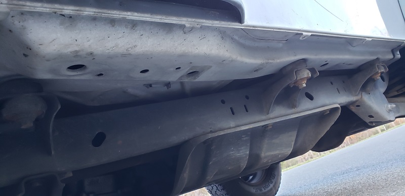

Other than that, it runs and drives well. It looks like the cooling system was recently replaced, as well as the alternator. Also, the 42RLE appears to have been rebuilt back in 2012. Given how absurdly rust free it is, I'm going to build this one based on lessons I've learned from the past. Per the title, the theme will be keeping it light and nimble. Since I plan to drive this daily, tire size will be limited to 31".

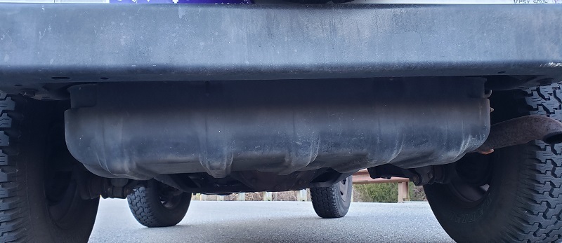

- Savvy gas tank skid

As for the Jeep, here's what it looks like now. The only real options are A/C, full doors, and automatic transmission.
View attachment 214670View attachment 214671View attachment 214672View attachment 214673
That's the difference in the floating piston and nitrogen charge. That stuff takes room in the body, which restricts available travel.

Do you know the compressed length of the 8516 (I know you take good notes)? They give a different travel number than the one you list and if it's shorter than the 13.54" spec that would be great for me.
