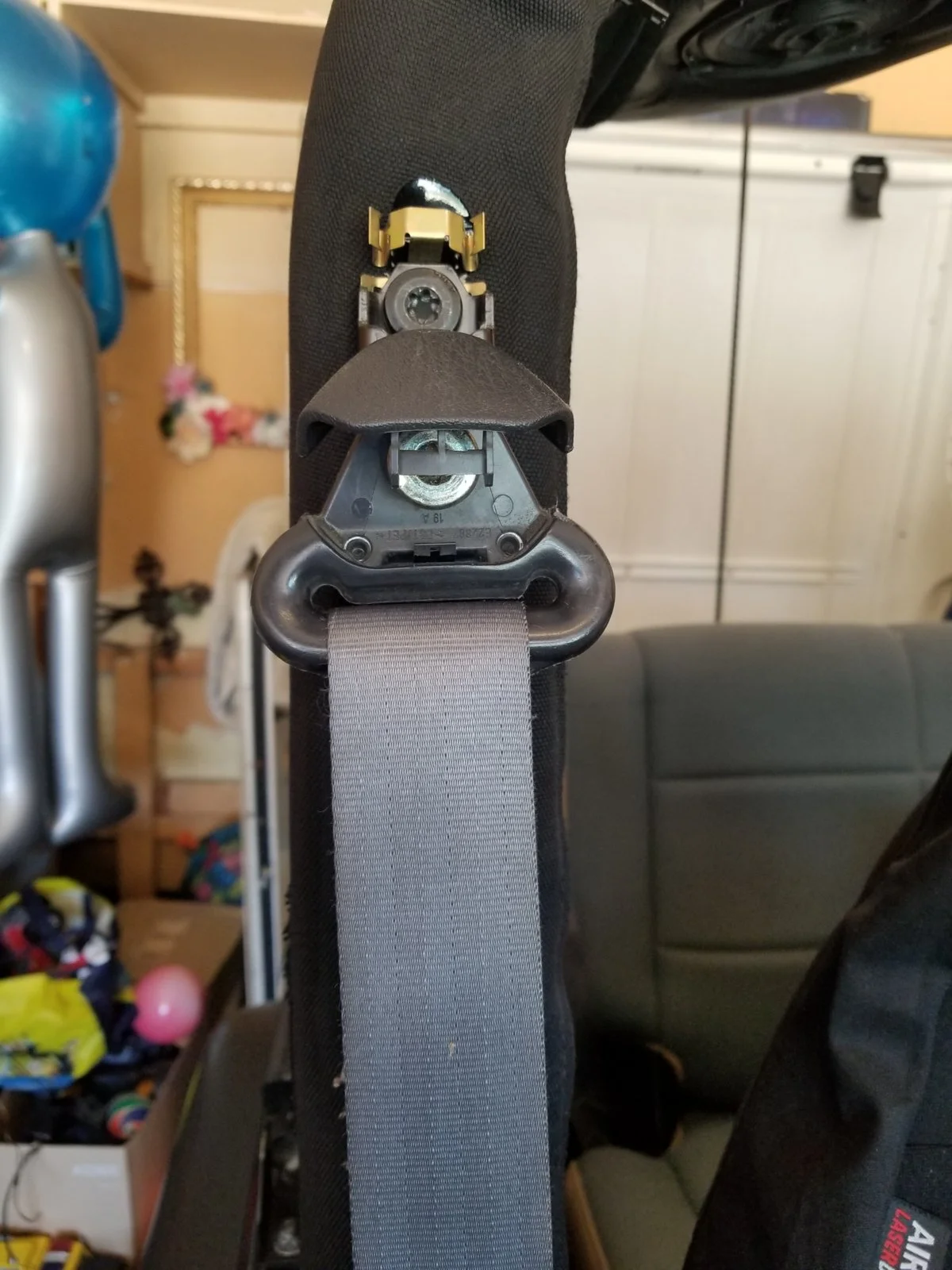

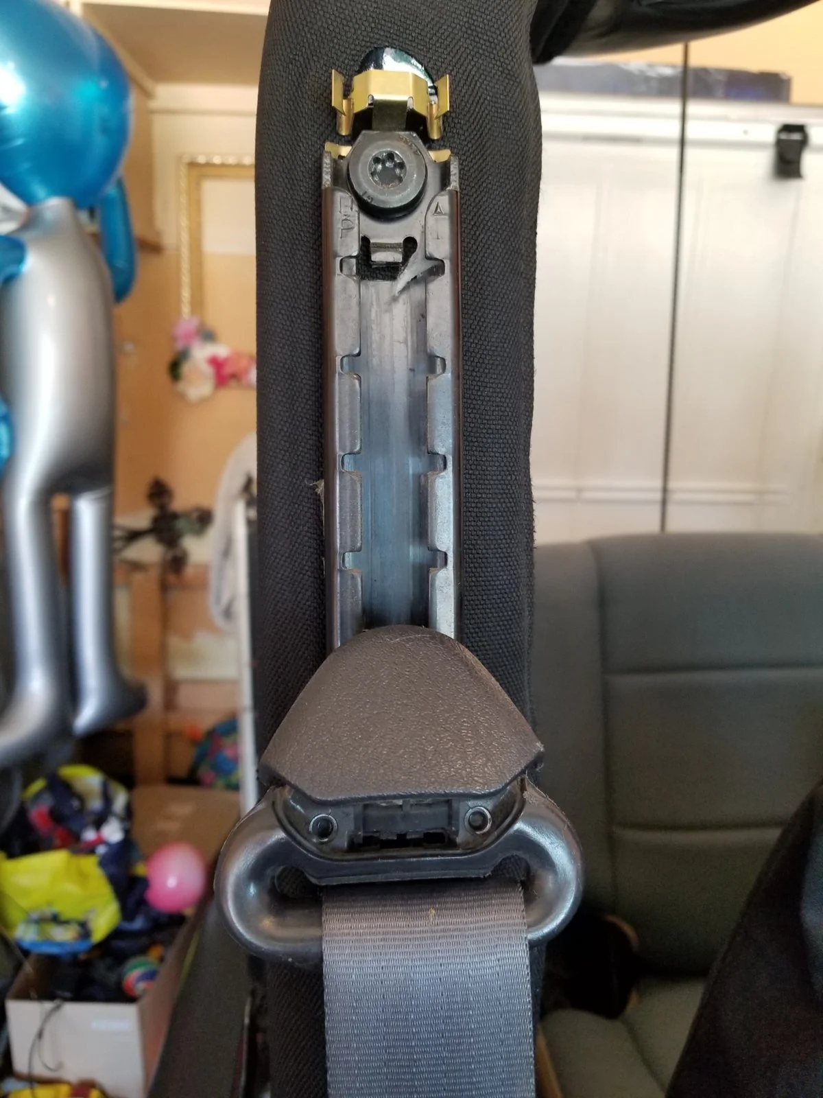

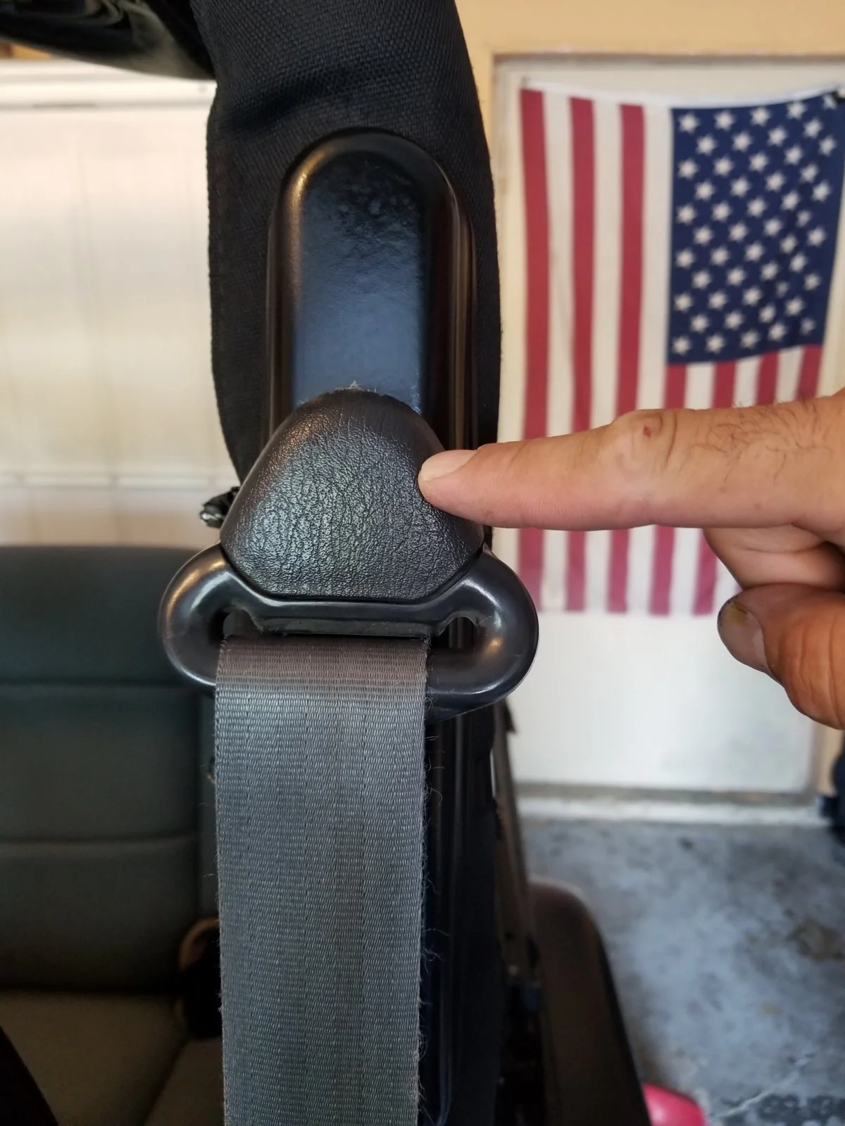

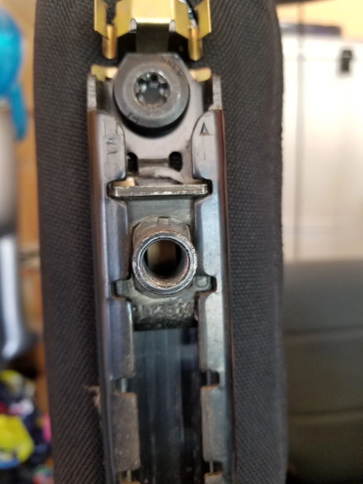

While I was reinstalling the front seat belts after painting the roll bar paddings, I was not aware that we can adjust the height of the seat belt. By pushing the seat belt bracket inwards, you can lower and raise the height of the belt :beer-toast1:
