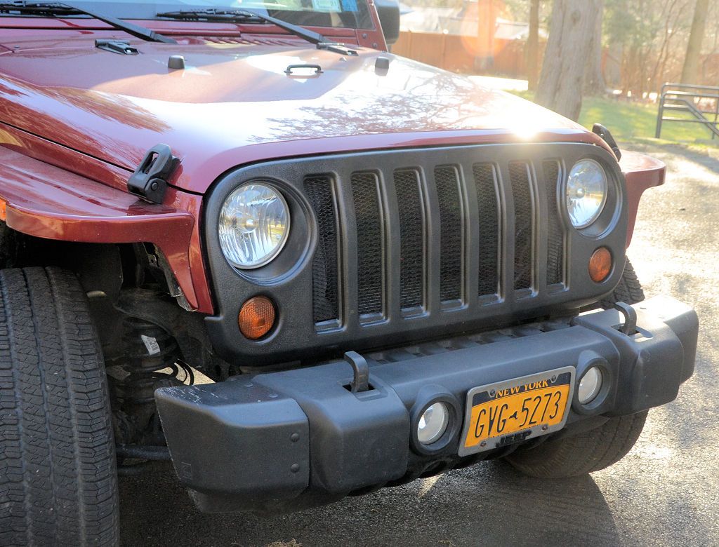

It's all about the tooling cost - if the shape of the fender is such that the part can be thermo-formed, the cost of tooling can be fairly reasonable. I recently did a JL-style grille for the JK and was able to arrange for it to be manufactured by thermo-forming and the tooling cost and per-unit cost was low enough that small production runs (25 parts) are possible (photo below).
If the shape requires injection molding, the molds would cost a lot more and it's likely that would only be cost-effective for large production runs.
Molds for fiberglass parts are pretty reasonable, a good rule of thumb is that a mold for a fiberglass part, assuming a quality master part exists for the mold to be made from, is that the mold will cost about 5x the retail cost of the part that will be made in the mold. At that cost ratio, fiberglass is practical for very small production runs (10 parts).
Ever since I did the CJ Grille Kit for the TJ I've had in the back of my mind that I would make a highline kit - I've got molds for TJ inner fenders, flat fenders, CJ fenders and related parts and those would provide a good starting point for making highline versions.
A thermo-formed JL-style grille for the JK:
