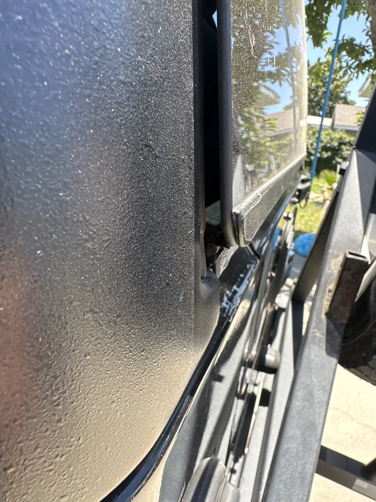

I inherited a 2004 X and the rear window struts were blown out. Ordered the most recommended ones on here but it appears as though the struts are like .5” too long. Not sure where to find a strut that will work and is only about 14” long.
Why do you think it’s too long? If you’re putting new cloth on it’s going to be tight. Some pics would help us help you.
It’s a hard top and there is like a half inch gap on one corner of the window holding it open.

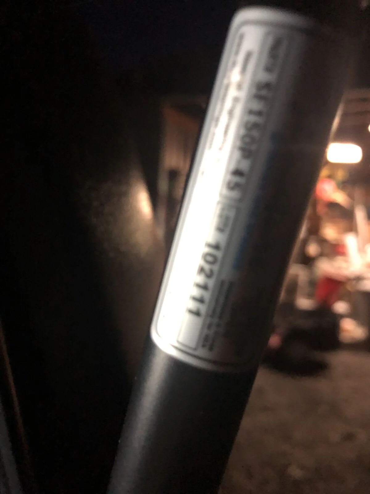

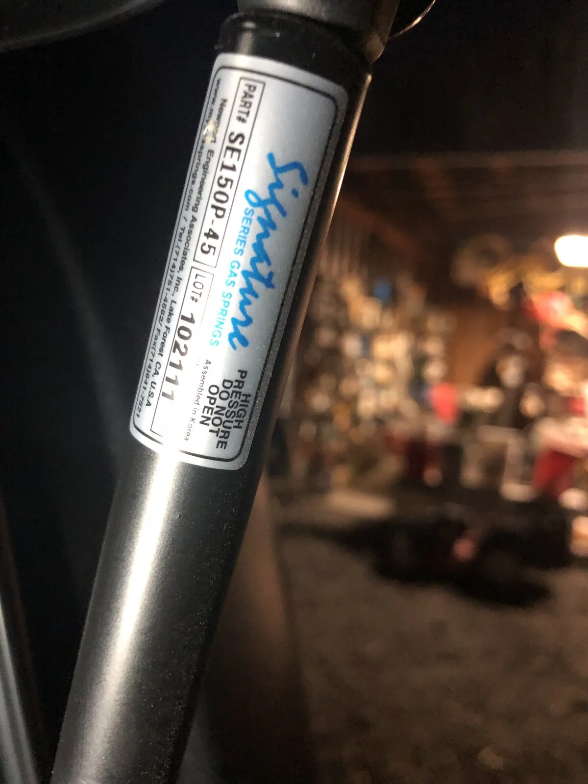

What part number is on your struts?

I would but I can’t find any info on it. I’m assuming it was painted at some point and they covered any numbers that may lead to a manufacturer.
Something else may be keeping the window from closing.
Did you look inside and confirm that the strut is fully compressed?

For some reason I had softtop in my head. Glad you posted the pic to clarify for me.
no problem. I know I should have mentioned it since the X came with a soft top.

struts are fully compressed
Have you compared the old and new struts side by side? Strut length is measured center to center of ball joints at full extension. The other spec is the lift capacity of each strut.
Can you loosen and adjust the strut hardware for the extra length? If one side fits I'd try to make the other side identical
