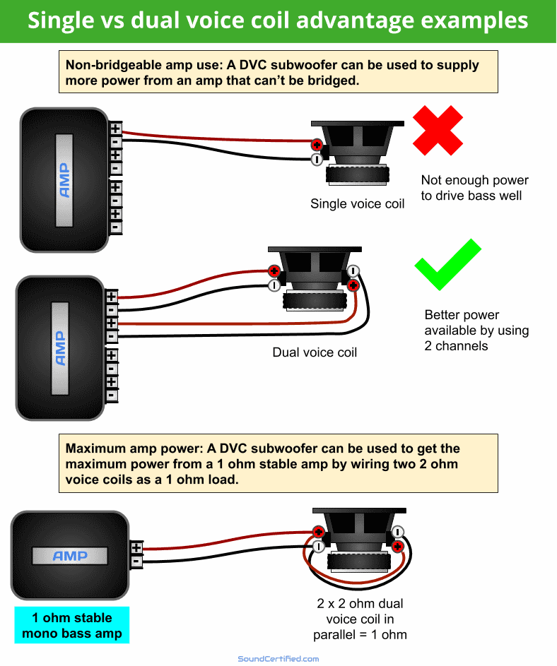

So because you have never seen it means the most common method is what you have seen? Here is a picture so you can can visualize.

We’ll be clear: A single voice coil subwoofer isn’t “better” than a dual voice coil sub, or vice versa. The only benefit of a DVC sub is that the coils can be wired in series, in parallel, or each can be fed directly to an amplifier channel. There are benefits in terms of installation flexibility, but the number of connections to the voice coil doesn’t improve the driver’s performance or sound quality.
https://www.bestcaraudio.com/subwoofers-and-amplifiers-lets-talk-about-ohms-and-loads/

The reason wiring each voice coil independently is not as commonly seen as Series/Parallel wiring is generally a subwoofer or multiple subwoofers, when used in car audio, is/are powered by a mono-amp. A mono-amp has only one channel so Series or Parallel wiring must be used, and a DVC sub gives you a wider range of amplifiers to choose from.
