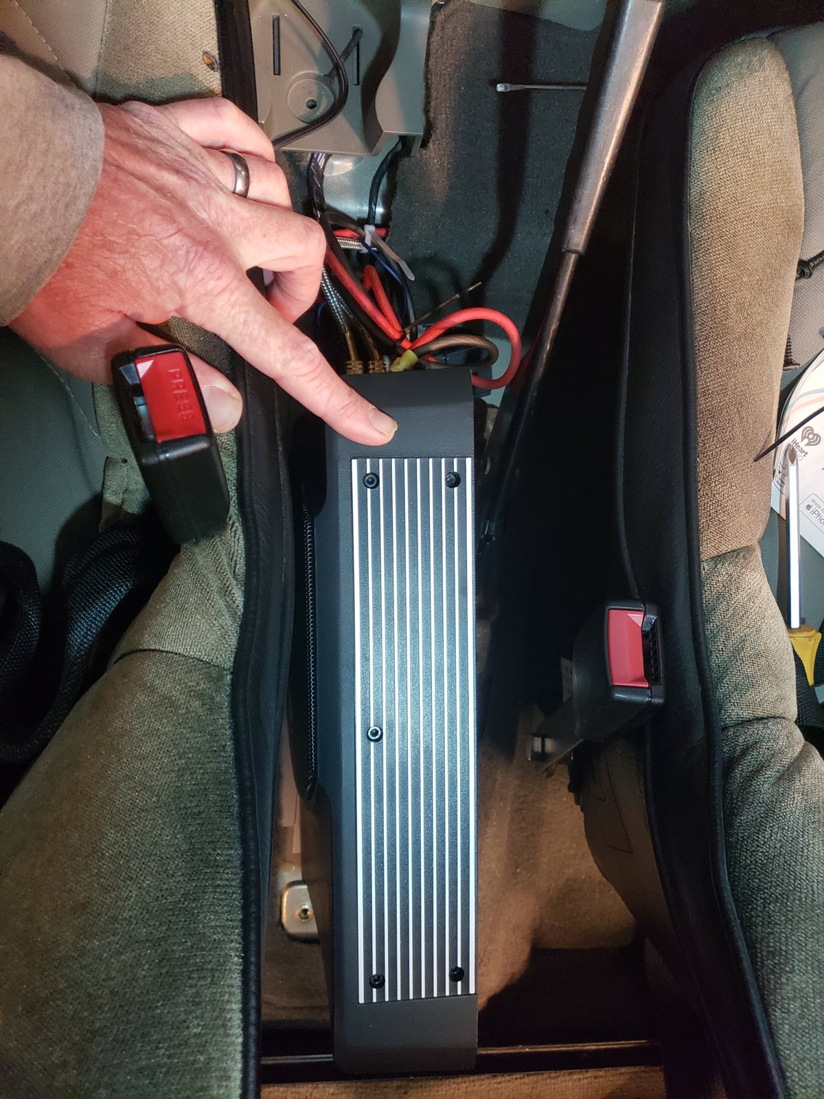

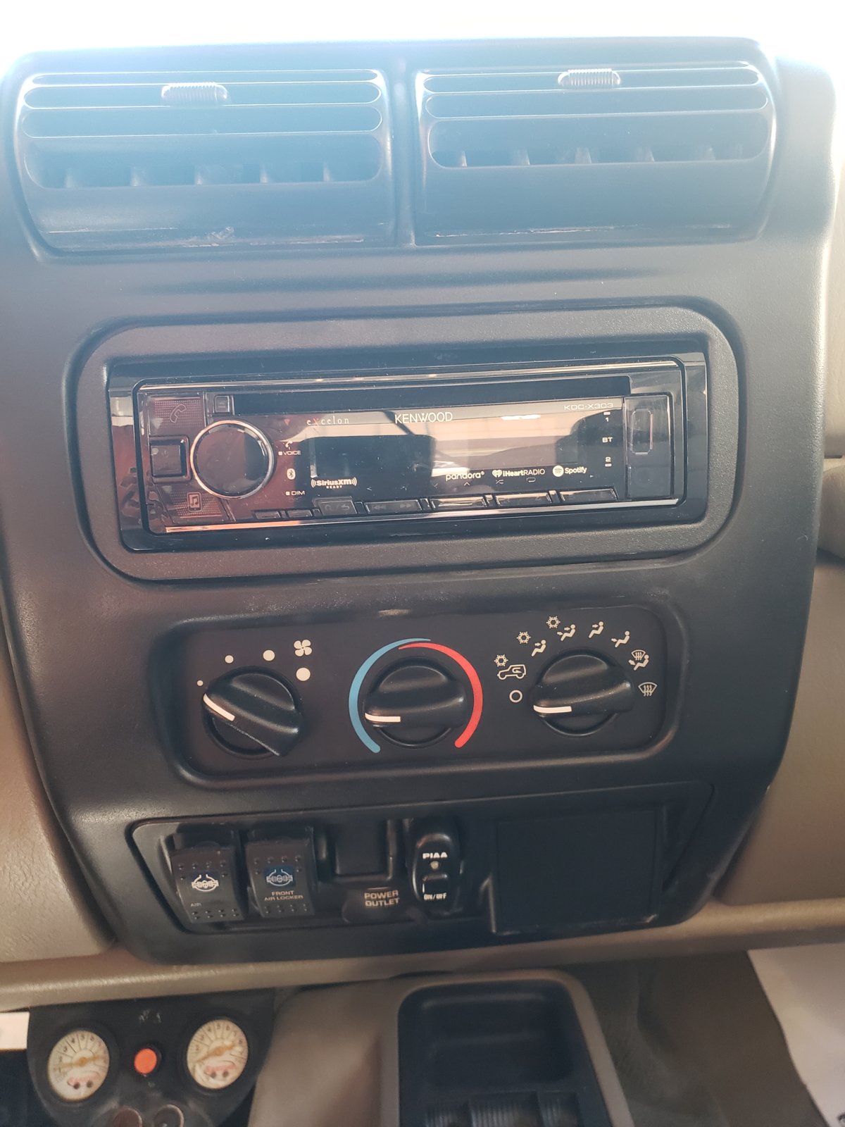

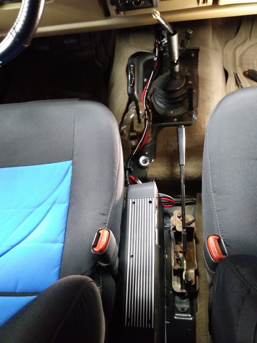

I installed the Sound Ordinance suggested by fourpointzero. Sounds great, fits in console. Upgraded deck, bolted in Polk audio marine grade speakers in factory locations. 4 speakers, deck, sub - GREAT UPGRADE $392!!!
Spend the $18 on the amp wiring kit from Crutchfield. Speakers and deck come with factory harnesses, and deck mounting plate.

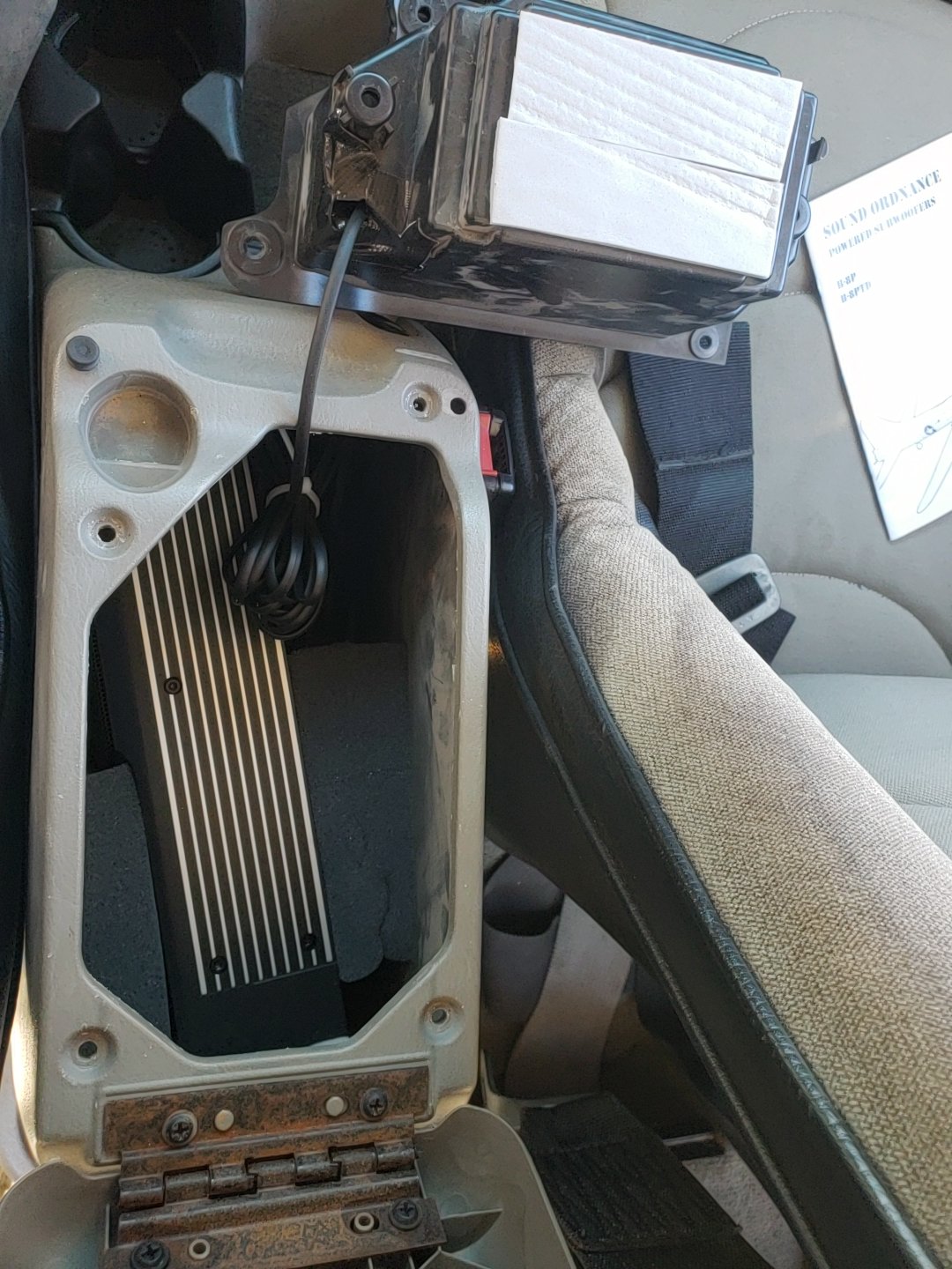

Here are a few pics.

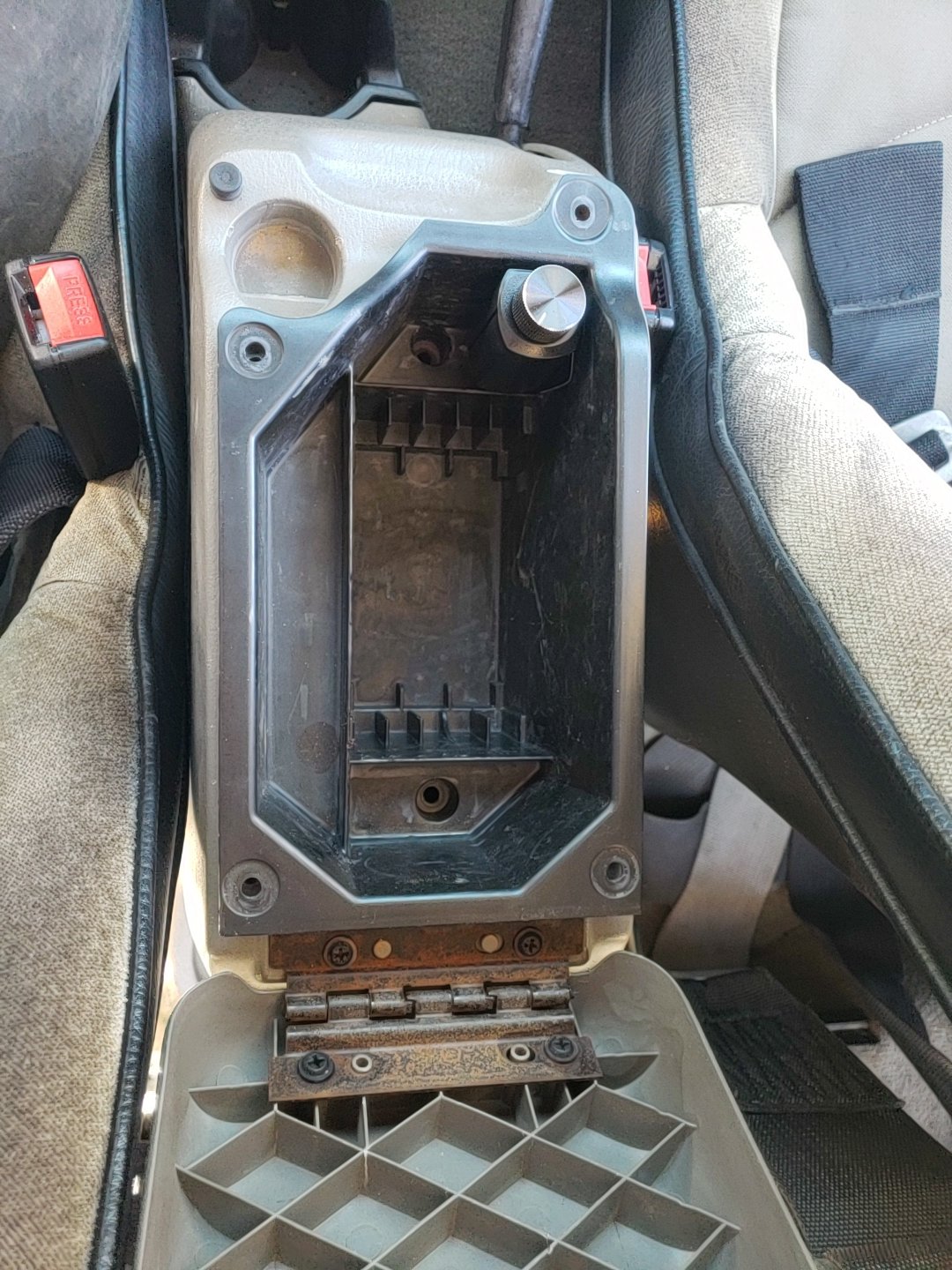

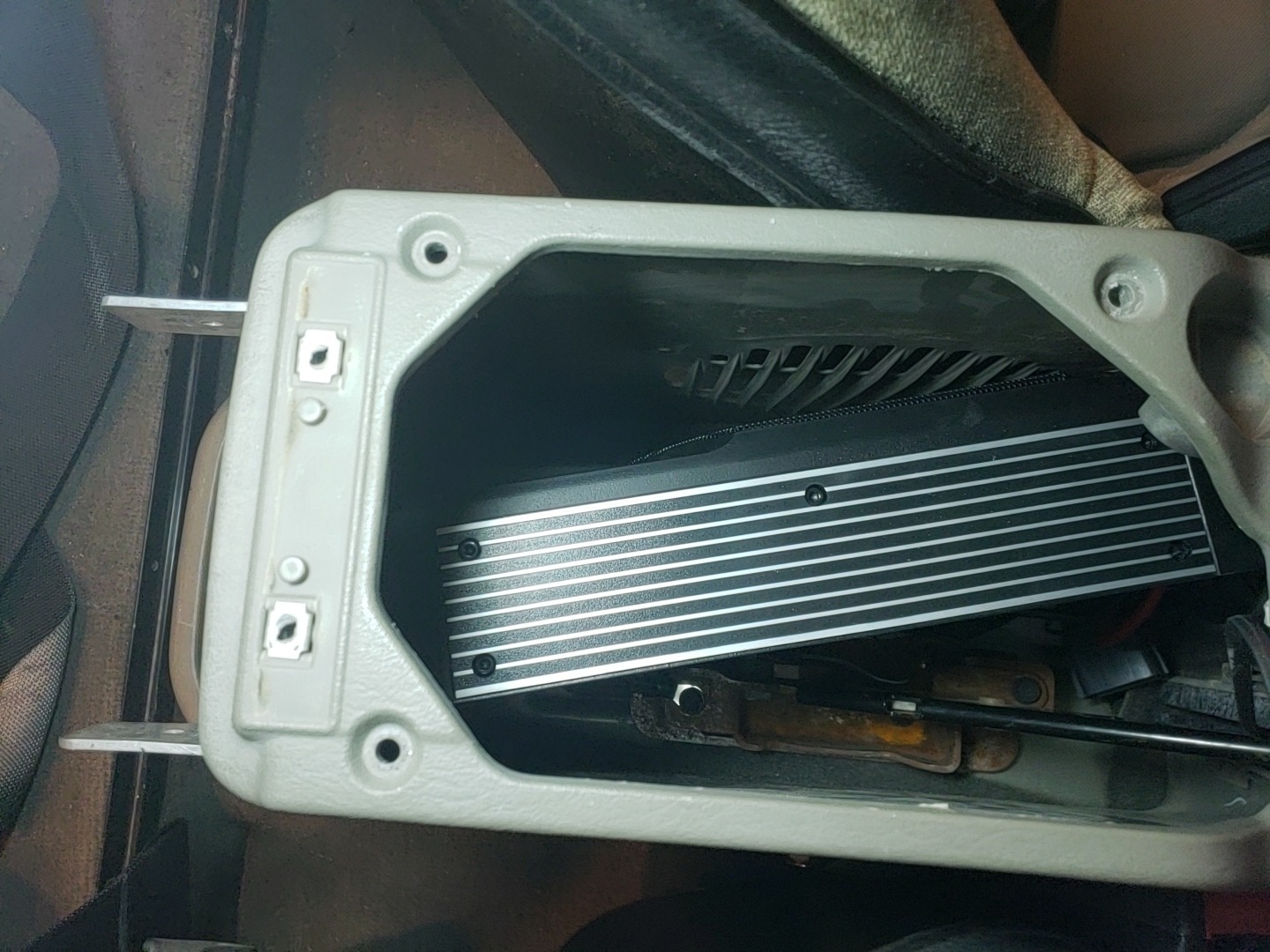

Thank you for the helpful pictures! How did you go about modifying the center console over the Sound Ordnance sub?

With console removed I popped out the rivets from the inside to remove the tray then simply set it on top with some adhesive weather stripping on the bottom so that it wouldn't rattle. It stays put well and is removable to check connections or stash something slightly out of sight.
I ended up drilling through the rivets and putting the tray on top as well. I have not used the weather stripping, but that would be a good addition if I do notice it rattling.

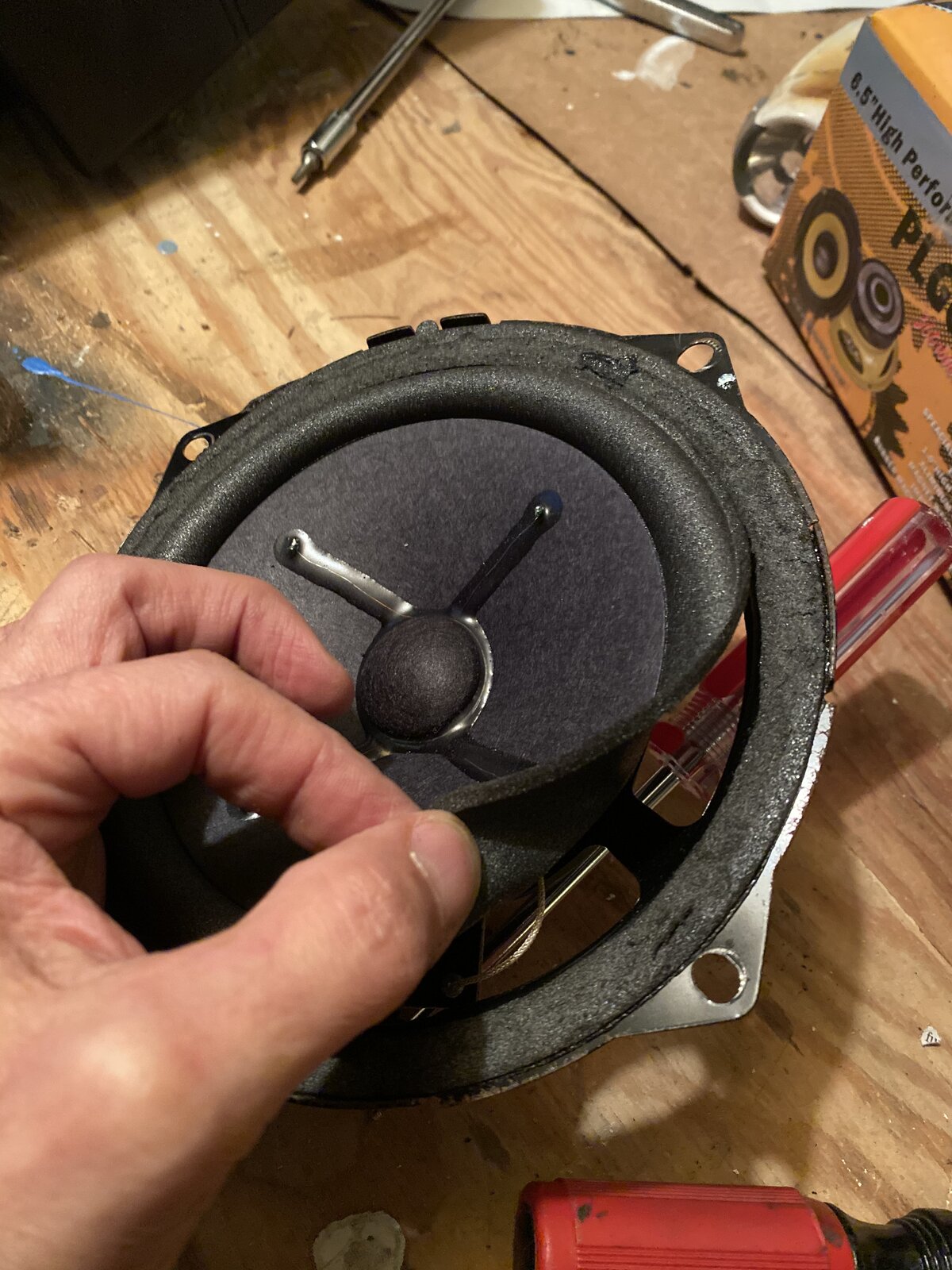

It’s just a bit taller and smaller in diameter but with a little DIY elbow grease you’ll be back in business.
Pyle 6.5 Inch Mid Bass Woofer Sound Speaker System - Pro Loud Range Audio 300 Watt Peak Power w/ 4 Ohm Impedance and 60-20KHz Frequency Response for Car Component Stereo PLG64 https://www.amazon.com/dp/B000FMPENQ/?tag=wranglerorg-20

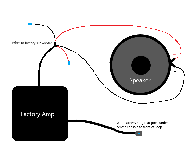

Hey-O! I was just looking at this speaker on Amazon thinking it would be a nicer fit than the OEM and Quadratec drop-in. Only thing is it's single coil but that just means you use one set of wires. I called Crutchfield and asked about Bi-amping the factory amp - they told me it would be fine. Basically just use one wire from each side and cap the unused wires. Rudimentary picture below showing how it would be wired.
I haven't pulled the trigger yet but was wondering how you got it to fit seeing as you mentioned it's not 100%.
*edit* - After taking a closer look at the pictures of the sub, I see what you meant by it not being an exact fit. Looks like you have to drill some pilot holes which is no big deal. Placed an order and bought foam tape to make sure everything is properly sealed.

IT looks like that's a dual-voicecoil woofer in your diagram, but the amazon page seems to indicate it's a single voicecoil woofer. If it's a dual, you need to wire both voicecoils, either in series or parallel. This is actually why they're designed that way: with a dual 2 ohm voicecoil, wiring them in series = 4 ohms, parallel will give you a 1 ohm load.
I fixed the image. Can't believe I missed that. Thanks!
The factory amp only has two wires and not four, you can run a single voice coil sub with no modifications.
Edit: for what it's worth I don't think dual voice coil subs should be run on two channels, they will fight each other, the dual configurations is just to allow you to run the speaker series or parallel to give you different impeadence options but whatever floats your boat
Every video and picture I see of the factory sub shows two terminals (one on each side) with a total of four wires being used (two for each coil).
