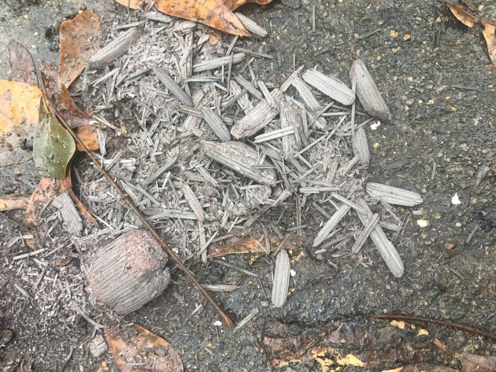

For future googlers- here’s what mine looked like when I pulled them, and the chunks of catalyst afterward.

Just a heads up- if you haven’t already checked, my front cat had completely disintegrated and was blocking the main cat. It was robbing me of power.
Worth a look. Annoyingly, there is no way to remove the cat without hacking the exhaust apart between the pre and main cats.

My pre cats went south, "as scheduled" at 104k.
I had to replace them to satisfy emissions.
I got the Evan Fischer exhaust with 2 precats.
Solved my 0421 and other 02 sensor codes.
