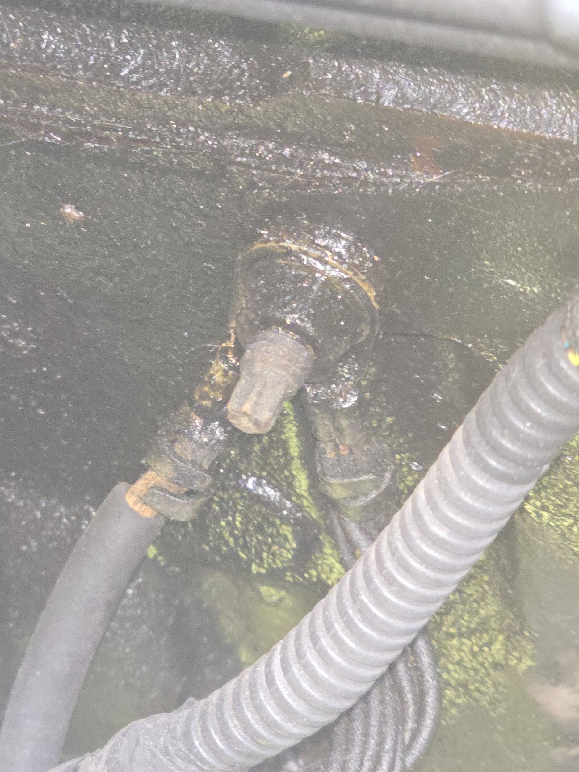

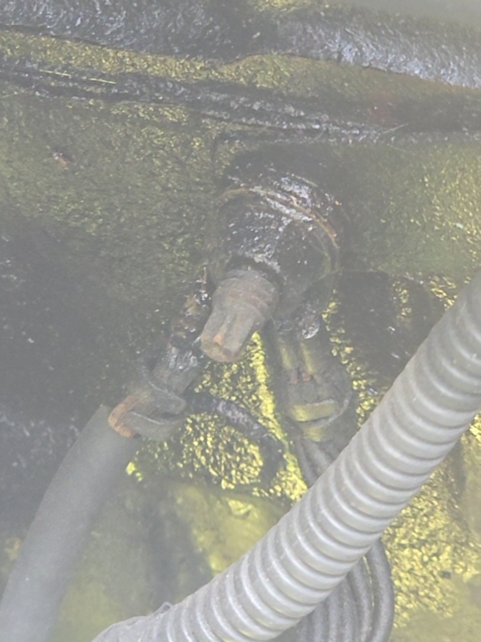

If you want to throw a Hail Mary, remove and clean G105 at right rear of engine block. The PCM uses this ground which could explain the O2 codes and computer control ground for an intermittent injector. And the cam shaft sensor also uses this ground.
I could nit pick this all day, but it’s quick and easy. If it doesn’t resolve the issue, further troubleshooting would be required.

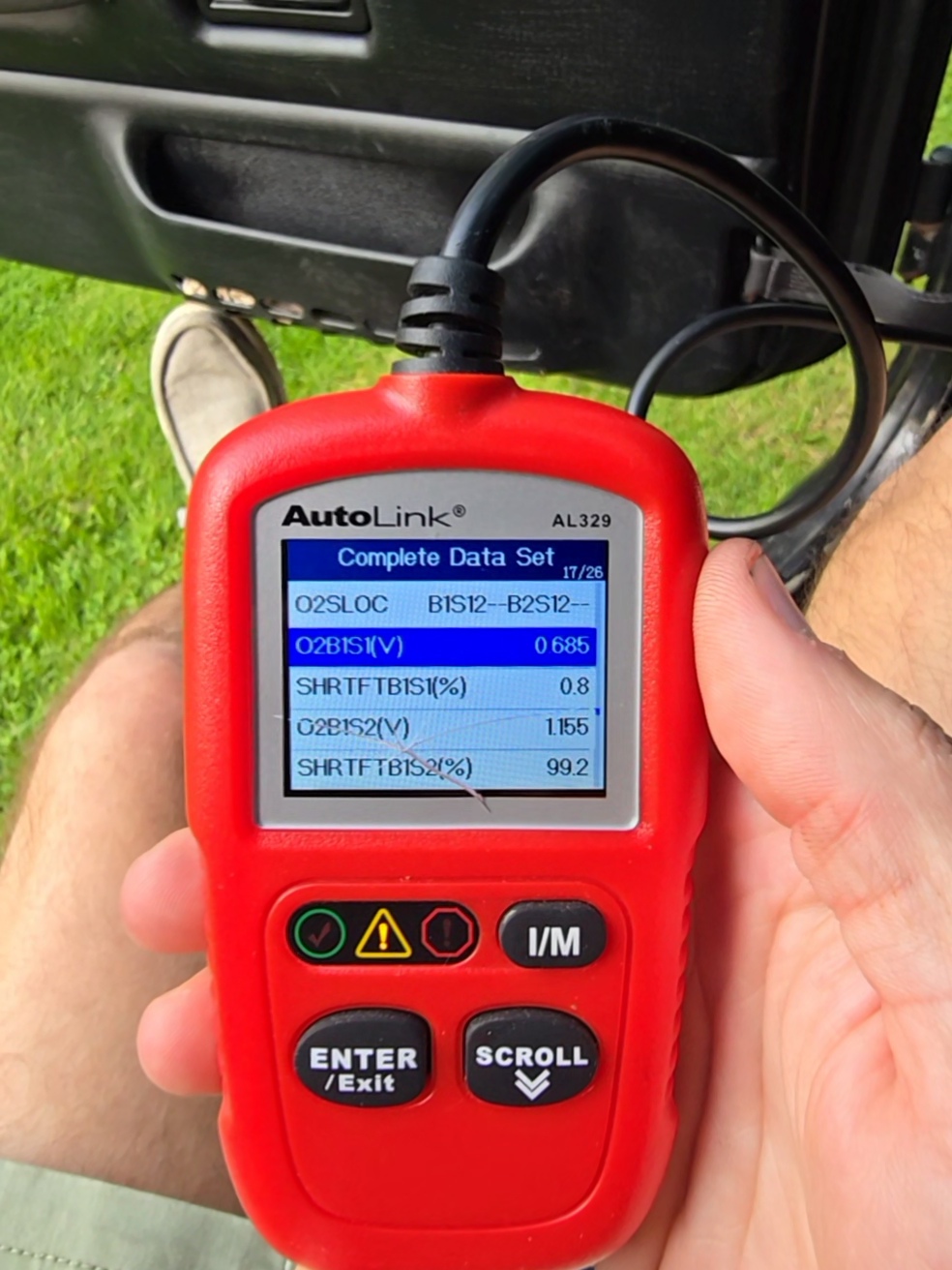

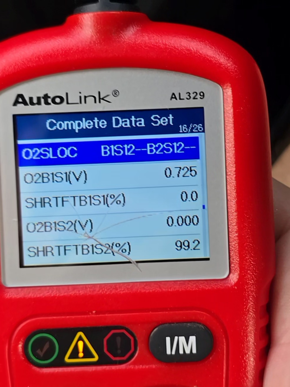

So i cleaned G105. As it was pretty much fully covered in oil. Test drove 10 mins and no CEL. Didnt even idle rough at operating temp, nor smell like its running rich. Although I still think Bank 1 sensor 2 is shot. At least i think that's what the limited live data shows? Not getting any voltage to it. Bad sensor or wiring?
With the key in the run position and engine off, unplug the sensor while watching live data and see if O2B1S2 Volts jumps to 5 volts.
Will do. Just did another test drive. 30 mins this time. No issues at all. No CEL. No rough idle. Did check live data again, and now that B1S2 has voltage but constant above 1v compared to the ~.7v of B1S1.
Do the unplug test when the sensor is cold or it won’t show 5 volts. But, if the data you took pictures of is LIVE data and not freeze frame data, then it’s getting stuck both rich and lean positions. Replace the sensor.
Yes it was LIVE. Already have a new sensor coming in Thurs
Scratch that. The unplug test won’t read 5 volts. I’m thinking of old non-computer control o2 heater circuits. Yours is computer controlled and that won’t work. There’s ways to test the sensor forcing rich (carb cleaner in intake) and lean conditions (creating vacuum leak) while monitoring signal voltages, but honestly being that it’s stuck in both rich and lean positions, it’s a really good chance it’s a sensor and not a circuit issue.

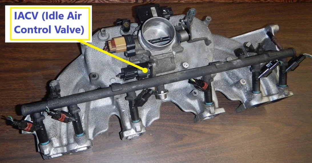

I have a 2004 TJ with 4.0L with a manual 5 speed tranny, it has about 170k miles on it. Symptom's: initial problem was random CEL (Check Engine Light), usually steady, but later would flash at times with jerky acceleration. Code reader gave cylinder 1 misfire that later became cylinder 5 misfire. During acceleration, engine would backfire into the breather, so I thought it was a gas/air mix ratio problem. New spark plugs had no effect on fixing the problem. With the engine running, I could hear the fuel injectors clicking by placing a long screwdriver on each injector and the handle on my ear. I disconnected and did a resistance test on all of the fuel injectors, all of them read 13.7 ohms. I saw a message that the IACV (Idle Air Control Valve) can cause all these problems, especially if stuck open or stuck closed. I removed the IACV and found lots of carbon build-up. With the engine off, I pushed the throttle butterfly fully open and looked inside the intake, it was also caked with carbon. GUM-OUT cleaner was sprayed heavily throughout the intake and IACV passages, I also used a toothbrush to scrub some areas. I disconnected the battery (for about an hour) while I installed a new IACV. Once everything was back together, I started the engine and the CEL remained off, went on a test drive and the CEL remained off. As I understand it, disconnecting the battery resets the ECM (Engine Control Module) so it has to learn where to set the new IACV during start / idle / acceleration and steady driving. It appears the IACV is a jack-screw type valve, a dual direction electric motor extends or retracts the IACV plunger, which varies the gas / air mix ratio based on engine temperature, but adjusts for power demands too.
