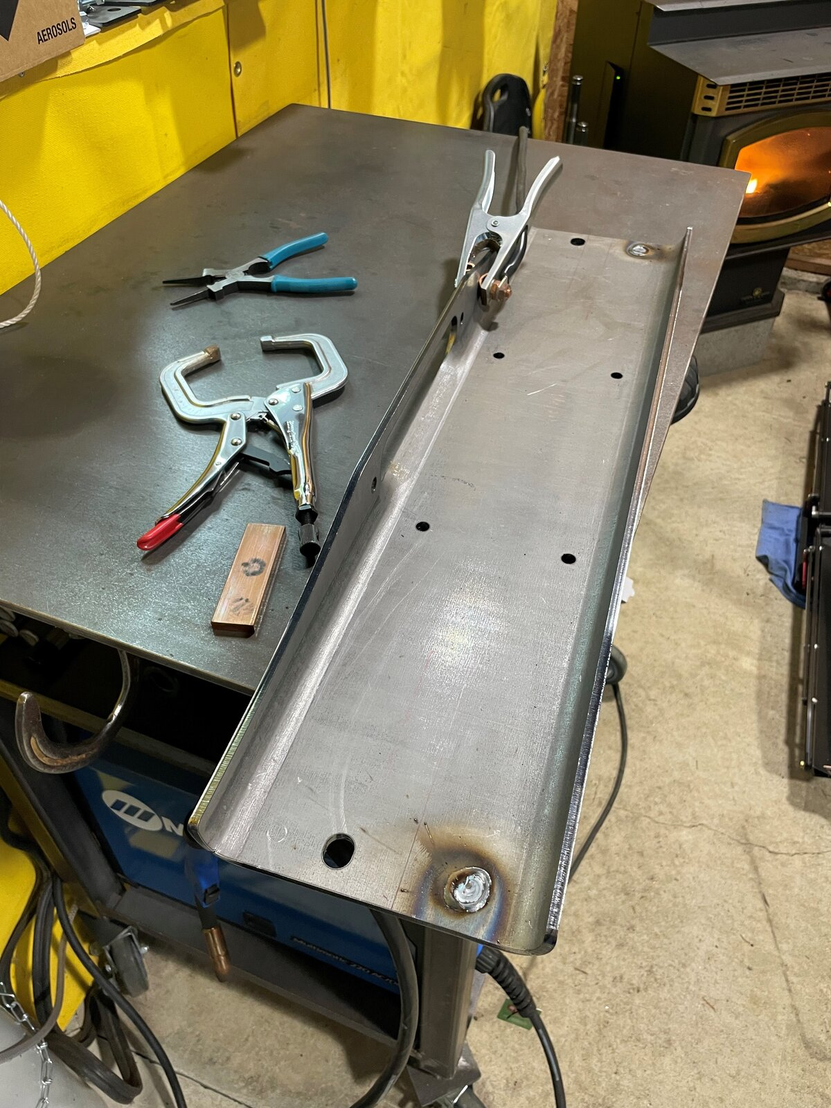

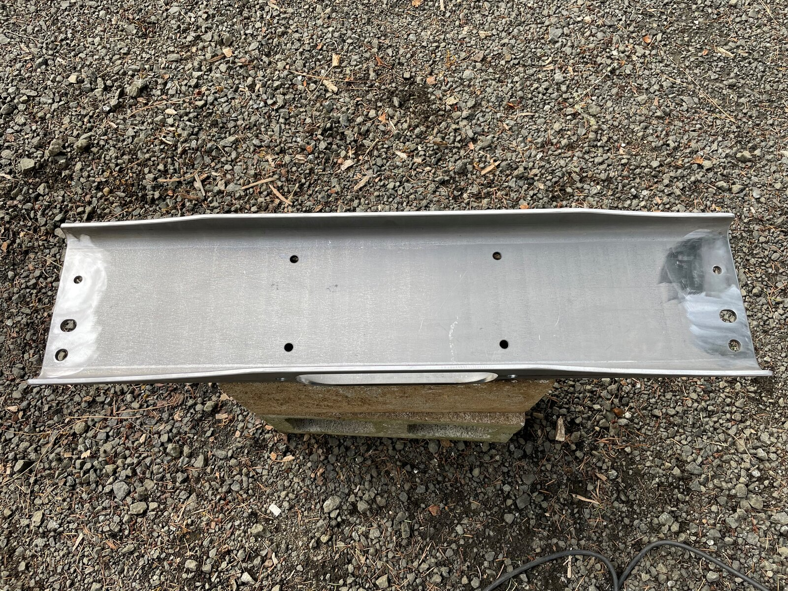

I need to fill this hole in my rocker guards. Material is 3/16".
I'm trying to decide if I cut a plug from the 1/4" stock I have on-hand (I stupidly threw away the material I cut off the front of the guard last week...) and weld that in and then grind/sand it smooth or just go in and fill the entire hole with weld (a bit at a time to allow cooling to avoid warping).
Thoughts?

For plug welds, you want to fill it all in one go. If you can clamp that end down or bolt it down then that would reduce warping. It probably won't warp much.
Edit: should probably specify that don't clamp/bolt it to the Jeep
To clarify, this would be off the Jeep on a weld table.
Tracking the weld on the plug would be a single pass, or maybe two passes back-to-back to reposition to the other side of the guard.
Reactions: AirborneTexasRanger
I’d pull it off, put an aluminum or copper backer behind it, and weld it up. The time you’ll have into making a patch really isn’t worth it.
It's already off, should have mentioned.
I'm thinking this is the way. I figured it was time wasted to grind down a plug to fit the hole.
But, I'm just a guy with a welder very much learning so best to all advice than jump in the wrong.
With a backer, you’ll start at an edge and just start letting the puddle fill the hole. No flipping over, no reposition. Just fill the hole.
A backer is always the preferred method, but it can be done without one.
With no backer you might not be able to fill the hole in one shot. It might get too hot and fall out. In that case you could weld around the edge to make the hole smaller, wait for it to stop glowing orange then fill it in. Since you can access both sides this would be an acceptable alternative.
I did that moving some holes to make a YJ winch plate work
It was easy to do and didn't warp the plate.
Thanks all! I figured this was the easiest way to just fill the hole with weld.
I hadn't thought of aluminum backer. I was tracking brass being a typical use. Gotta see when I have around the house for a backer.

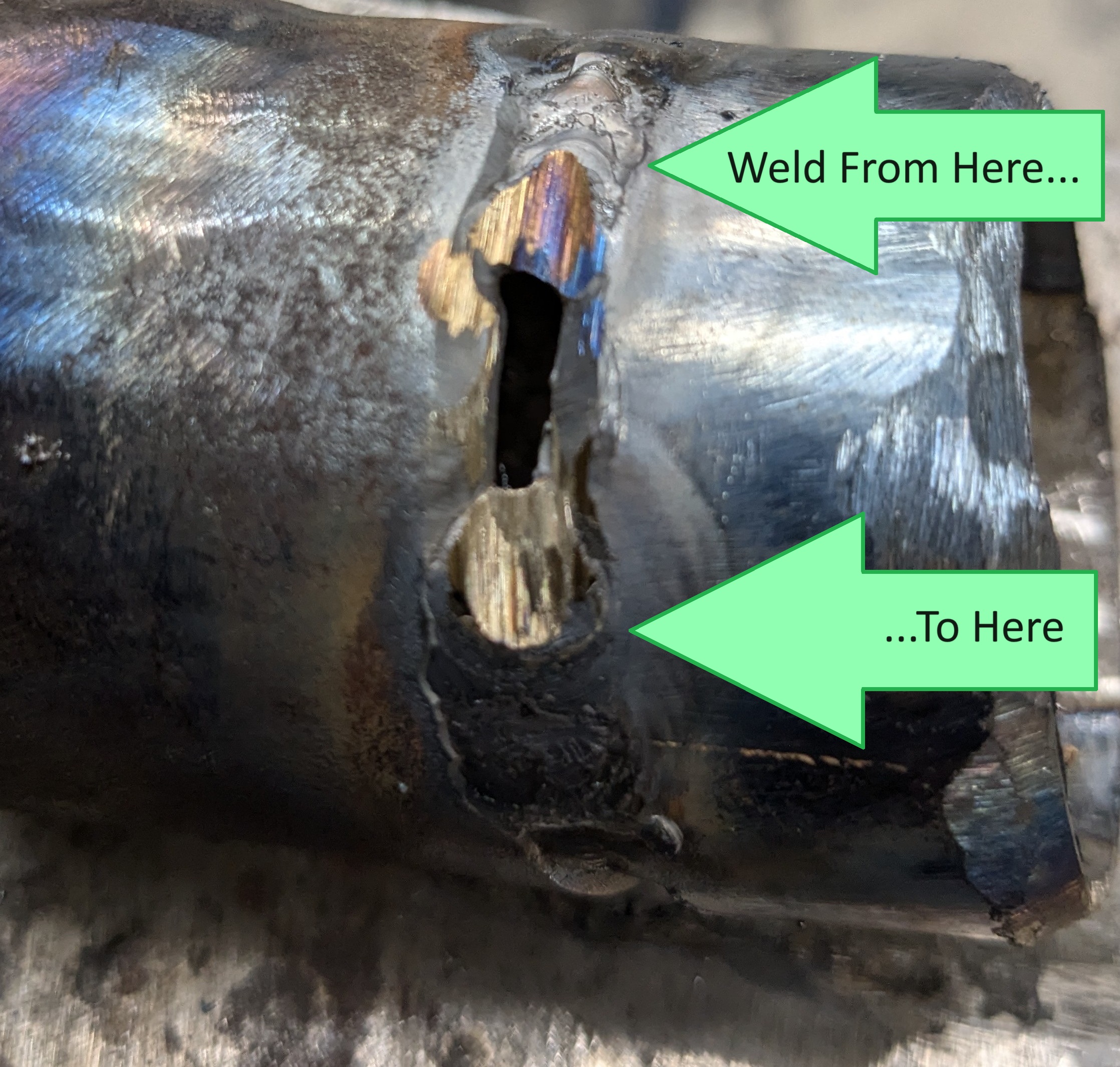

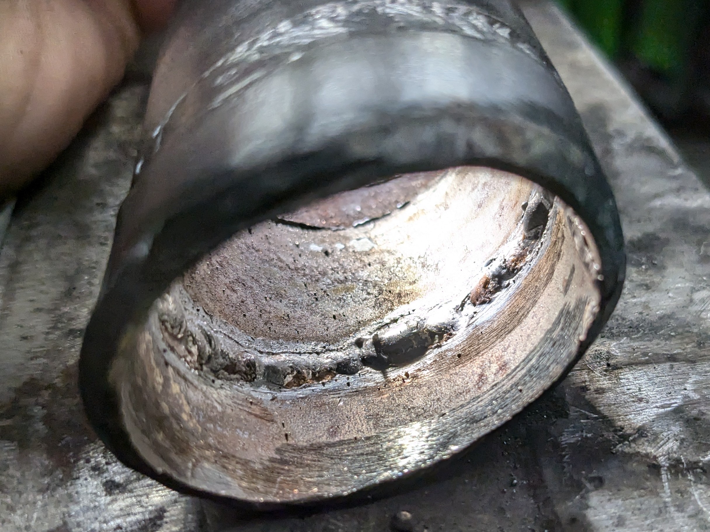

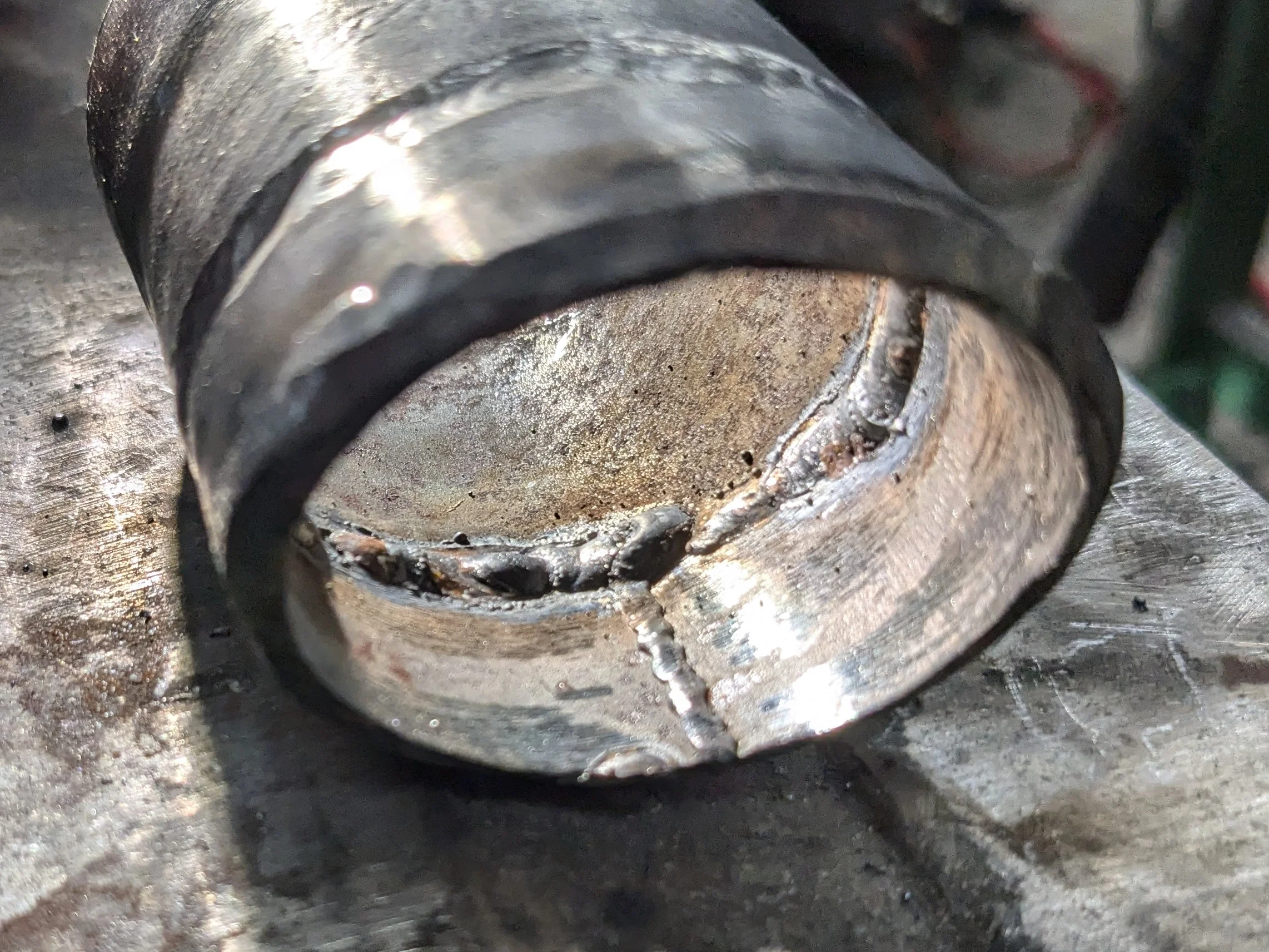

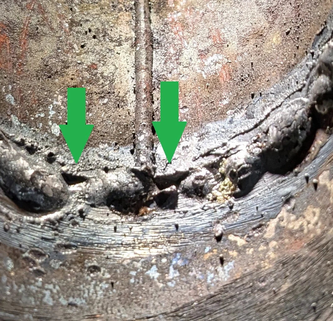

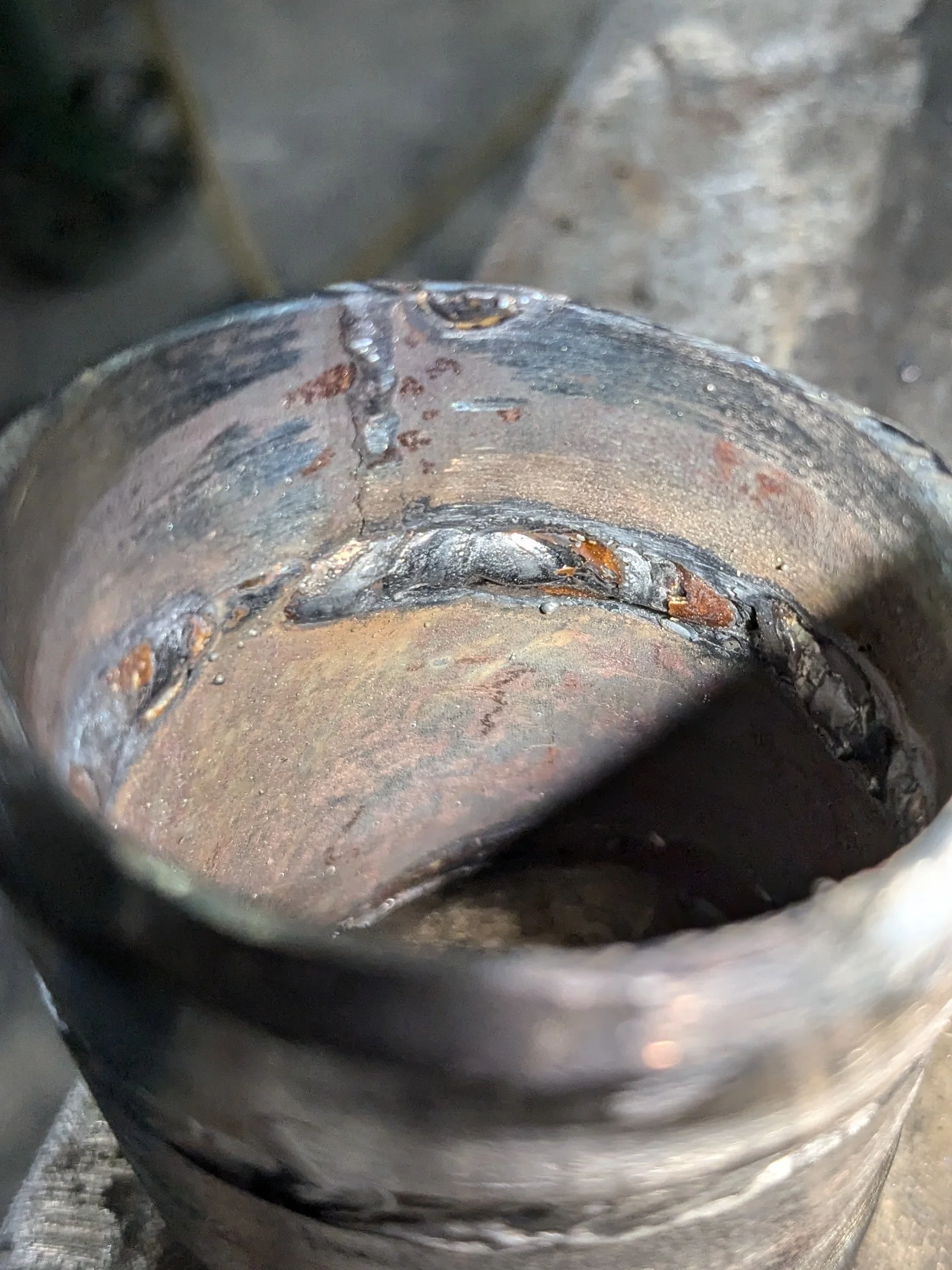

What do you do with tack welds? I always plan out where I am going to tack pieces together. I'll then weld close to it, about an inch away, cut the tack out, feather the stop of the weld then continue to weld through that area. If I'm welding all the way around something then I'll feather out where I started then weld into that area tying everything together. The reason for doing this is to avoid weak spots in your weld. Starts & stops are the weakest so the goal is to minimize these. You can grind it however you want, but I find that a ⅛" grinding wheel or a thin burr bit work the best.

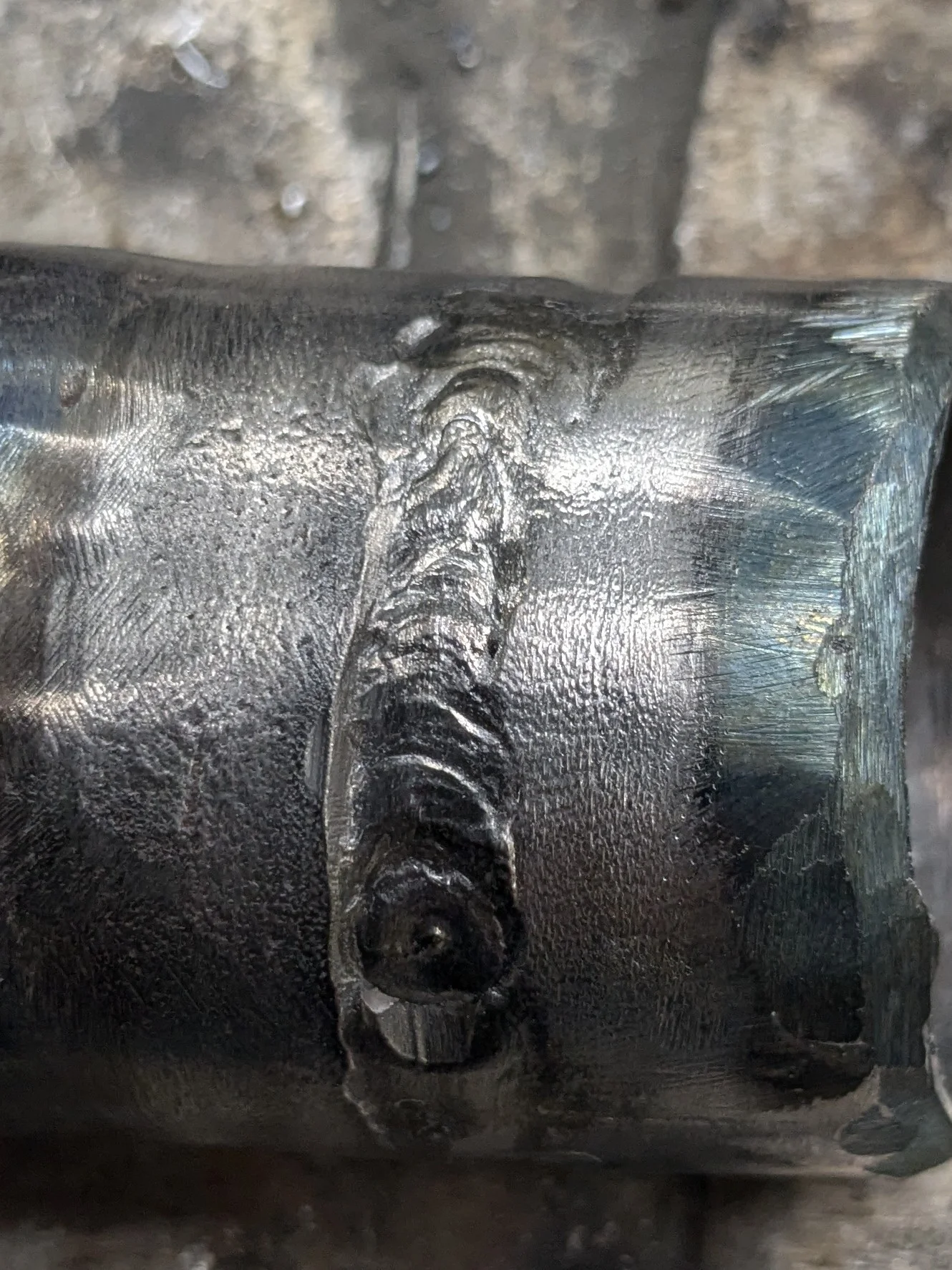

When you make the rest of the weld you need to weld from end to end of your grinding marks. You can see towards the bottom where I didn't quite go far enough.
This will give you a nice full penetration weld,

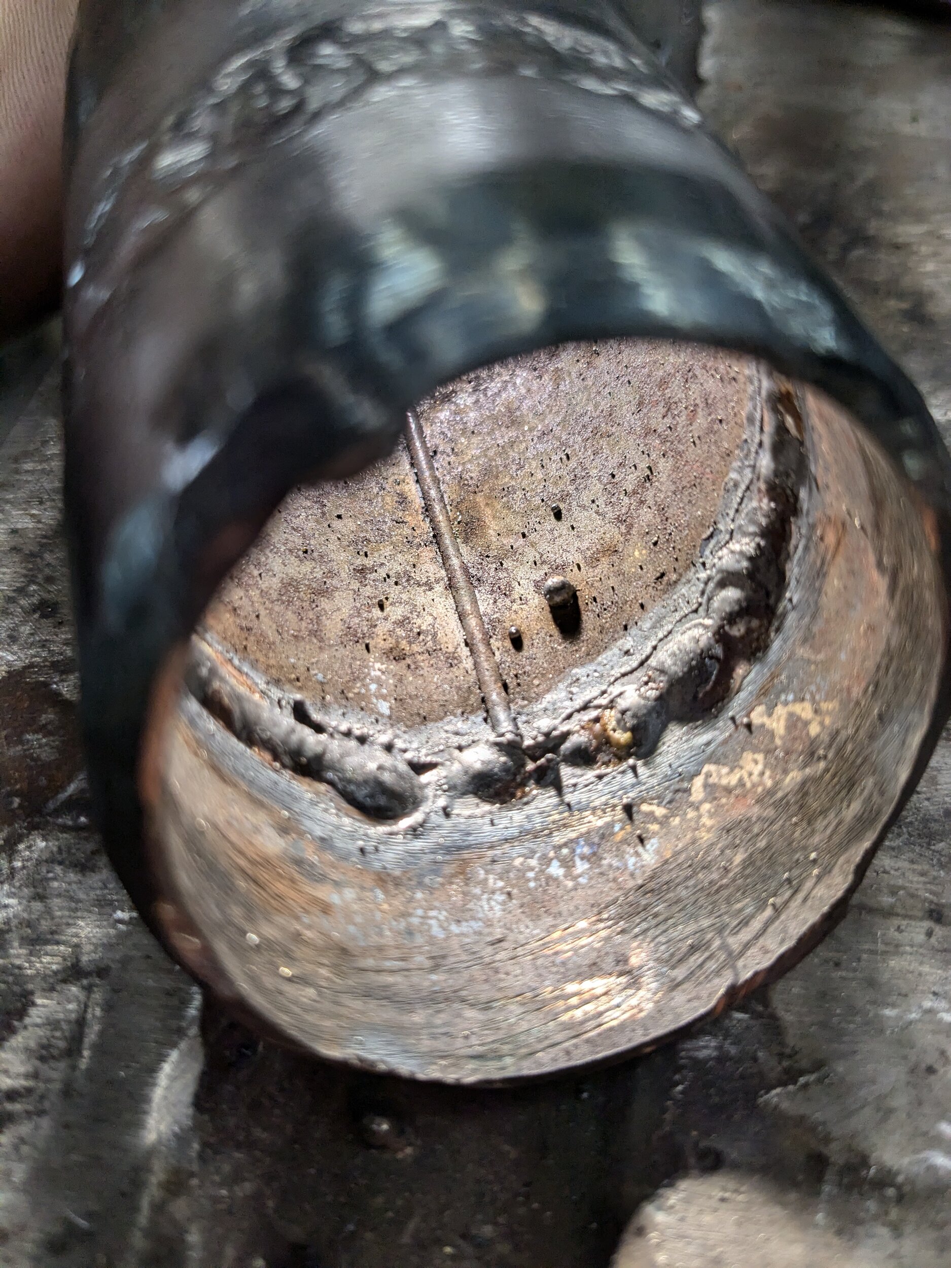

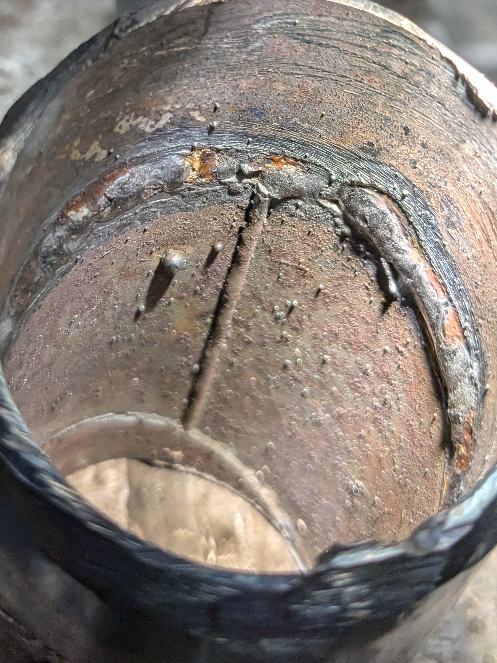

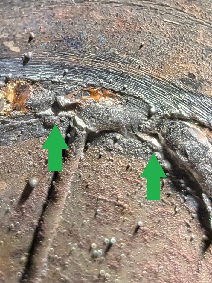

Here's the inside of a tack that I did not feather out. Note that I TIG welded this because I had that machine set up already. With MIG or Stick you have less control so it will penetrate even less. See if you can find the bad spots.
You can see where my tack is easily on the back side if you know what to look for. A dead giveaway is the pronounced straight edge of the base metal.
