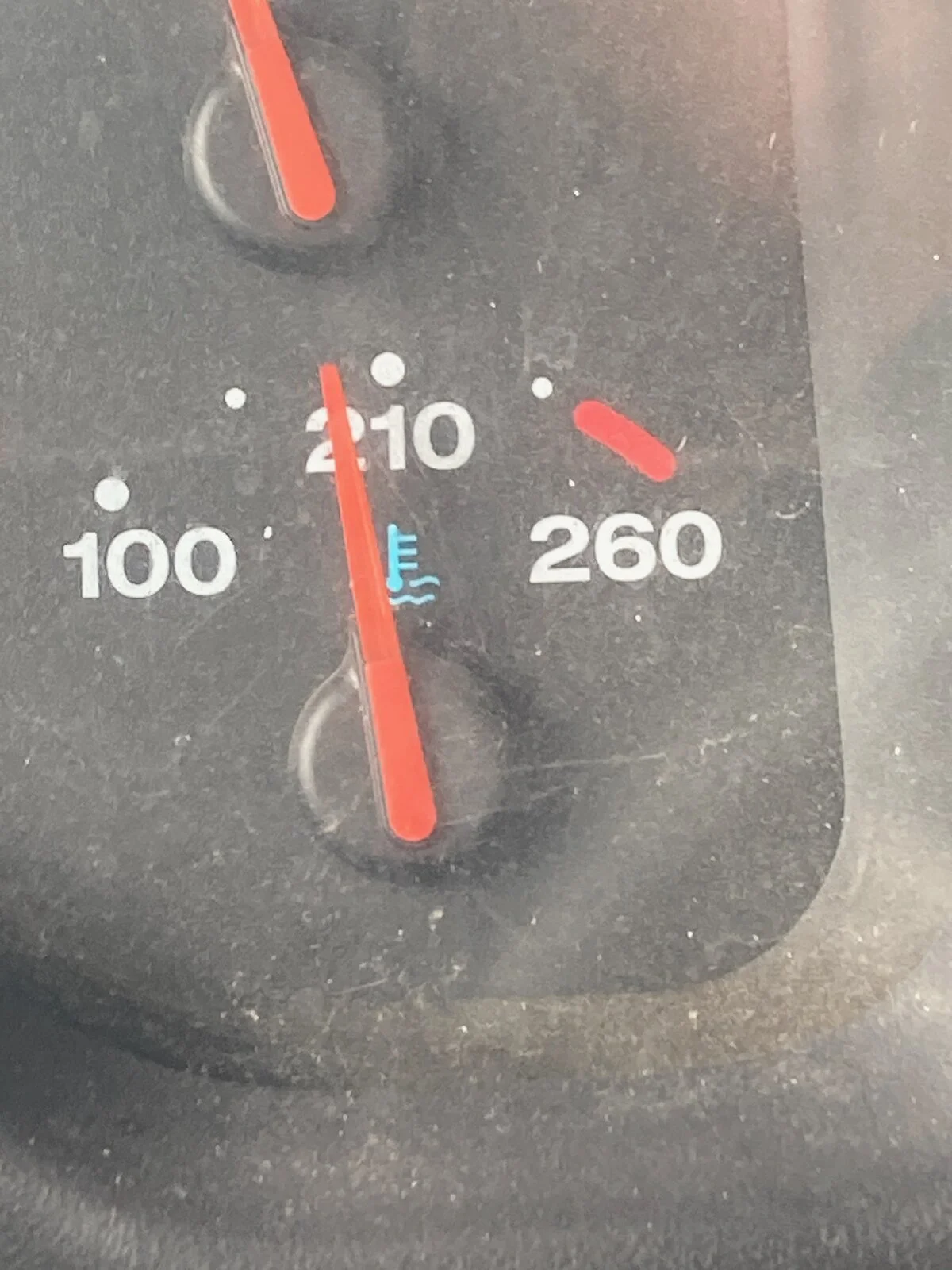

Am I running too cold?

My experience with engine temperature mirrors DylanM345. The only time I see 210 is hot days idling on the trail. It drops back down below 210 once I start moving and the rpm goes up. This is my normal.

I have a trail dash that tells me my temps. I was able to tell when stuff needed replacement, when it started creeping to 212° then to 217° I replaced everything with Mopar parts, and now in the central Fl. heat I hover around 199 driving, to 206 at stop lights. Only shows just under 210 on gauge. This is stop and go traffic.
