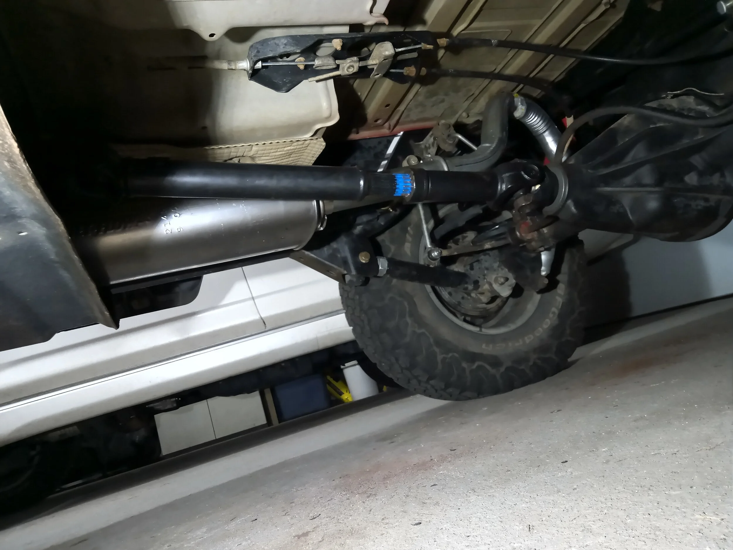

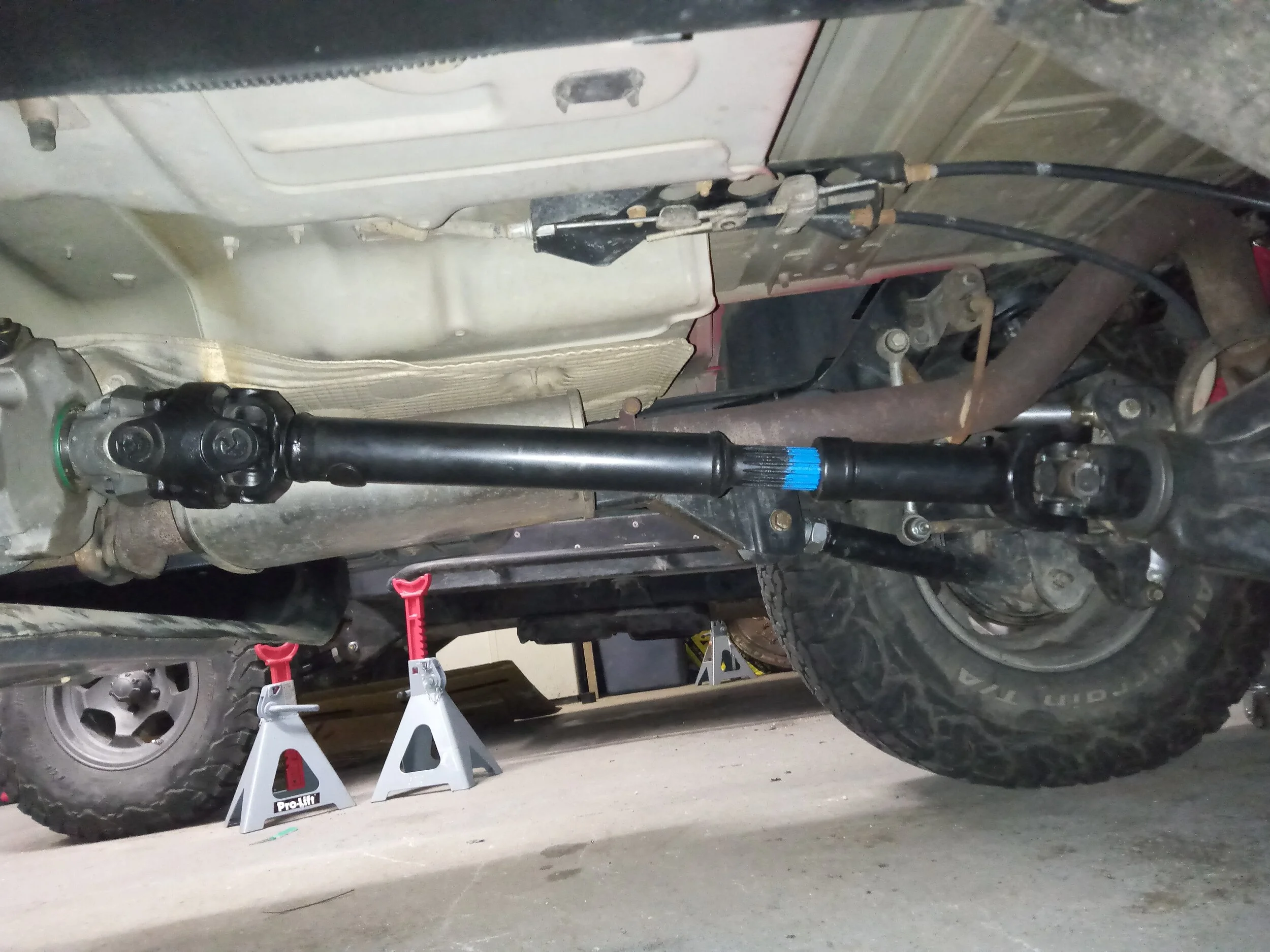

I assume you added about (or exactly) 10" in the middle???
Exactly. I got a walker quiet flow muffler and a tailpipe. Normally they fit together in a TJ. I went to AutoZone and grabbed a 12" section of tubing with a flare at one end, plus an extra clamp. took it home and cut 2" off and clamped it in between the muffler and tbe tailpipe. Easy peasy.
Before and after (you can see the extra clamp just aft of the blue glidecoat on the slip joint in the driveshaft)

So I am interested in knowing how that blue film on the driveshaft lasts…
My LJ came from the PO with an aftermarket rear driveshaft (mfr unknown) with the Glidecoat. It also came with the wrong size U-joint installed at the pinion end (I was shocked because I drove 12 hours home with that!) When I pulled the shaft at the rear U-joint to replace it, I discovered that the Glidecoat was causing the driveshaft to bind - it took an incredible amount of beating to separate the two.
When I looked into the cause of the binding, the Glidecoat was peeling, and just like in the link freedom_in_4low posted, Shawn said that was pretty rare. I told Shawn that I’m not yet ready to replace it because I have a Savvy mid-arm kit, with new Currie springs, waiting to be installed, and I expect to need a different length driveshaft. He told me to just remove all the Glidecoat to free it up, and after, to keep it greased regularly. He even sent me a new cap with a zerk for the end of the female-splined section so that I can keep it greased - for free! There’s now a lot of free play in the joint, but I’m not worried because I really won’t be driving it much until I get the mid-arm installed and replace it.

Excellent. Thanks for the images
