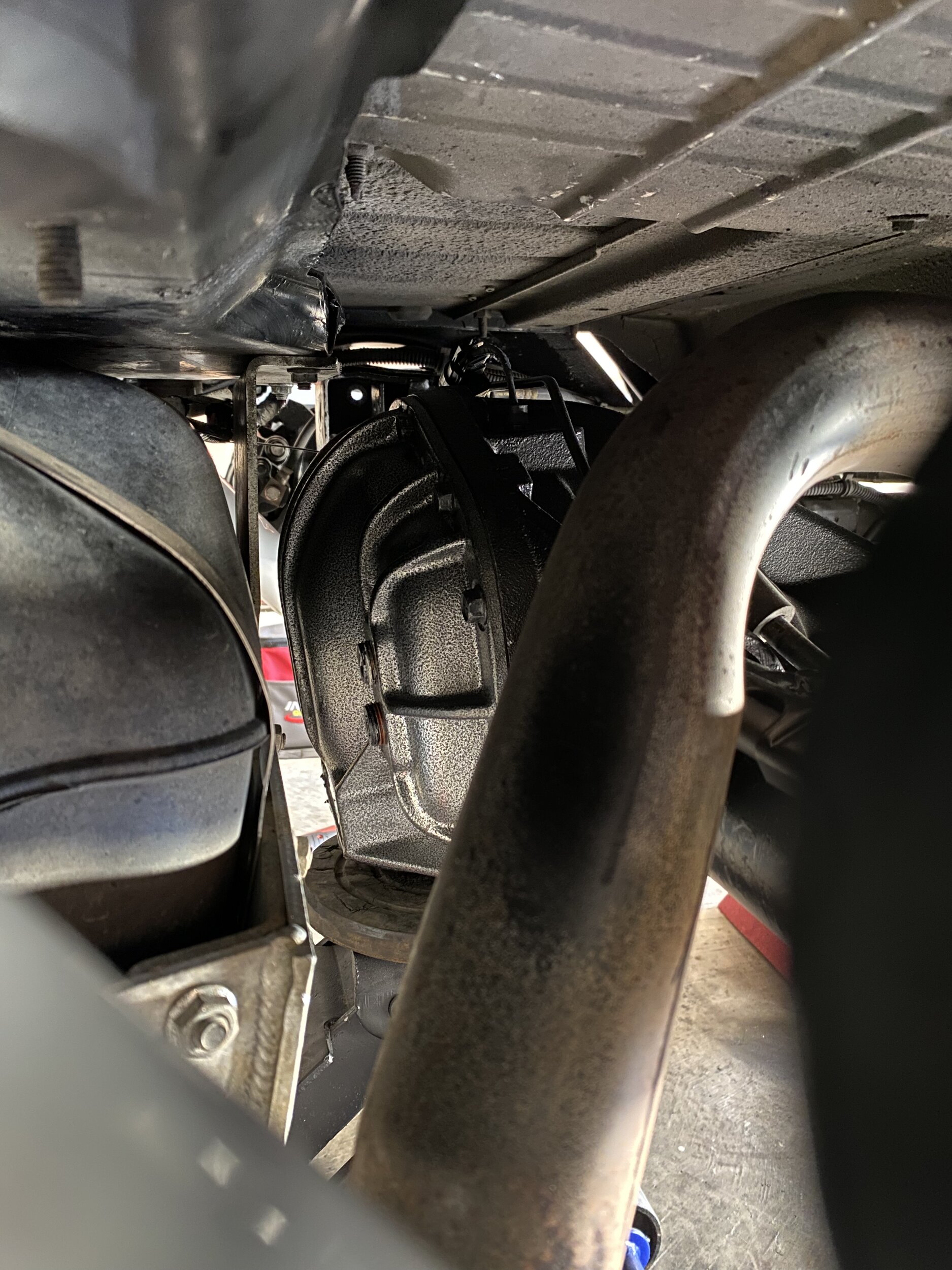

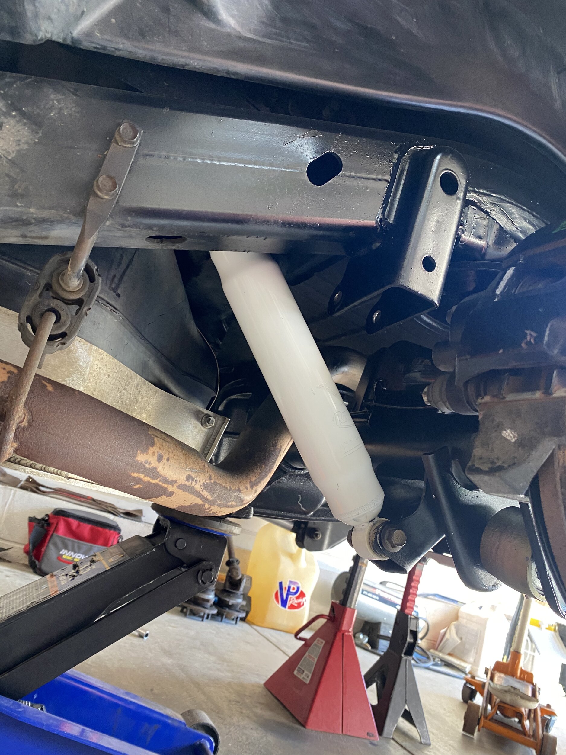

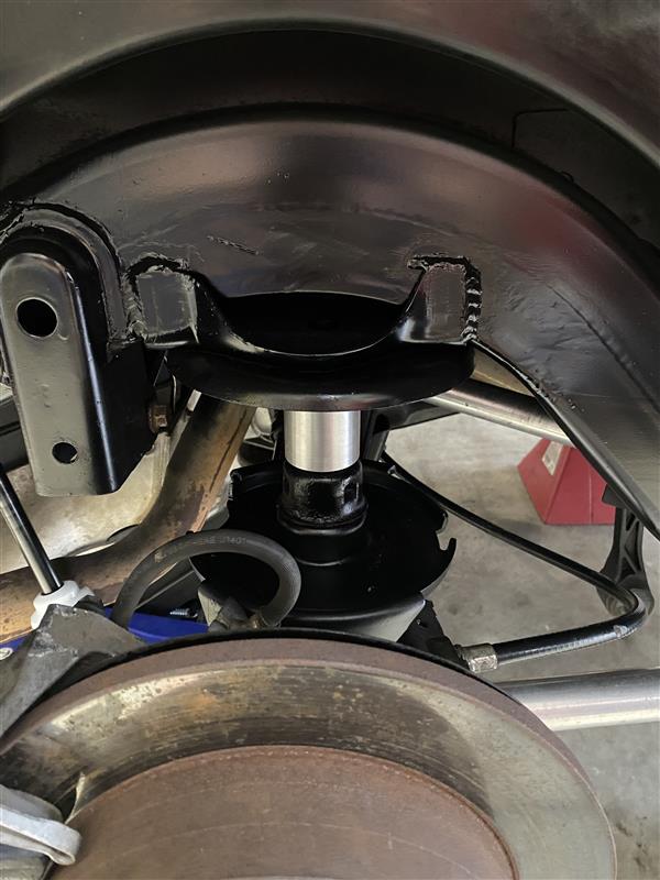

I started by finding new ride height, setting pinion angle, bolting in shocks and checking interference/travel. Rear of coil pads needed trimming for shock body at droop. In addition, cross member was trimmed for TB as axle went into full stuff.

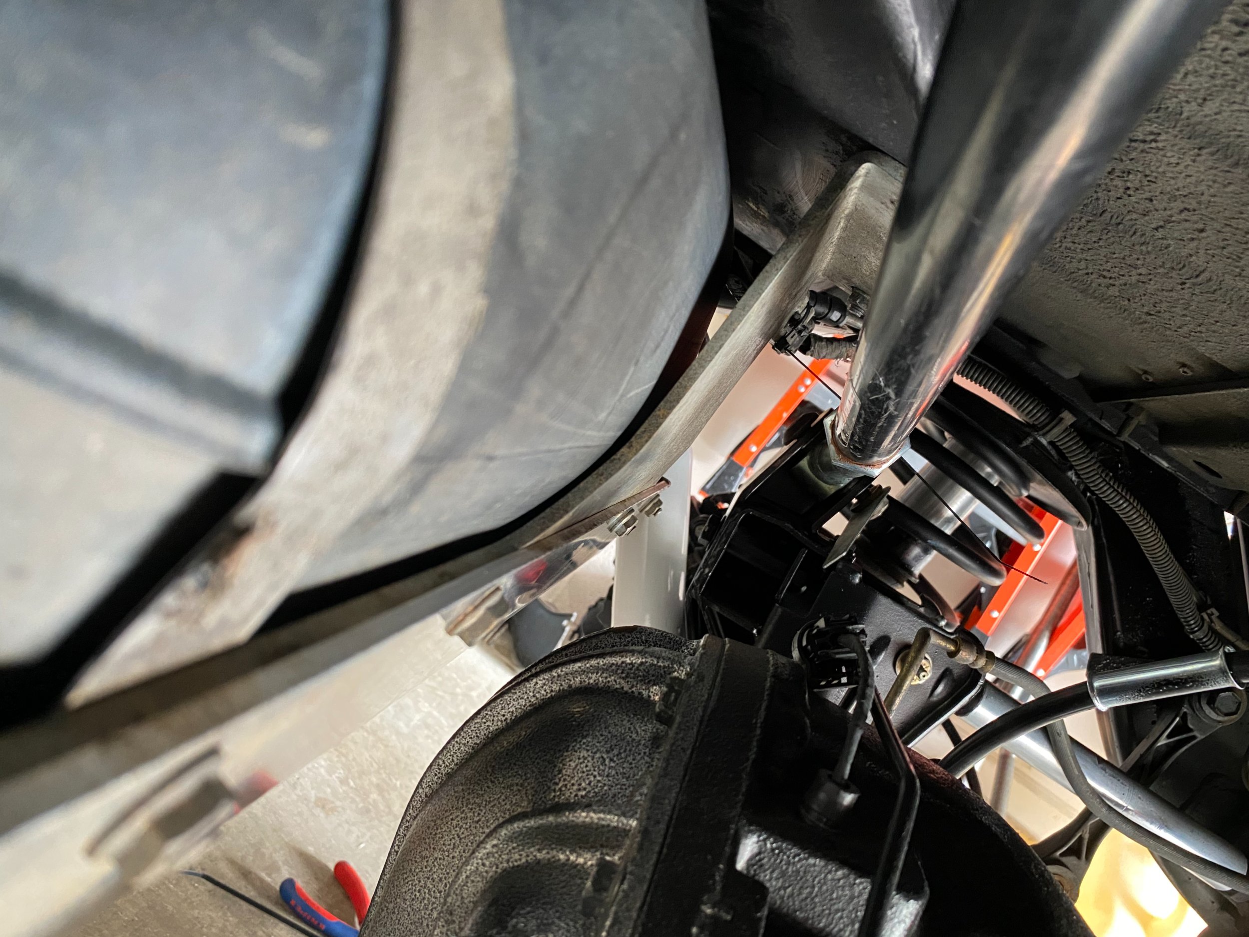

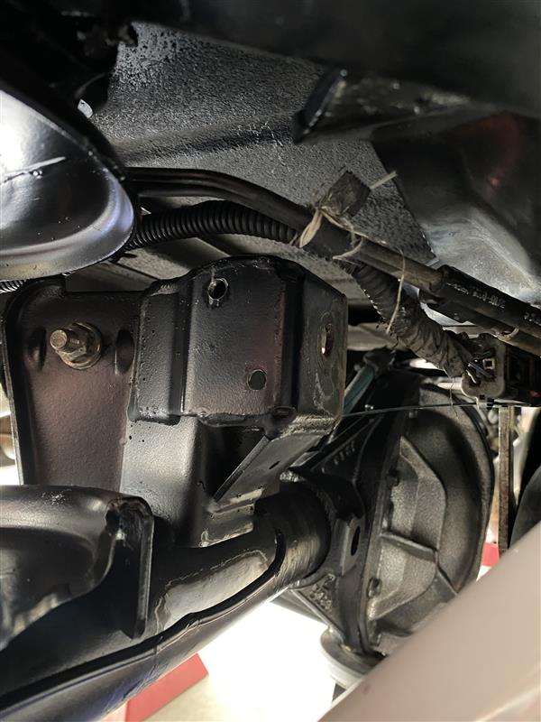

Biggest problem is I had the gas tank out while cutting and relocating coil pads and cycling suspension. The frame side fuel lines were floating inside the frame rail. Currie recommends a min 2.5" bump stop and coincidentally, at about 2.5" of BS gap, the bracket started to get into the fuel lines and relatively close to tub. Now after installing spacers and putting everything together, I am shocked at how little up travel I have. Can anyone give input or pictures to how they mitigated bracket interference at fuel lines? Maybe I need to pull coils back out and start cycling again....
Secondly, the front corner of the skid where i trimmed the crossmember will be a contact point. Is the JKS rear bar an issue? should I just trim that corner of the tank even though it is a slotted hole? Does a currie bar have a bend here to mitigate this issue?

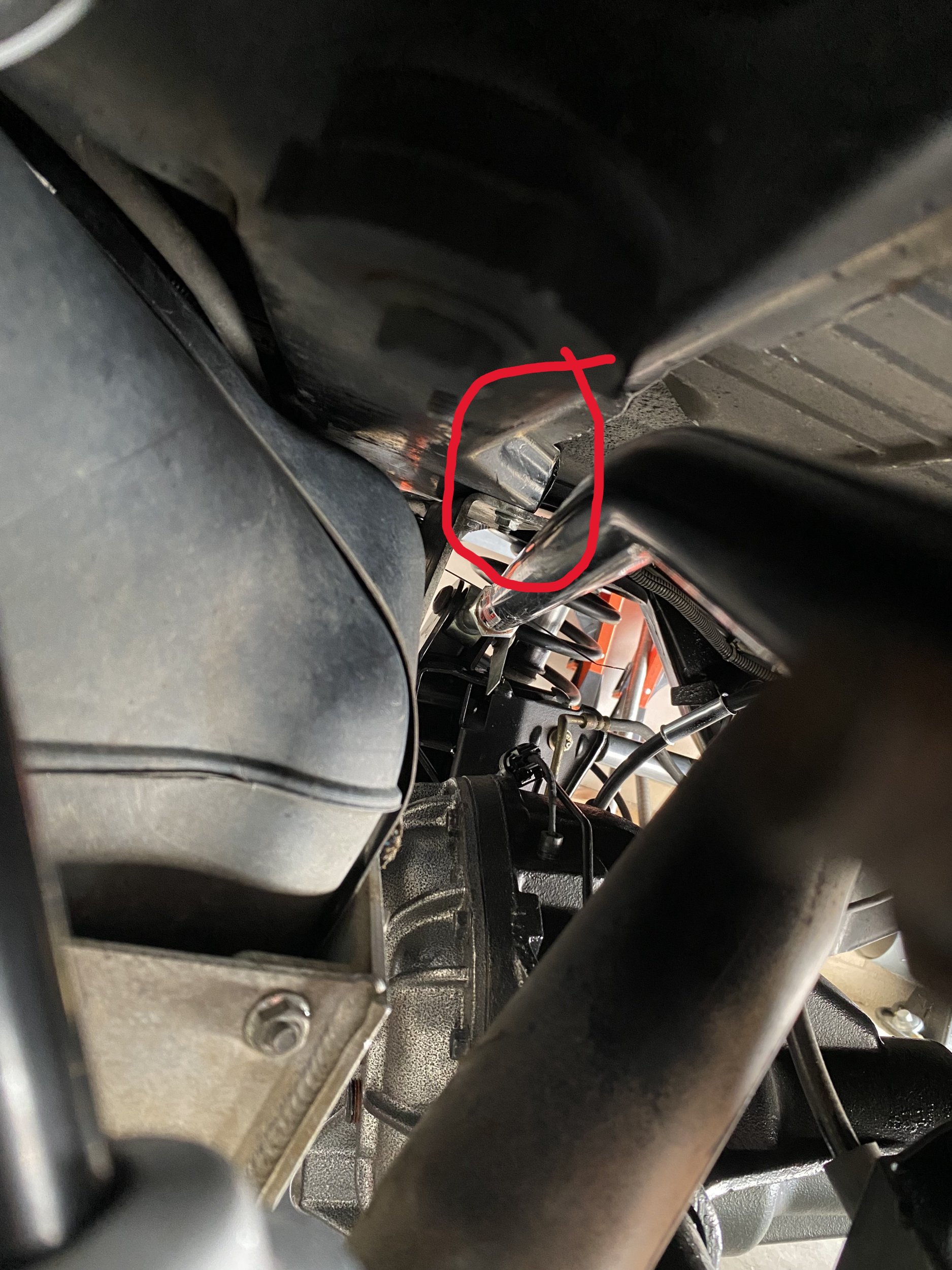

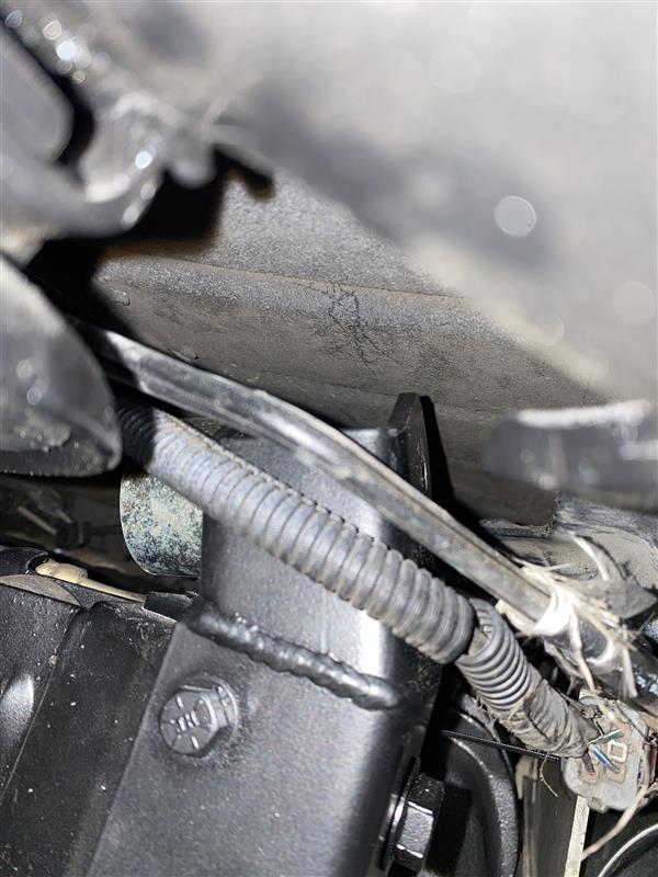

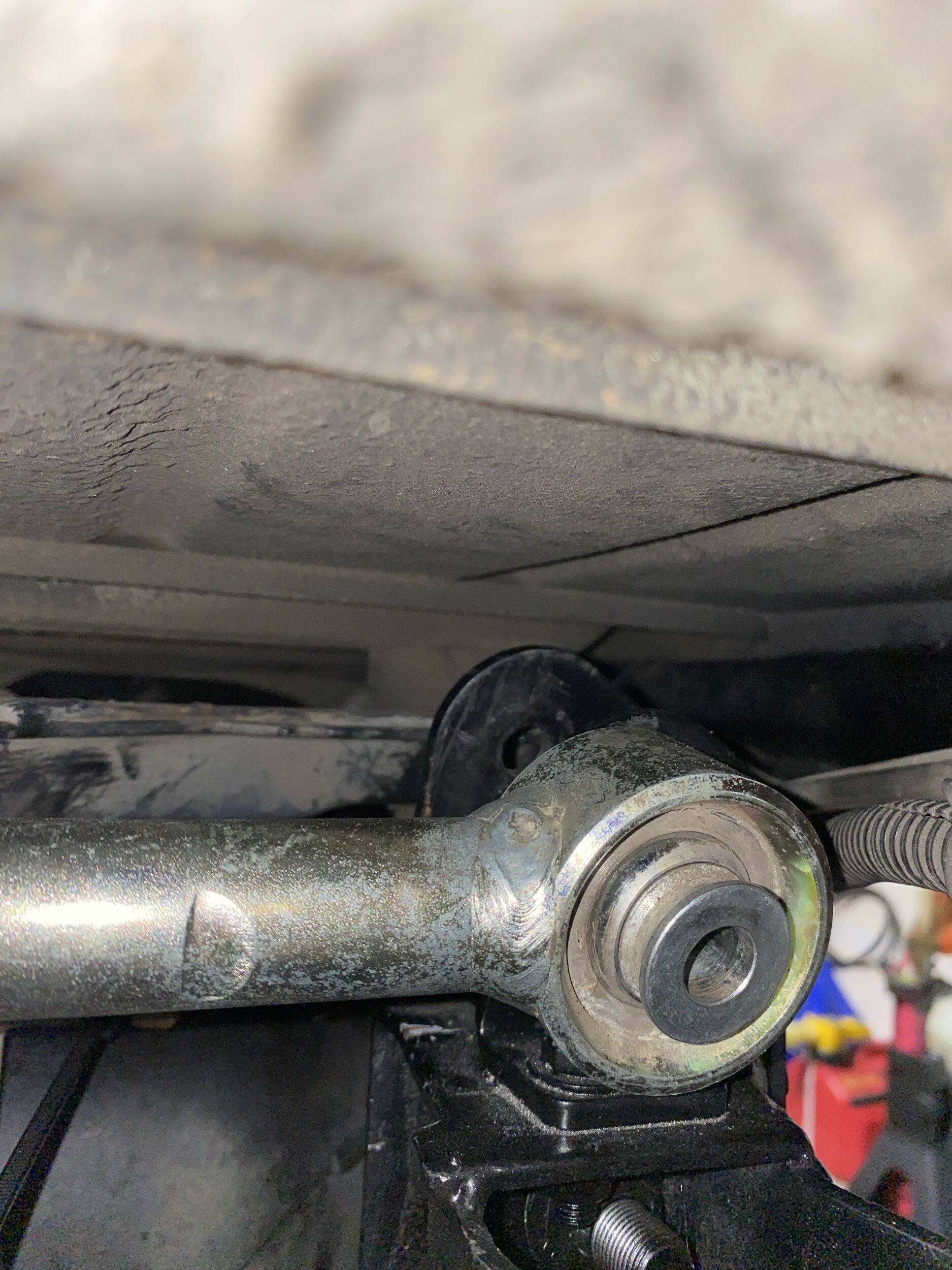

Disregard TB sitting in front of bracket, had to move it out of the way to cycle axle up to bump. Pictures show 2.5" bump stops bottomed.
  • I have about 5/8-3/4" of clearance between tub and new bracket. I am going to shorten aluminum spacers 0.5" to 2" for more up travel.
  • Hard fuel lines actually look ok, but definitely close. The wire loom is what may actually catch and it doesn't seem to have much slack.
  • Trackbar clearance at gas tank mounting corner is an interference
  • Trackbar clearance at crossmember where TB has a hump is also an interference
