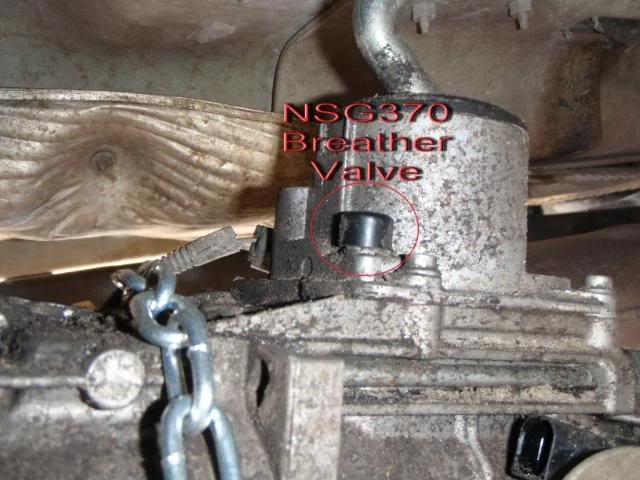

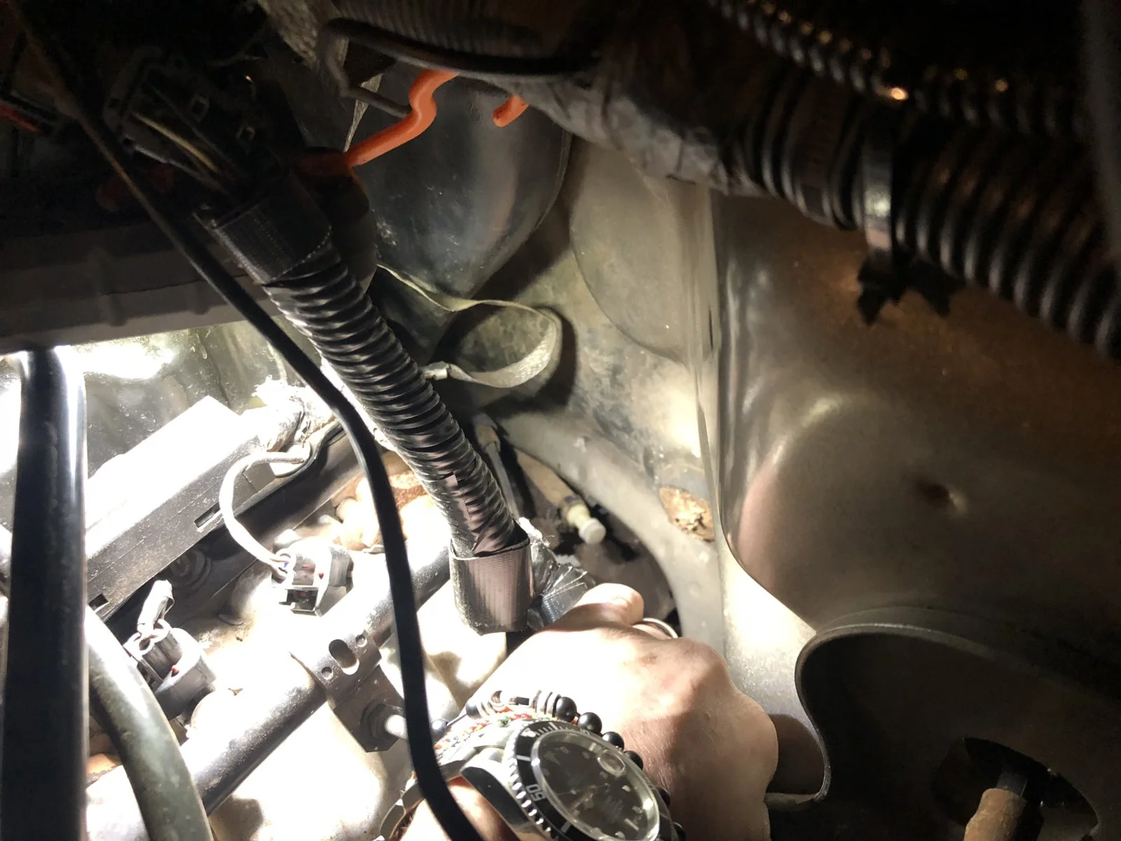

Thought I was out of the breather tube relocation business, then tonight - just as I'm getting ready to call it a night, I see a little nylon breather cap staring at me from the top of my transmission bell housing. Is this for the transmission? That would bring the total to four, right?
Hmm very interesting but in my case that one was for my transfer case. My 2006 NSG370 had no breather hose instead it has a plastic cap.
It had total of 3, front axle, rear axle and transfer case.
So you did a conversion, right, and extended the breathers?
I had asked around multiple times in forums back then and no one gave me the answer. I even asked a trans guy who was part of the club and he never gave me the answer either. I took that pic when I had to replace my clutch and there it was a breather cap instead of a hose.
