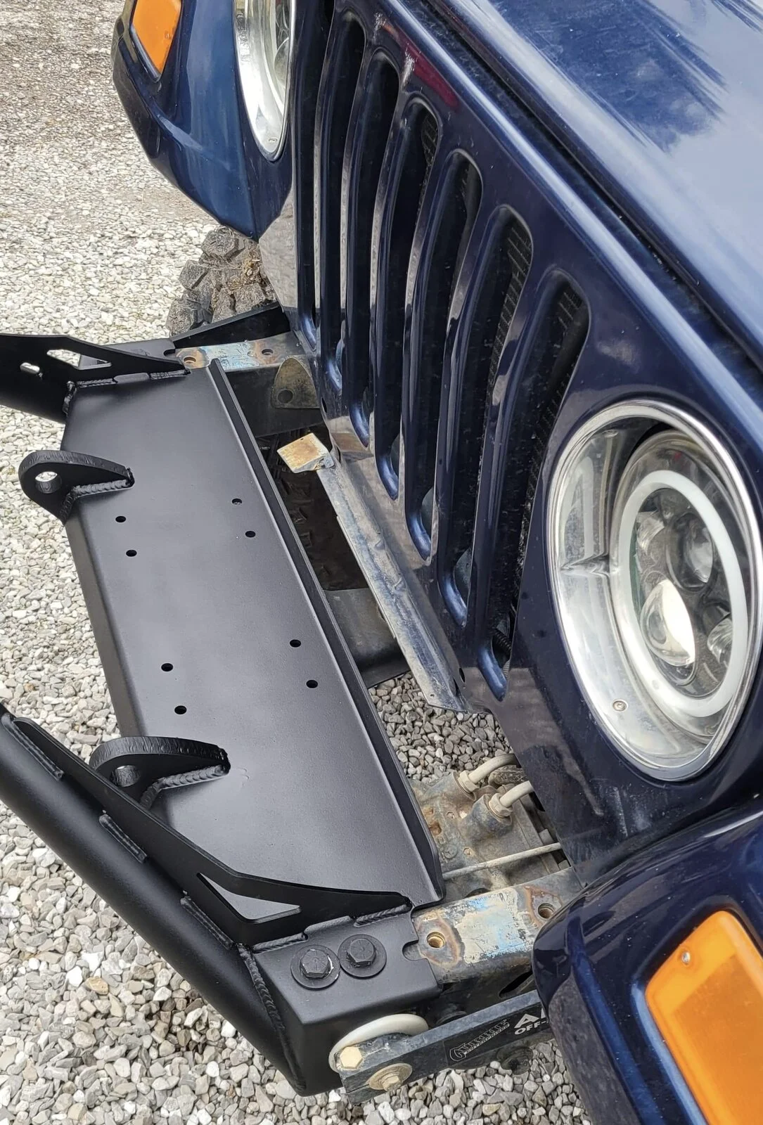

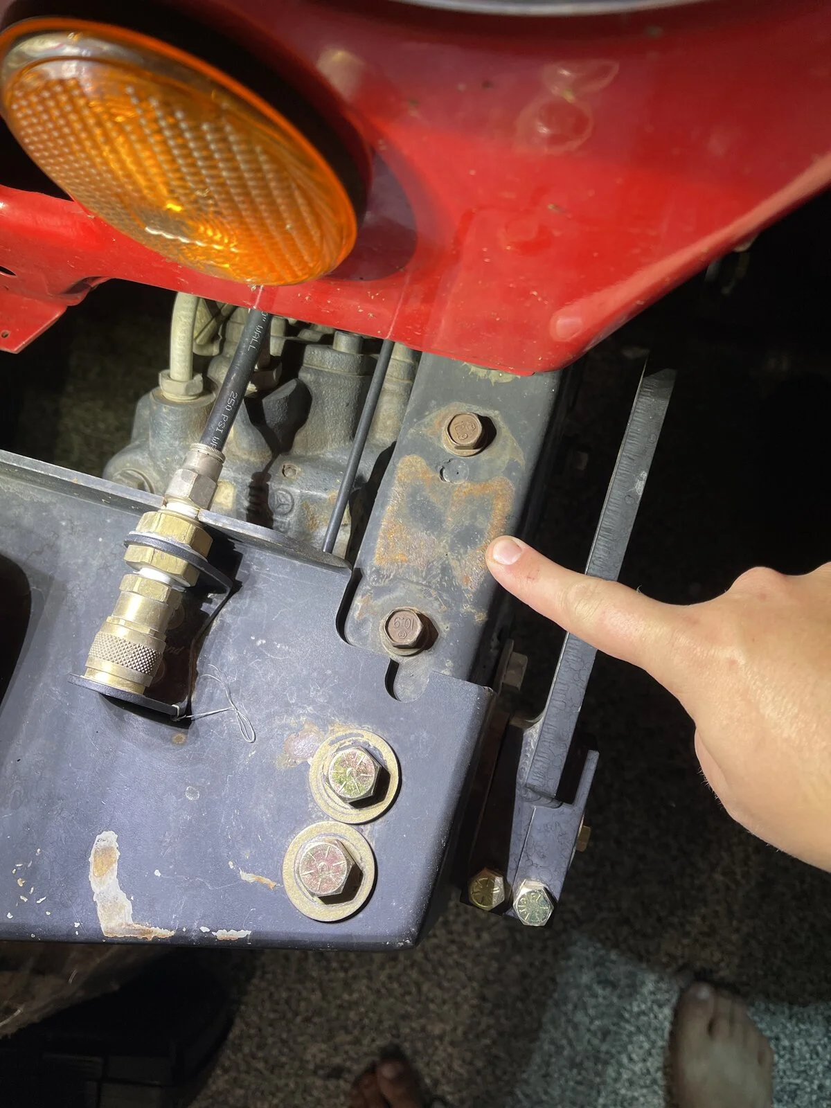

OK. I guess I would not call that a gap that is left when you install the antirock but at least I know what we are talking about.
Maybe I could have worded it better . The gap I’m talking about is not from installing an AntiRock but from removing the factory sway bar and it’s plastic cover .
I like the way the Savvy fills the gap where the factory sway bar was located . The TJ I bought has a cheap bumper that leaves a big gap there . I also like how the Savvy allows you to move the winch back a couple of inches on the bumper if the factory sway bar has been removed
The primary value is that the larger winch deck turns the bumper into a very large gusset that adds a considerable amount of strength to the frame.
Do you feel there’s a benefit to having your modified aftermarket steel bumper compared to the aluminum Savvy ?
Mine was a bit less expensive and welding stuff to it is easier. But it weighs 2-3x as much as Savvy and it took an entire weekend to remake. I copied everything I could, but I still think Savvy is the better bumper.

For anyone buying, just be sure to get the hardcore upgrade. At least if you wheel moderately hard.
