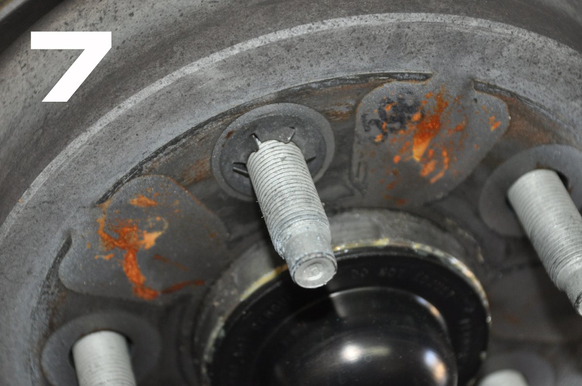

When the wheels were installed, the place forgot to remove the metal rotor retainers put on at the factory (yes I still had mine). This naturally caused a very bad shimmy - probably the worst shimmy I have ever felt in my life of driving. Whole darn Jeep was shaking just at 40. After removing the retainers, the wheel shimmy is significantly less but still very bad. So I put on the OEM wheels/tires since I haven't tossed them yet and it drives perfectly straight, nice and tight, no shimmy whatsoever - this rules out (for the most part) a bad axle, ball joints, or other suspension components. PSI was tested at 40, 25, 30 and 28.
