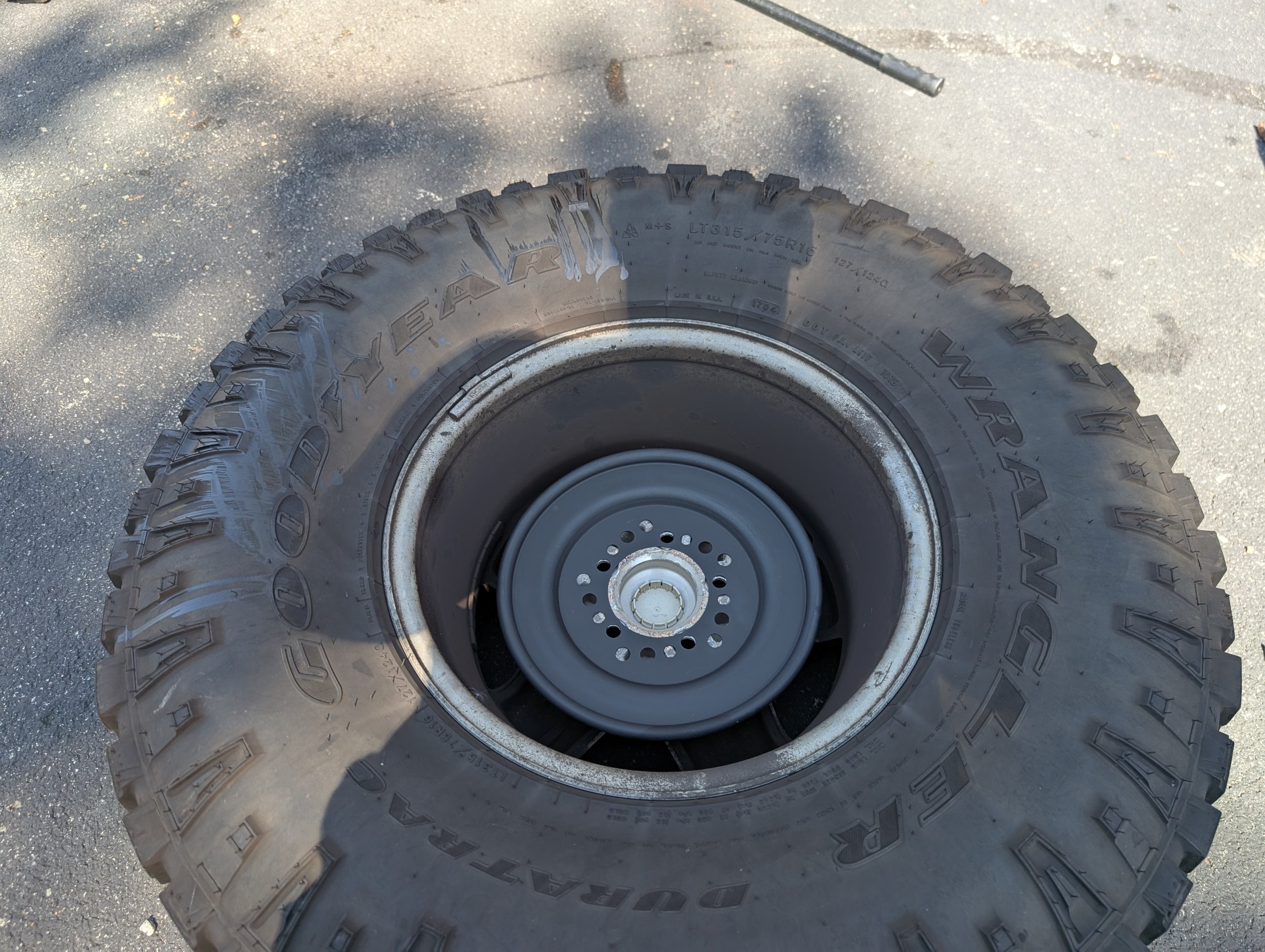

These smaller ones will fit 15" and larger rims without any issues.
They are intended to be mounted with the dish facing inwards such that the balancer is roughly in the centerline of the wheel. In a pinch, they can also be mounted facing the opposite way to clear any calipers. (The dished area is sufficiently large that the OEM Moab rims hub surface sits entirely within the dished area with room to spare.) The dished area is also small and deep enough that it will clear a Super 16 big brake kit even without a spacer if mounted in reverse fashion. I'm fairly confident these would probably be able to work with any big brake kit.

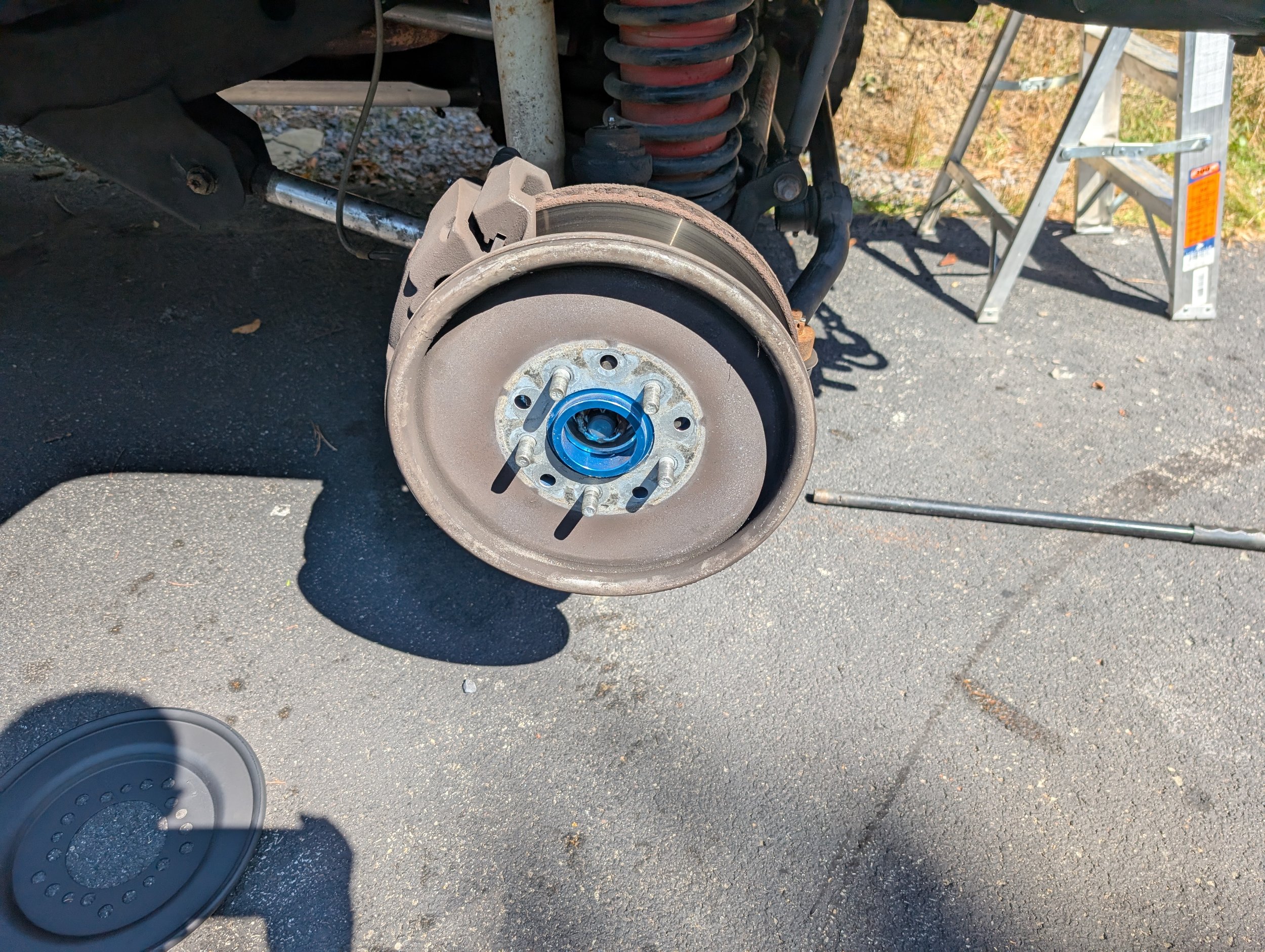

Mounted inwards with spacers on a Super 16 big brake kit:

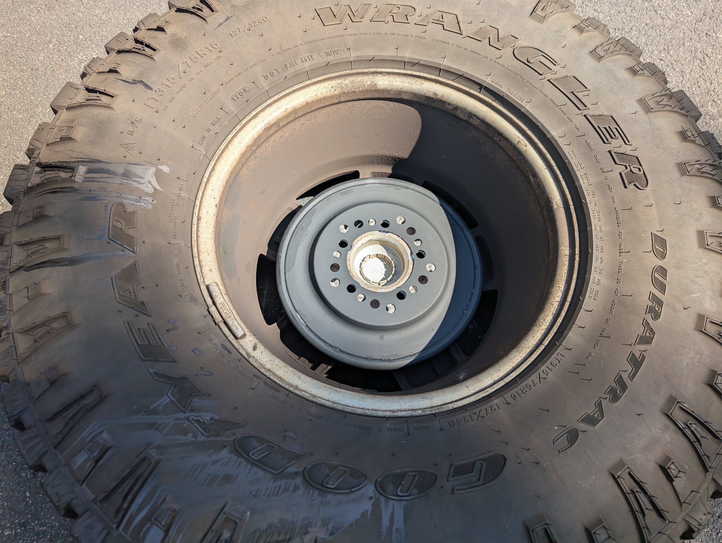

Balance Masters JU-5 mounted in reverse:
Showing that it fits the Moab rim in reverse:

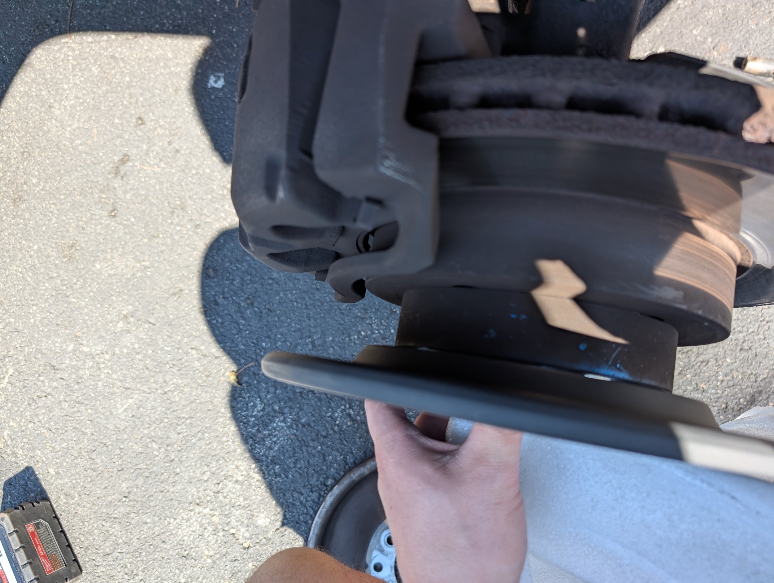

Showing that it will clear the Super 16 big brake kit:
Hard to see in this 2D photo, but in person it's pretty clear that the dished area would clear the bracket on the caliper if the spacer was removed.
