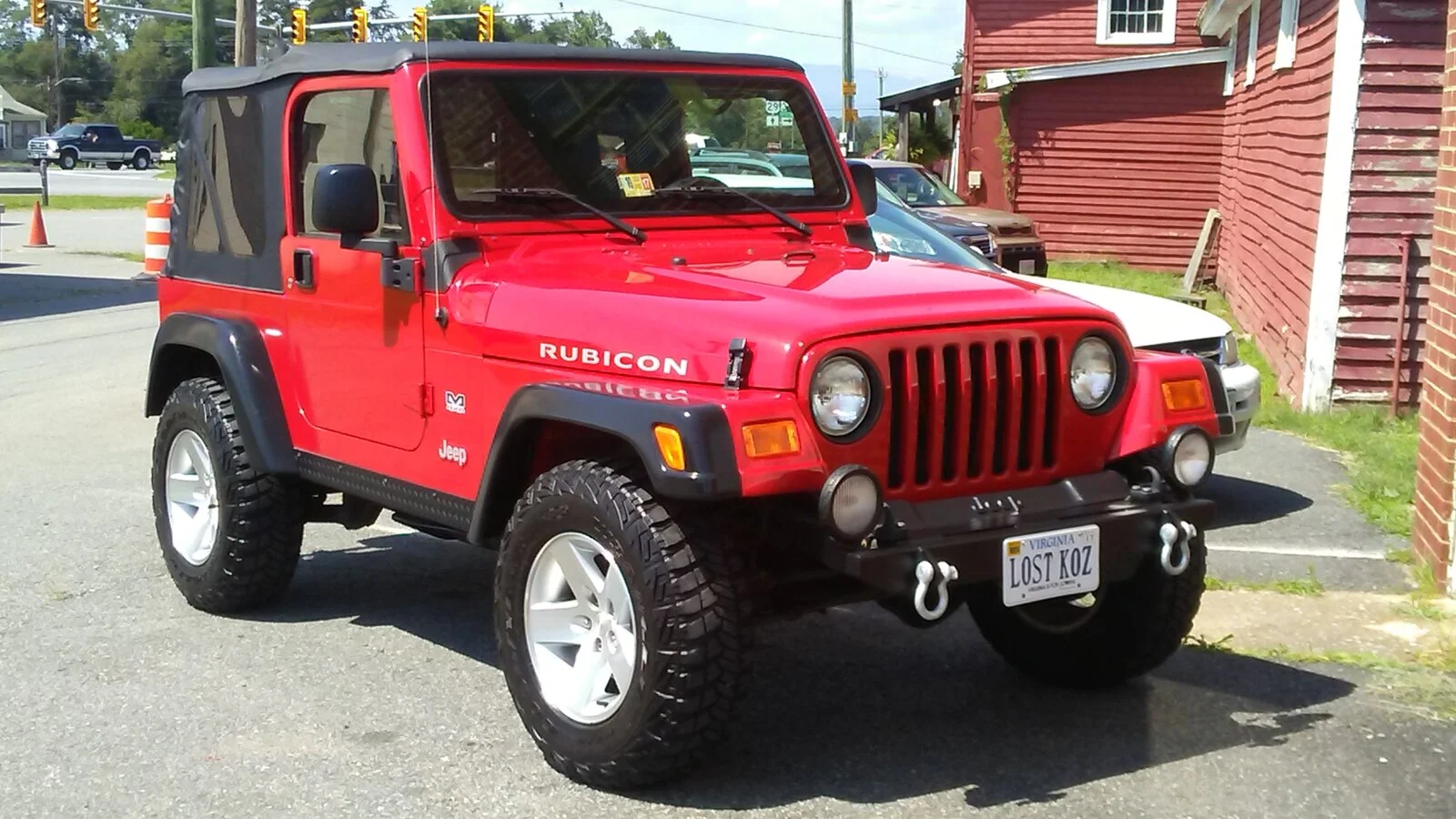

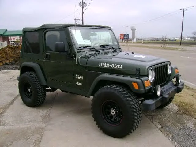

Most aftermarket wheels are 4.5" backspacing or less. You want the higher backspacing to keep them tucked in. Willys Jeep has 4" backspacing with 10.5" wide tires.

Here's a 33x10.5 on a 15x7 with 3.75" BS on a Sahara flare, which is 1" wider than the standard flares. Notice that he's right at the edge with the 7" wheels and wider flares. Standard flares and a 8" wide rim with equal BS would equate to > 1" more tire outside of the flare.
Of note, the Rubicon, Sahara, and some special edition models had 1" wider flares. The easy way to tell which flares yours are is if they're painted vs not (smooth vs textured).
Photos borrowed from this thread. There are quite a few examples in that thread of various 33x10.5 with various flares and backspacings to give you an idea of what to expect from your setup.
