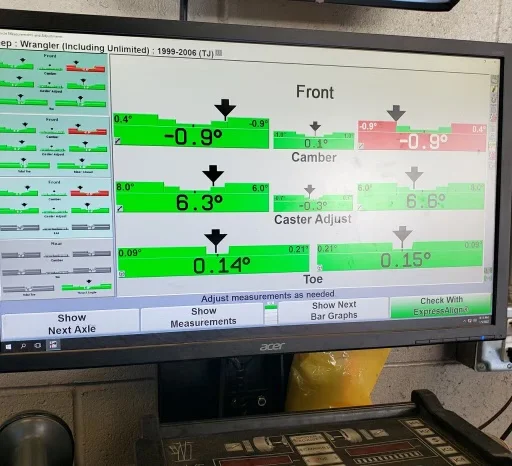

Any thoughts on these alignment numbers?
Possibly. And it's caster, not castor which is a bean that castor oil comes from. 😊

Local Firestone shop where I have a lifetime alignment deal. Those folks must hate me! Other than, I don’t really feel any bad vibes to speak of, even in 4x4. But I’ll go ahead and adjust for less Castor in favor of better pinion angle.
If you don’t have vibes I wouldn’t worry about it.
