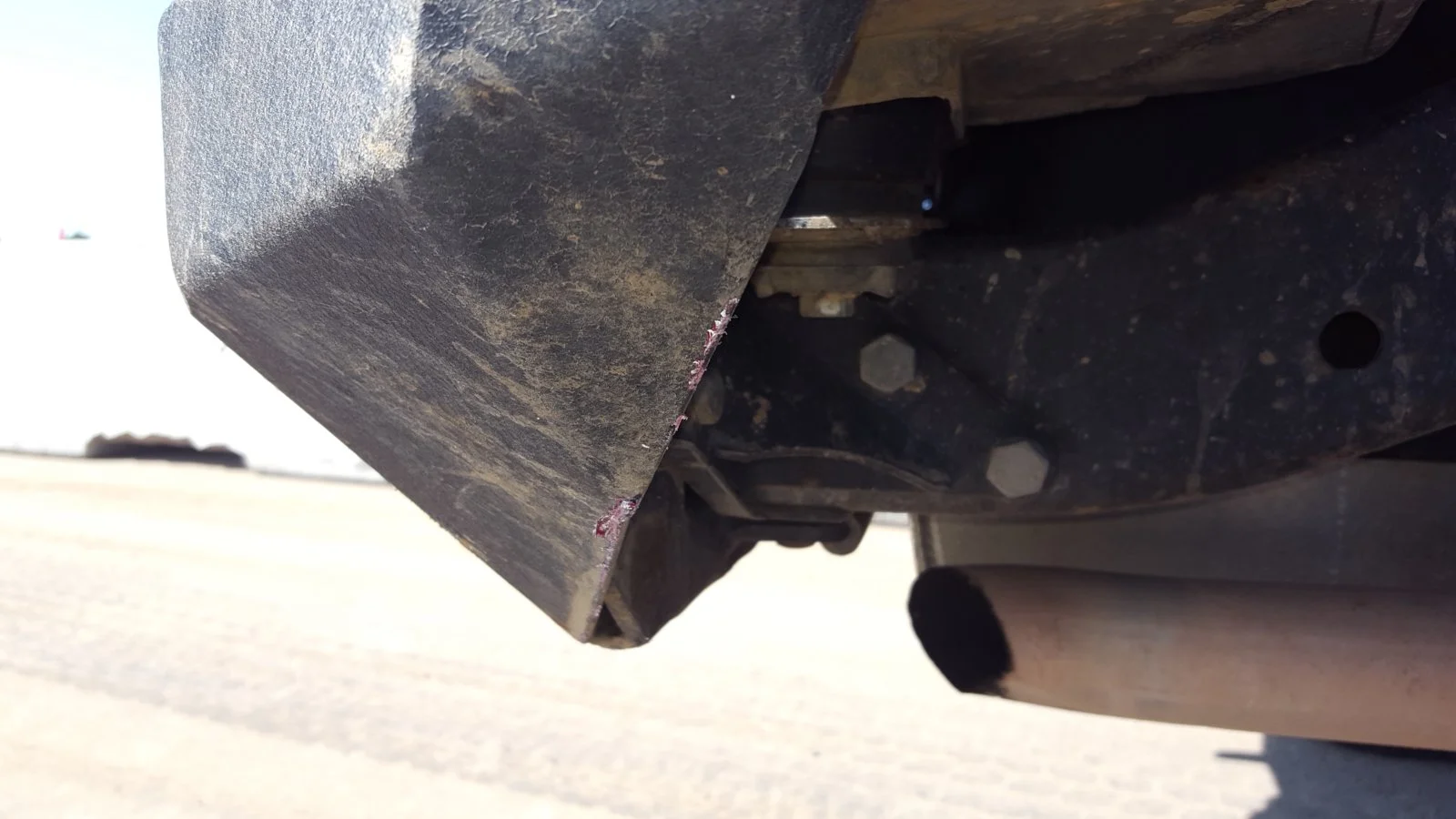

Not sure if they are available separately or not but my shittybilt rear bumper included frame tie ins.
82968
They are available separately. Poison Spyder makes the best for about $50. What makes them best is the access hole to the rear body mounts. The others have to be removed to access that mount.
Reactions: tworley
Mine dont need to be removed. Its a tight fit, but with a tall, skinny socket I was able to remove and install the body mounts just fine.
Reactions: JMT
I have a tube bumper I installed 18 years ago on mine that required extra holes in the rear crossmember. I got lucky and was able to fish a couple of nuts back there on the drivers side and I slipped a couple of bolts through from the backside without dropping the gas tank. Maybe I was lucky...
Wow. Glad I randomly stumbled upon this thread. I'm installing my Warn bumper and tire carrier next weekend and didn't know about the frame tie-ins. Just ordered the Poison Spyder set for $45 from 4WP during their they pay the sales tax promotion. Thanks fellas!
