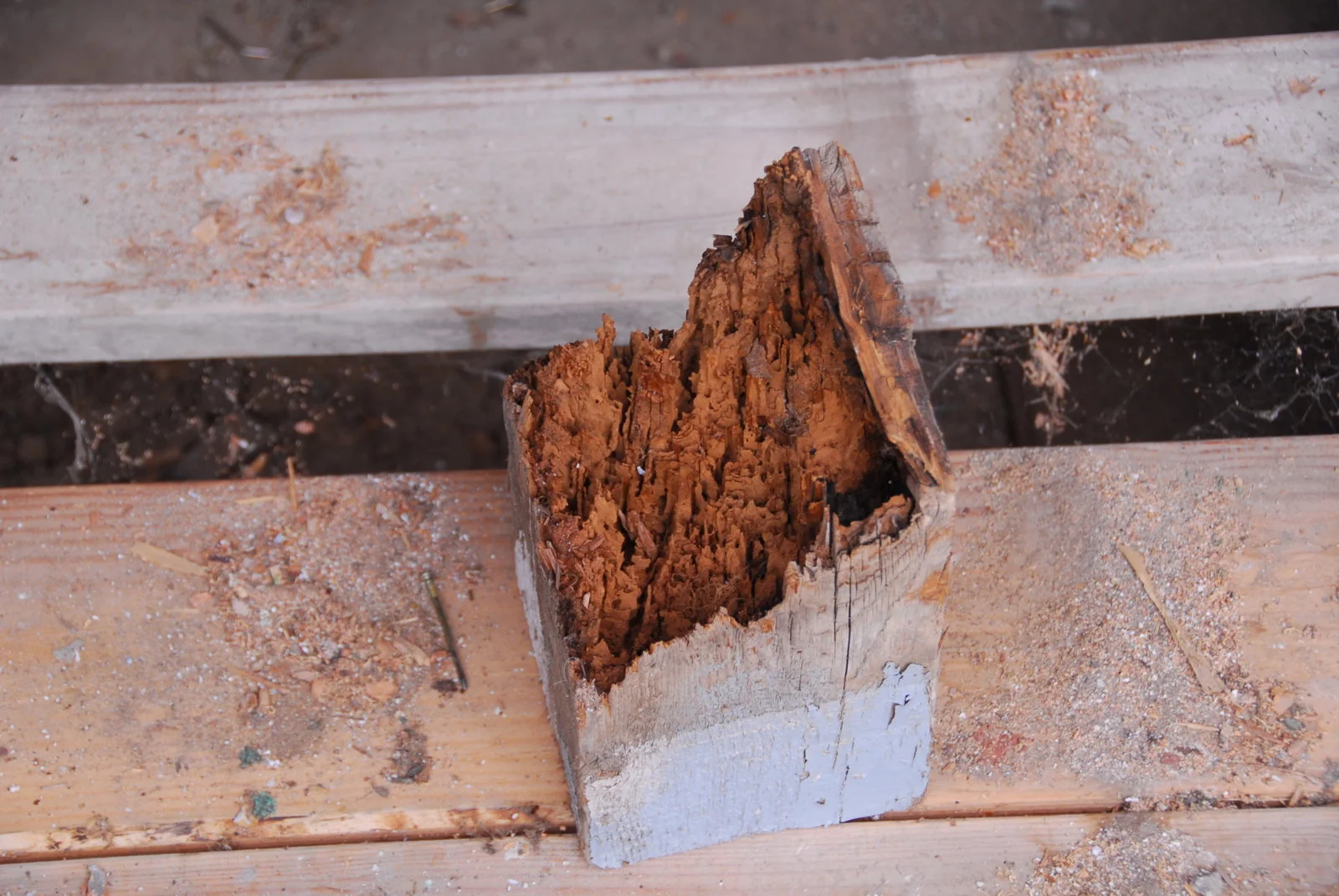

    Rotted end of post.

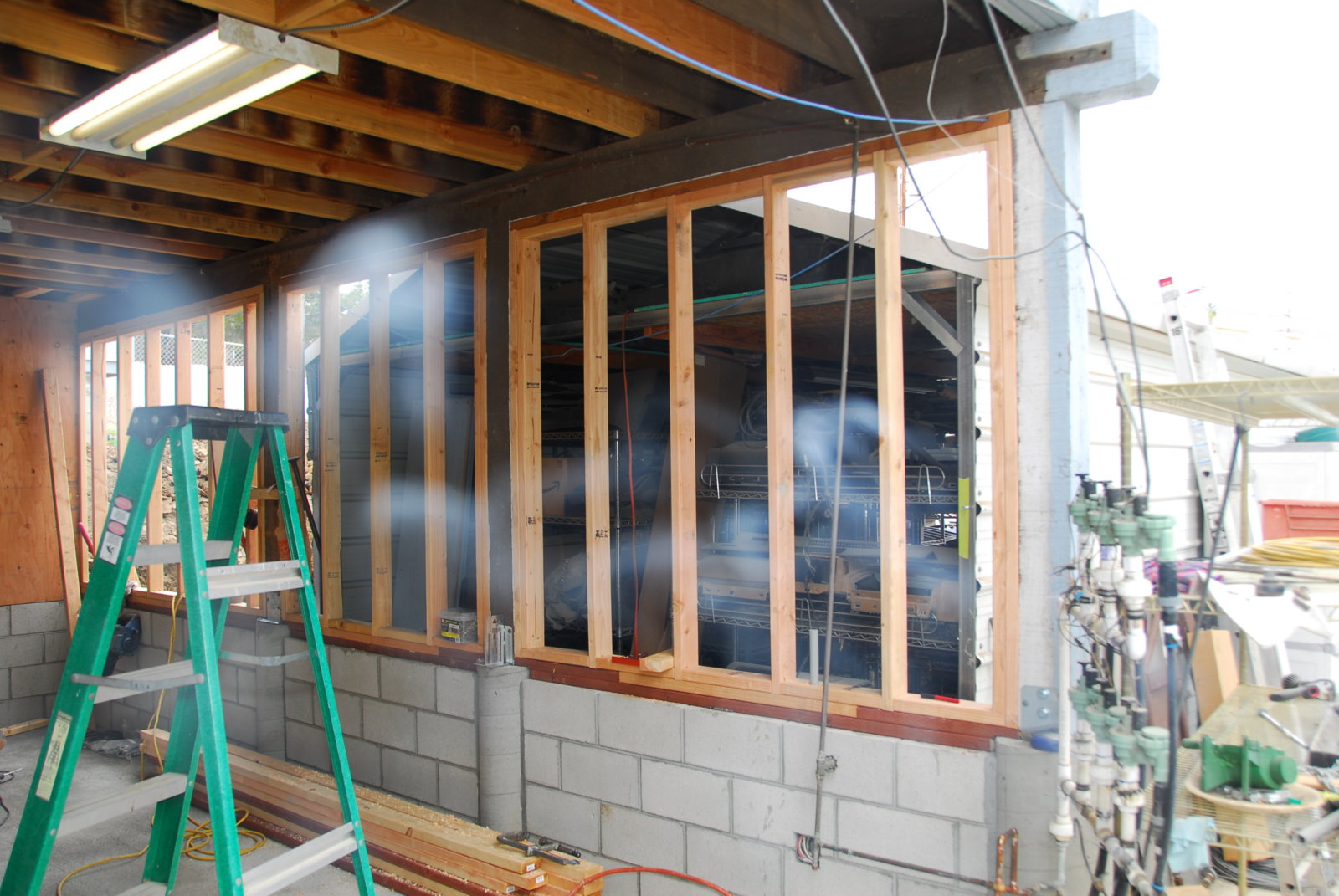

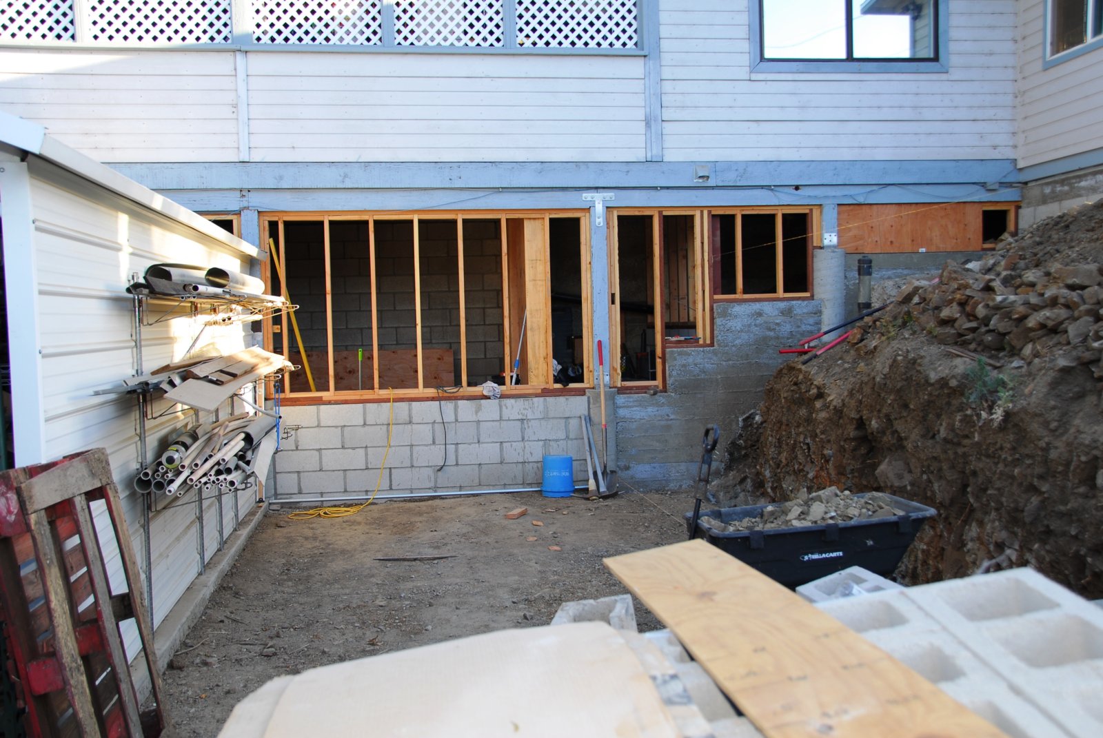

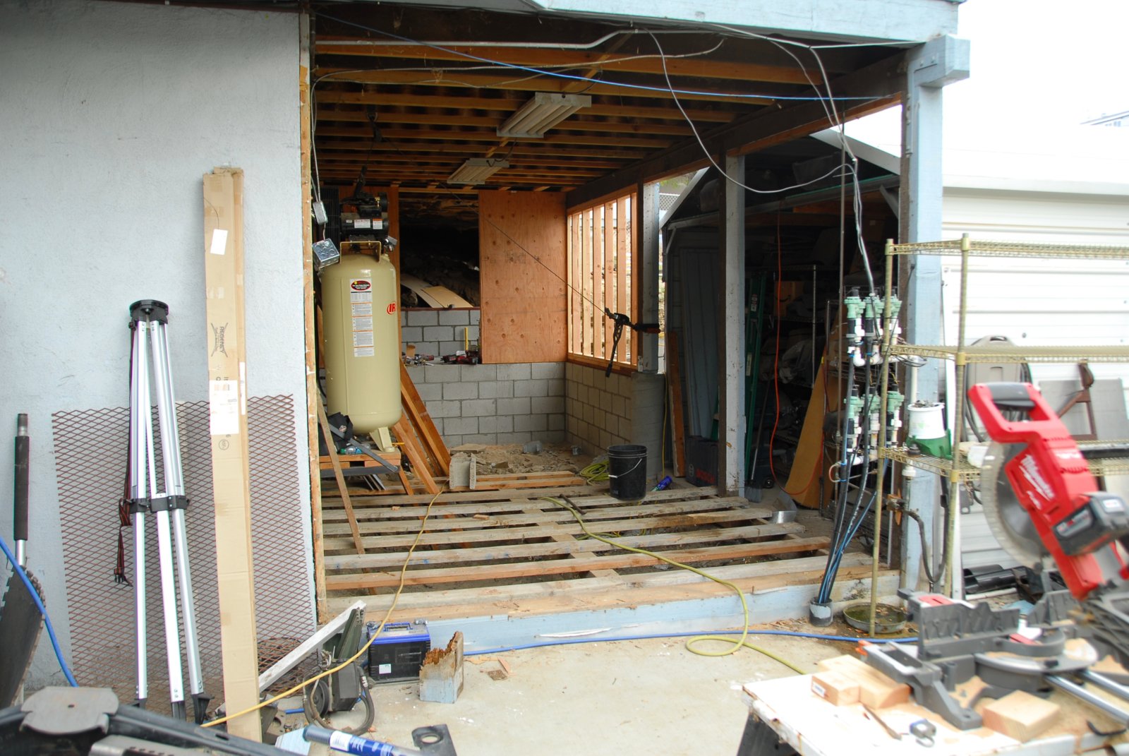

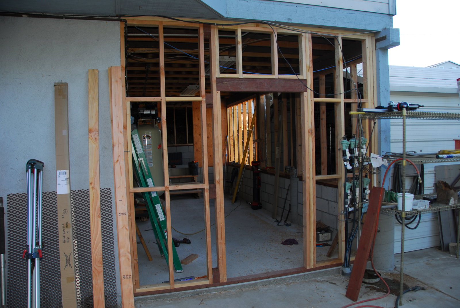

    Framing and walls in progress. Yes, that is how they built the floor. 2x6 laid flat under 5/8" plywood. I could never understand why it was spongy when I walked on it. Also, you can see the end post is buried in concrete, what you can't see is the end is about 8" below the top of concrete.
    Done with the pony walls and rough framing.
    We now have all the posts out of the dirt, up on elevated column bases by Simpson. Due to the difficulties in laying out a stepped CMU foundation, I opted to just form the two walls on the right side and do them in reinforced poured in place concrete.
    The pony walls are solid grouted #4 rebar every other course horizontally and every other cell vertically.
    DSC_4519.JPG Another reason you do stick framing is when the distance between the upper and lower areas varies and you want the wall to follow both nicely and support the upper with a lot of load.
    This entire back wall is under what was originally an open deck. Unfortunately the "builders" failed at any water mitigation and the 6x6 posts were in dirt or buried in concrete which caused them to rot and most of that outside face of the deck and laundry room sunk roughly 2".
    I designed a pony wall of sorts over an 18" x 12" footing for the low height CMU wall with round column post supports done first and then we built the short CMU wall between each column. We had to jack up the deck beams, hold it up, remove the post, dig the footing for the column, pour the column, set the post base and then cut the post to length to get rid of the rotted end, and then install the post.
    Each framed wall was a different height, each stud was a different length due to some bizarre framing shenanigans.
