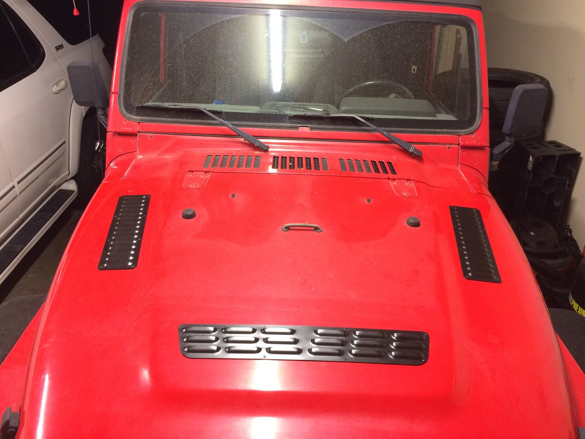

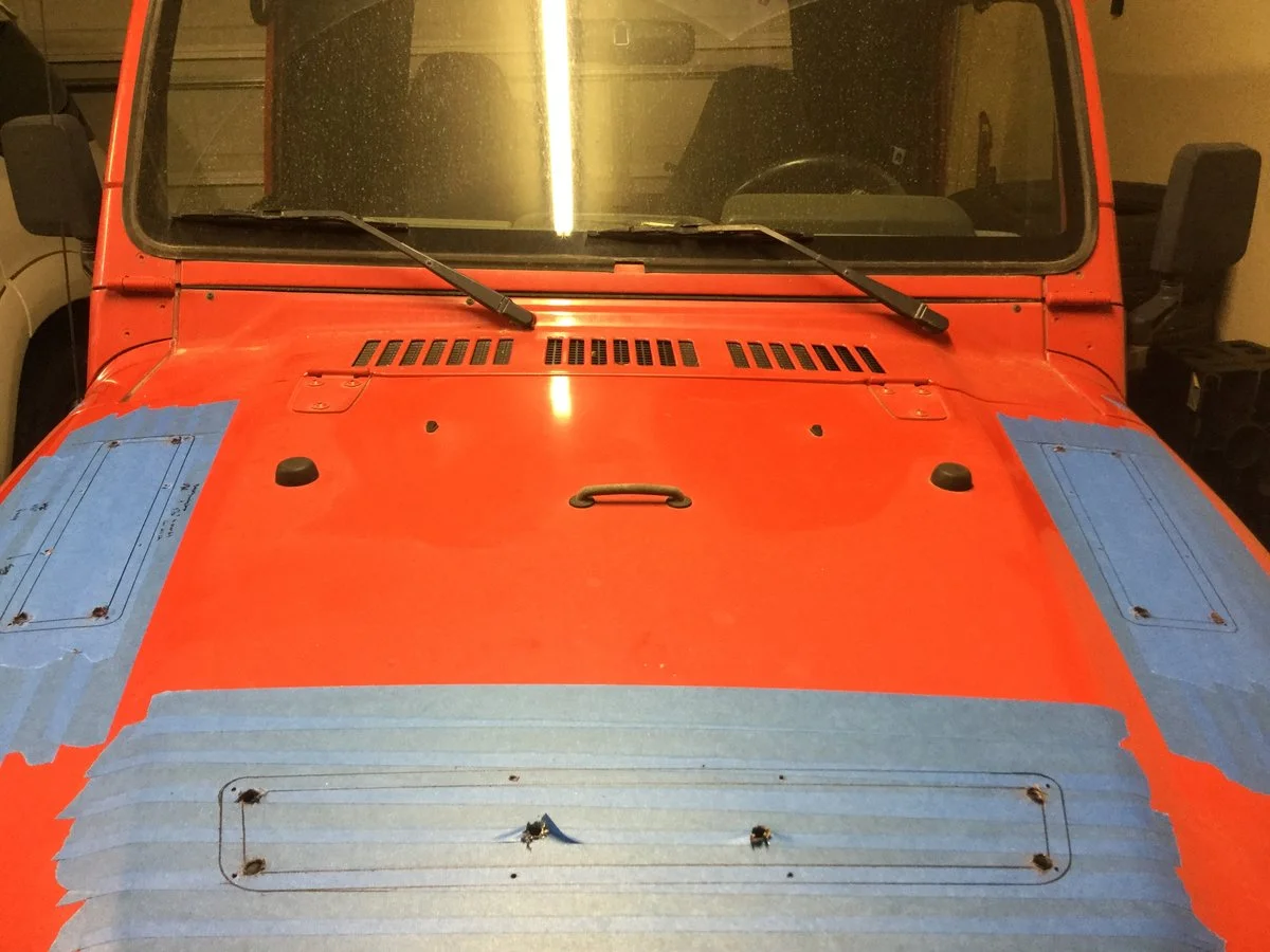

I used to run black raptor lined poison spyder louvers but changed them for brushed alu genright ones recently

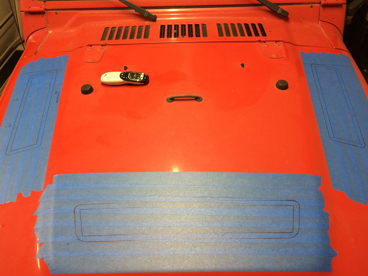

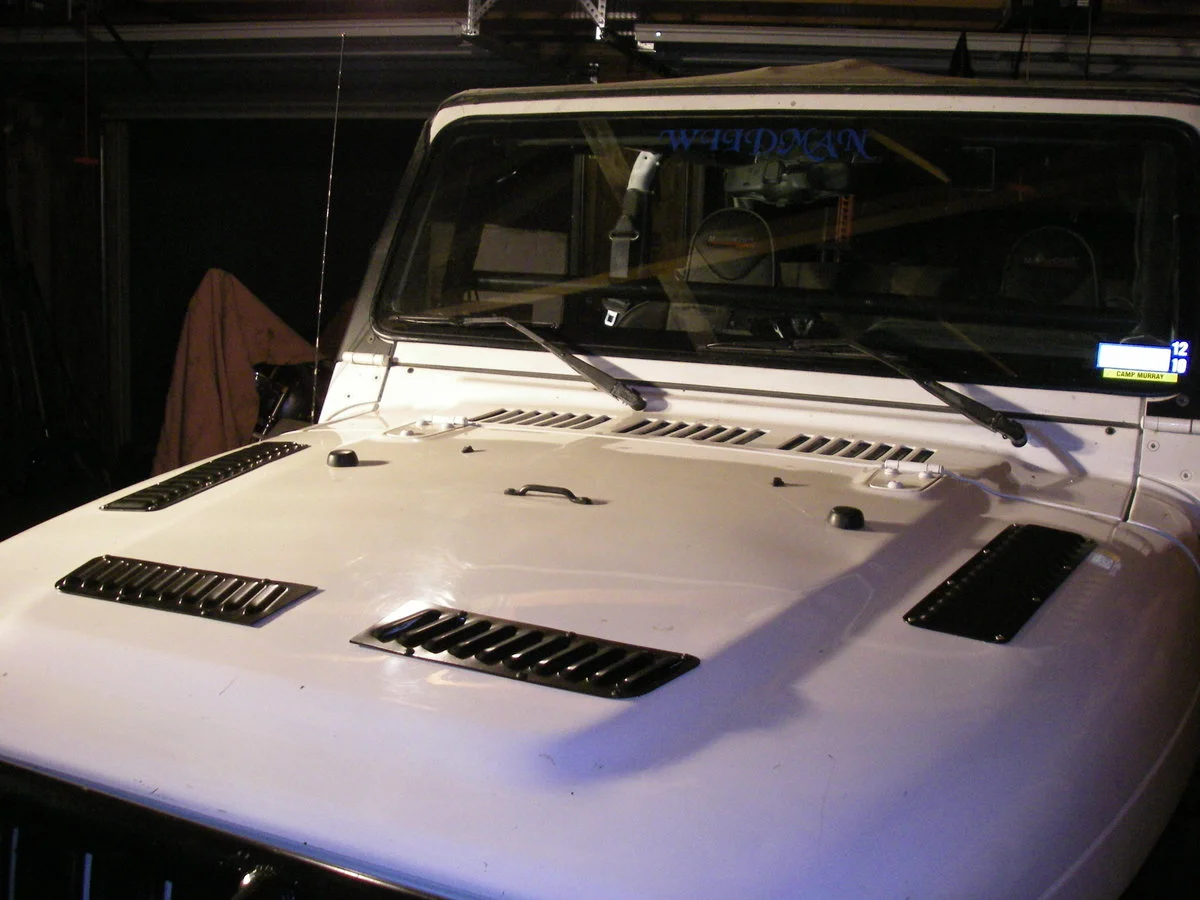

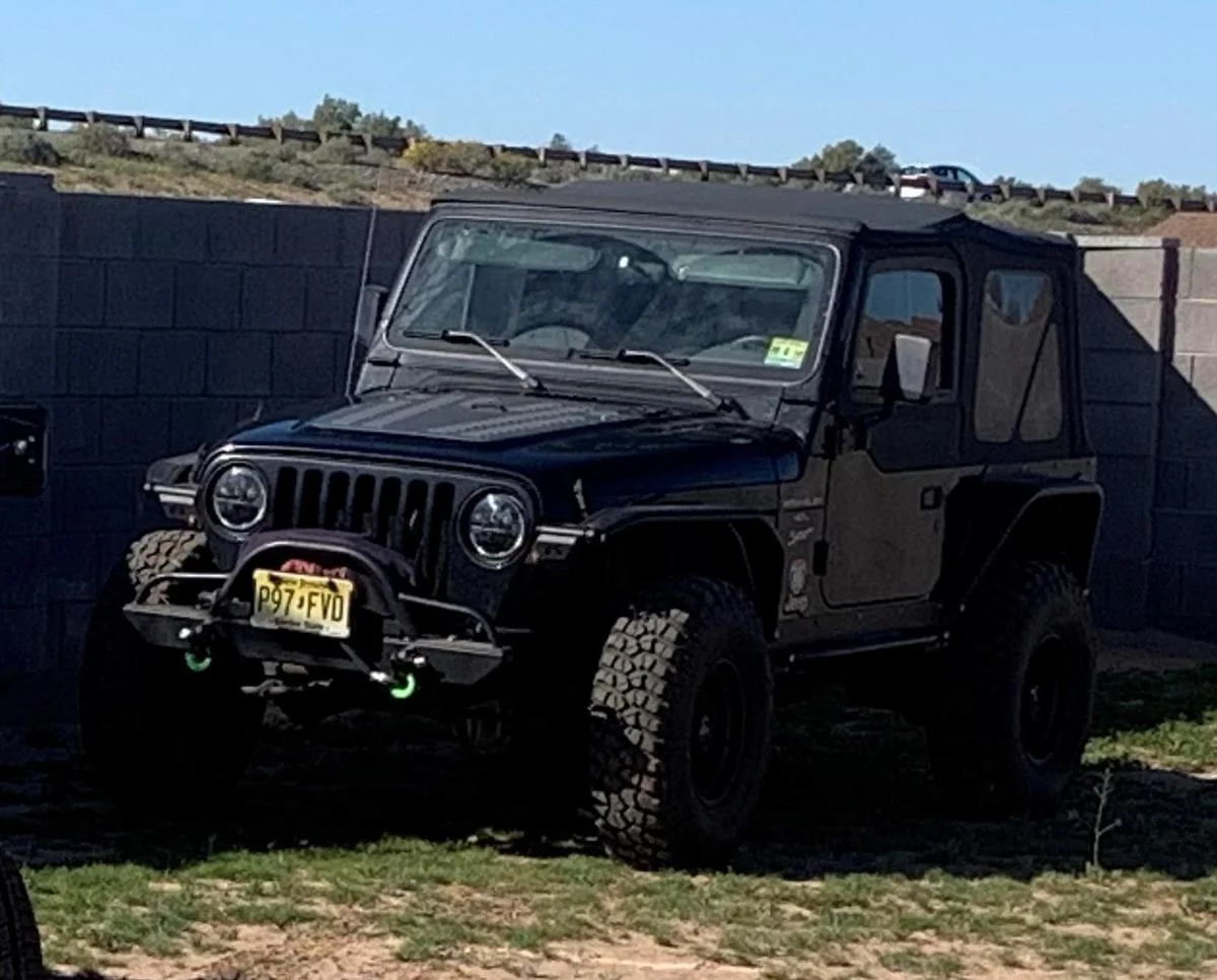

Because I have a V-8 in my TJ and had high underhood temperatures I installed GenRight hood vents on my TJ.

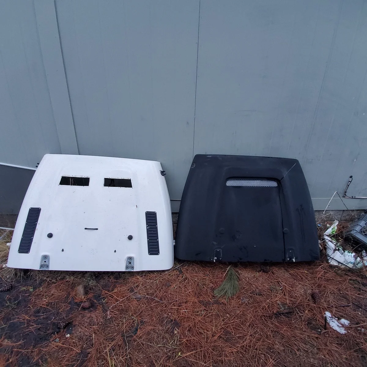

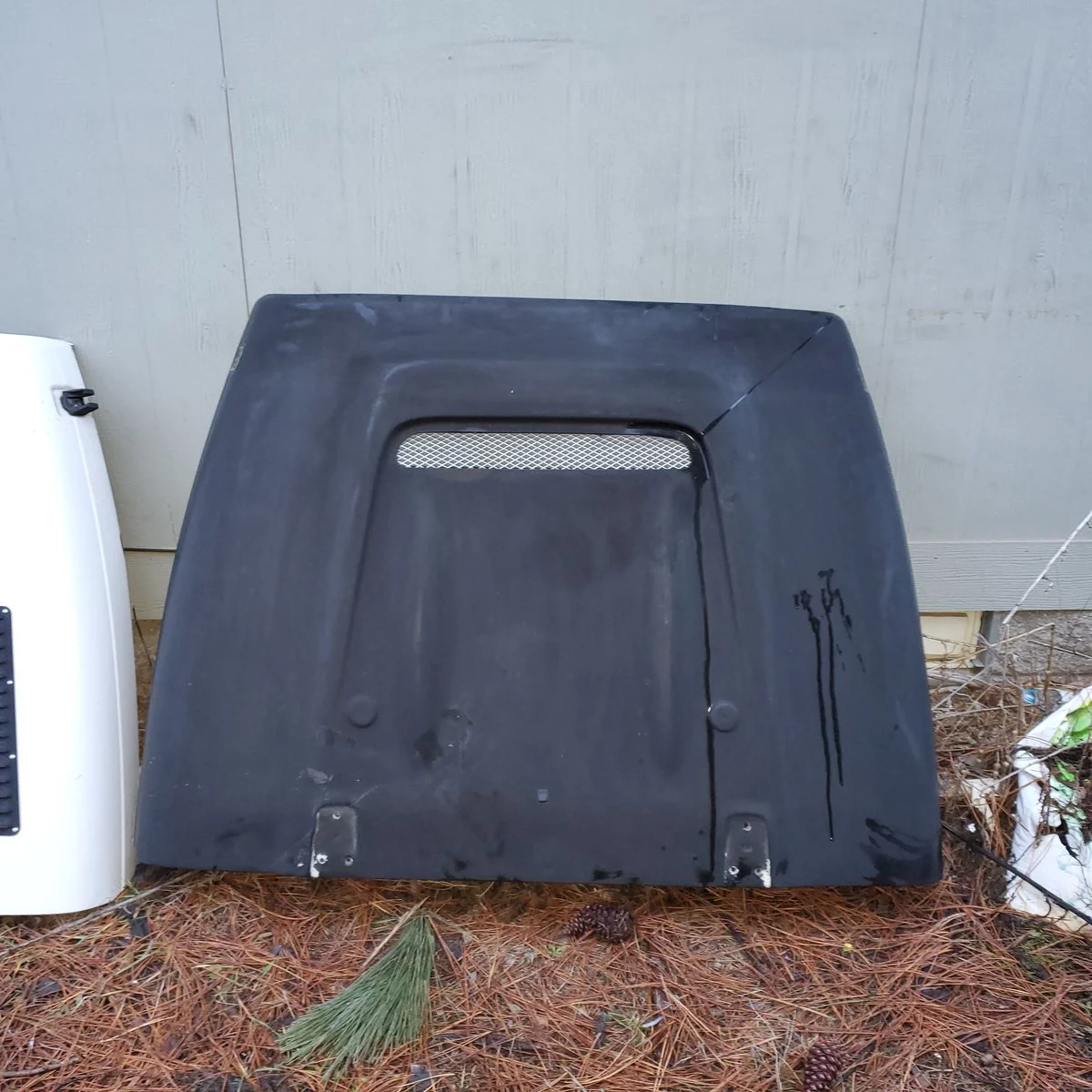

I just bought a fiberglass hood in the AEV style with the vent near the radiator.

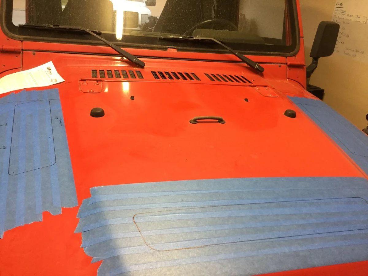

I also have one of the Poison Spyder hood vent panels that I am going to install on my daughters TJ.

Love that glass hood!

I ran the Poison Spyder one on my previous TJ. I realized that running a stainless header was causing damage to the paint on the hood. It was starting to crack and fade.
The paint on poison spyder ones started to peel off pretty quickly, Raptor liners lasted a few years but I think it heat and expansion made the edges begin to crack around the rivets. hoping I don't have these issues with he raw alu
