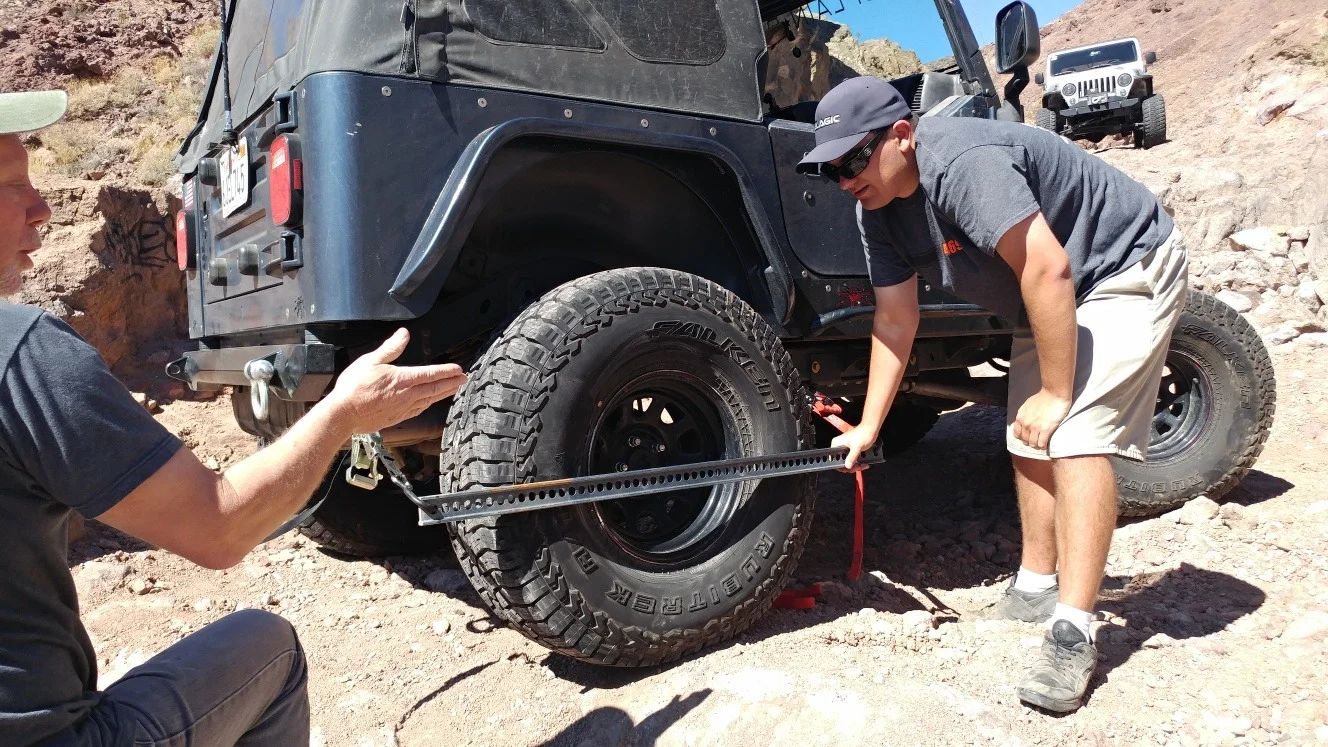

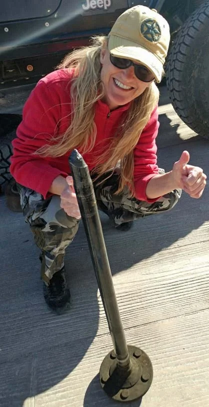

This happened to a friend's Jeep with open Dana 35 axles several months ago. We had to send someone 60 miles to pick up an axle shaft & it took several hours of work to replace it to get her ready to drive home. I was watching her when we all heard it snap, she was taking it very easy up an obstacle. The stand from a Hi-Lift was strapped to her frame to hold the tire & axle in so we could get her back to camp.

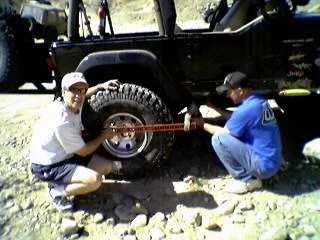

The below was my first of at least a half-dozen rigs with broken Dana 35 axle shafts I helped to get back to camp using the same jack stand method. This happened around '98 or '99. He was running 33's.

Exactly. Those who aren't concerned with breaking an axle, just having the 'fix it when it happens' attitude, must not wheel trails tough enough to see many broken Dana 35 axle shafts as I see regularly.
@Jerry Bransford I can kind of see what you are doing with the jack. Can you explain that more in case I see this on the trail. That looks like a pretty slick option, but I have never seen that done before?
You just remove the base & jack mechanism from a hi-lift jack, or use a piece of scrap wood, tree limb, etc. & use it to hold the tire/wheel assembly in when there's a busted Dana 35 axle shaft. The straps go between the stand & frame to hold the stand against the wheel to keep it from sliding outward when driving.
Here's another photo from when she broke her axle shaft.
That is clever. That is a good trail tip fix or bandaid. We should have a forum for that!
