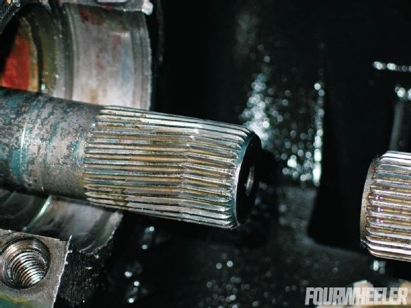

Be sure to check the axles for twisting. "Lincoln" lockers, spools, can be hard on axles when street driven. Especially if the dude was running those 40's on it.
I twisted my OE Dana 44 axle shafts with nothing but 35" tires, a locker, and my 4.0L engine. The below photo isn't of mine but shaft's twisted splines looked exactly like this.Be sure to check the axles for twisting. "Lincoln" lockers, spools, can be hard on axles when street driven. Especially if the dude was running those 40's on it.
Good call. Just remove the hub bolts (14mm), and pull them, if I recall.Be sure to check the axles for twisting. "Lincoln" lockers, spools, can be hard on axles when street driven. Especially if the dude was running those 40's on it.
