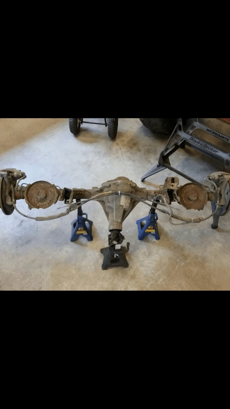

Ok, the Dana 44 gearing is 3.73, just like my Dana 30, so it’s a bolt on affair @$900. That part would be easy, excepting whatever is needed for the disc brake conversion. If I could sell the Dana 35 for $300-400 that would offset some. Then a regear front and rear with e locker in rear only would add $2350, for a grand total of $2850-2950. Tempting, as that’s only $100 more than the quote I have for a S35 and regear.

Ok, it’s official, I’m picking up a Dana 44, 3.73 gears Friday for $800. The spider gears are tact welded and so I can replace the spider gears or he’ll put the carrier in and I’ll be off. I don’t understand all this, so take me to school guys...
Nice going JMT, you just needed a little nudge from us jeep heads :)
Are you going to wait on the E locker for now and consider it later? Or install it now the axle is easy to work on?
The spider gears sit in the carrier, right?, So I’d just remove them and put a new carrier with spider gears in, right?
How would a tact welded spider gear, I.e. permanently locked rear drive on the road?
Yes those welded spider gears must go. Welding the spider gears basically gives you permanent locked axle. A rear tire would squeal every turn

Yes those welded spider gears must go. Welding the spider gears basically gives you permanent locked axle. The rear tires would squeal every turn

He is correct. This is an old school high school drags trick. Put equal power to both wheels. You may have heard of a Lincoln Locker? Not sure why they call it that.
You could leave it there, but as a daily driver you would go through tires like mad.
Unfortunately, you will probably need a new carrier, unless you can find someone parting one out on craigslist, but replacing the carrier is not super simple if you don't know how. Might be a fun way to learn.
You may consider putting your new gears and lockers in it, before putting it in your Jeep. Since this is the case.
Still a sweet deal, and you half planned on this anyway.

Unfortunately, you will probably need a new case, unless you can find someone parting one out on craigslist, but replacing the carrier is not super simple if you don't know how. Might be a fun way to learn.
The guy said he’d help me change out the carrier. His TJ has 10” of SL and he’s on 40’s.

Nice, That is a good deal, free labor and learning.
Ok, I’m understanding better now. He’s got a limited slip carrier with spider gears, so he’s going to switch out the carriers. Ok, this is looking up. I had to go reread our conversation.
So a Dana 44 with limited slip, 3.73 gears and disc brakes for $800! Bingo

Yes darn good deal. But let's say it is found that oh, d/t welded spider gears now the carrier is bad, for example... @JMT may want to have in place a " backup plan B" which would have to be a new e locker if the present carrier is bad... just sayin :)

Looks like they have figured out something while you were typing your reply, but to weld the spiders together they would have had to weld them to the carrier also, so I was already assuming it was going to have to be changed to. Regardless when he puts his locker in that would replace the carrier anyway, just the bummer waiting for the money to do so, but it sounds like the PO is going to help him out with a LS carrier.
