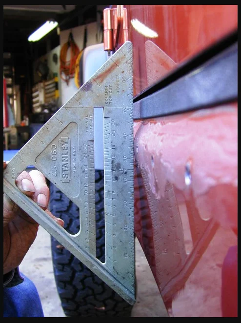

Guessing you meant did NOT? If that is true, it won't hurt anything to change that to do have now. As an example, this is the deformation caused by just removing a rock slider that had been sealed at the top with a small bead of silicone.
It sure is..but the question still lingers. How does a bolt on rock slider cause that? Get all sciencey and shit
Bull dozer bolting pattern versus aircraft fastening. The tub is thin sheet metal. Flat unsupported area like under the doors need an internal backer to spread the load out over a larger area and the fastening schedule needs to be smaller and a lot more of them.
You are correct. What do you recommend to straighten it? I’m thinking of reinstalling without the lower bolts , then jacking up on the tube step.
