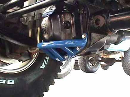

General question re diff covers:
During the CJ/YJ era differential guards were widely in use. Aftermarket diff covers not so much. One of the most popular differential guards was the hockey mask style marketed by Mike Duncan at 4XDoctor in Burbank CA. I had one on the Dana 30 in my CJ-7, also the AMC 20 rear axle.
I don't see those on TJ's. Have they simply lost favor or is there some other reason? I would think that these would solve the issue of damaging the cover without raising the issue of interference with the tie rod or track bar.
My first thought is that those are as goofy looking as the Barnett is. (I mean that in the best way possible) Assuming they work well, the hockey mask probably fell into a niche market of functional products after the brodozer aesthetic took over the industry.
Ive always liked diff skids.
I personally like the warm industries one and the old school poison spyder customs one.

I would rather add a guard in front of the dif cover than change it. The manufacturer spent lots of time and money to design the cover to work for that axle. Do you think most aftermarket manufacturers spent that much money and that much resources into making sure every aspect of it works perfectly with that differential.
The only problem with factory differentials are sometimes the get hit and bent.
Reactions: jjvw
You're also making an argument for the Barnett. :)
