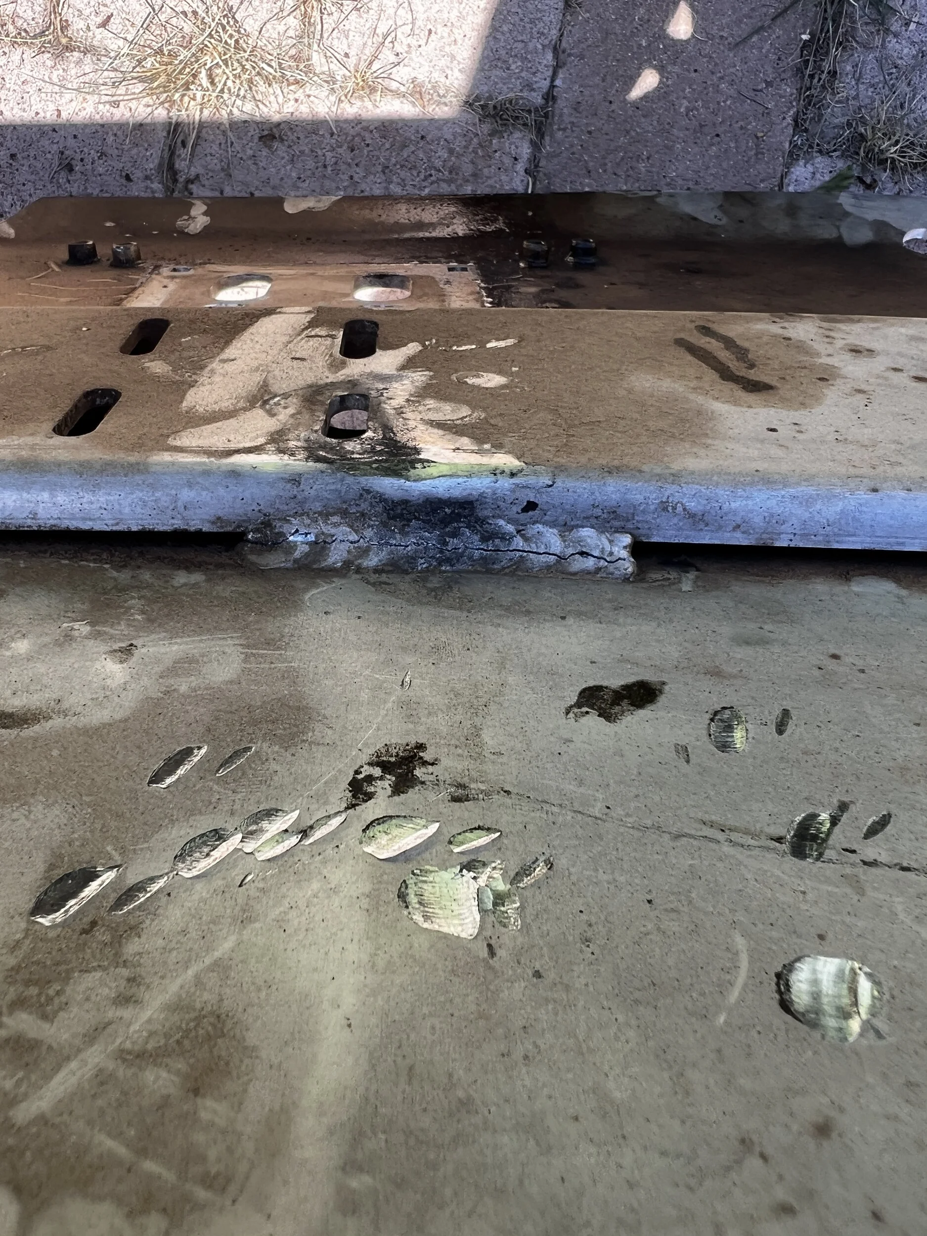

Yes. I just dropped the skid to bend it back and lowered it down to check. All there. Only funny business I see is that my mopar trans mount seems pretty pliable but not cracked and it’s only a few years old.
Anything else I should check that could cause a shudder while Ive got the skid dropped?
Skid won't matter but channeling my inner Jerry have you checked the transmission fluid? Could it be a torque converter stutter?

The only thing that makes me think no on the torque converter is that it’s only from a dead stop. If I floor it at any other time it’s fine.

If the transfer case is raised from the cross member bending the pinion angle might need to be a changed.
So it's only happening in first gear under hard acceleration off idle.
Have you checked first gear but already moving or have you been in a higher gear?
Yeah already moving everything is great.
Pinion angle is next on the list to check.
Reactions: Apparition
This is why UCF skids aren’t designed well. Skid bends on rock. Go to hammer it straight and now the welds are cracking on the crossmember.
I stopped hammering on the skid to avoid cracking welds any more but an independent crossmember is now on the list…
Just buttoned it all back up and my pinion is 2.7* lower than the driveshaft angle because of the bend in the skid. That could definitely be my issue. I will report back
This is why UCF skids aren’t designed well. Skid bends on rock. Go to hammer it straight and now the welds are cracking on the crossmember. View attachment 524951
1/4" or 3/8" and how much drop? I bent my UCF 1/4" aluminum skid with 2.5" drop last year (they call it the "no body lift skid"). I went with a Genright crossmember and 3/8" aluminum UCF DIY skid with 1" drop after that. With that skid/X-member set up and a Savvy BL, I was able to fit an Atlas 2-speed. I didn't try to bend the old skid back for the reason you showed.
Reactions: starkey480
The highest one in 1/4”.
Reactions: Woodrow
The bent belly skid really highlights the need for a rear stiffener as is on the Savvy version. It sucks that they’re not available for early model TJs. Are you able to salvage your existing skid or is it kaput?
And there you have the answer .. steel designs just don't translate well to Aluminium if simply just copied over.
Yep. I've considered bolting a piece (or 2) of angle iron on the inside of the UCF skids.
